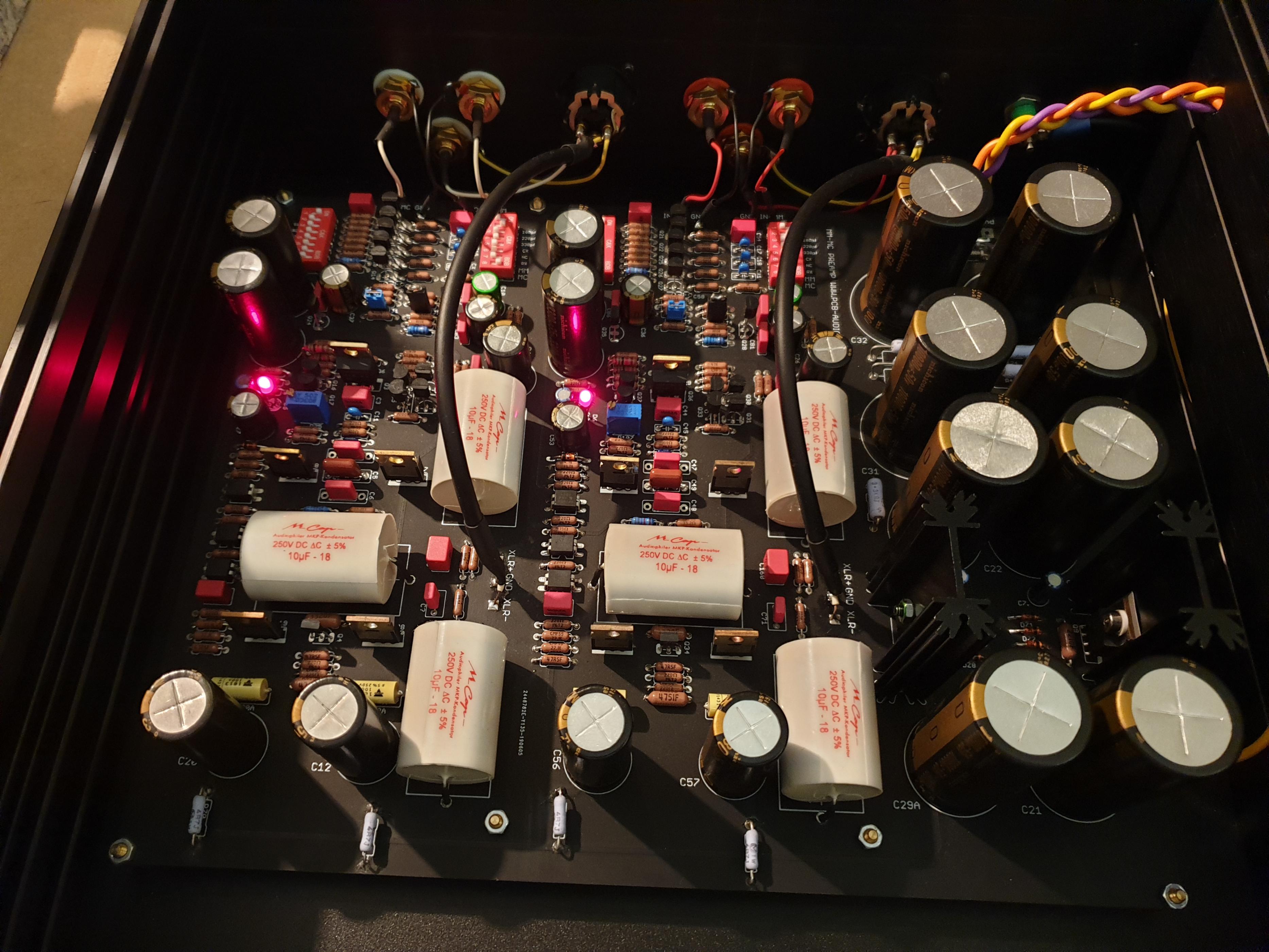

I'm going to build a Pass XOno.
I hope so, I haven't done a big mistake, when I chose BC parts, what I have.
I have built it on Ralph Stens' boards, these boards accepts the BC parts without modification.
The board I have is modern but it´s configured for those old transistors (2SA / 2CS)
Now that I have Wayne's confirmation, possibly in a few days I will have it ready for the first tests. 😉😉😉
Taking advantage of the thread, I have read that there were some problems with the value of R5. Should I take it to the ground like in Pearl II or should I simply change the value depending on the Led?
Thanks.

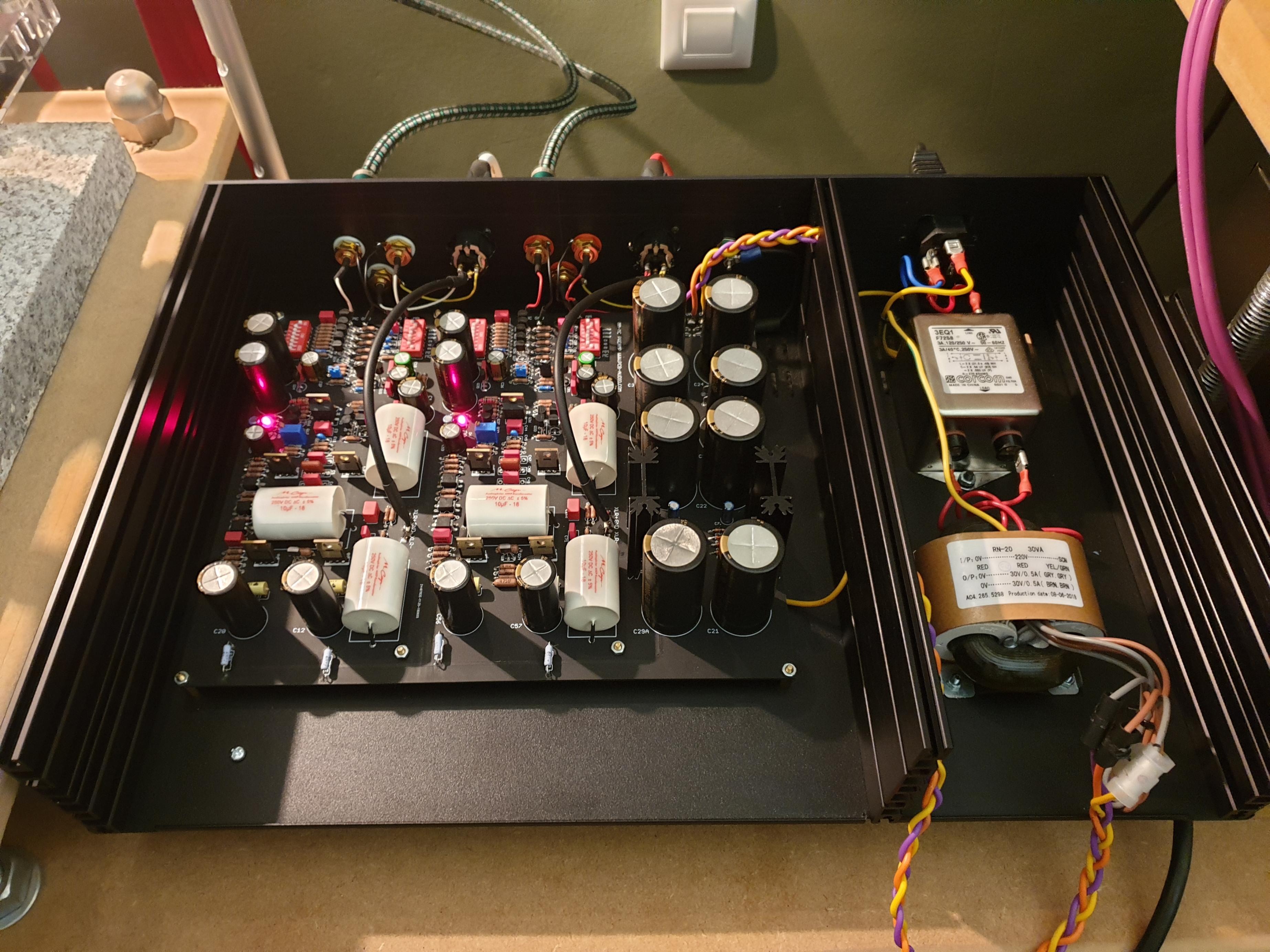

I´m doing the last adjustments in my Ono/Xono clone. I still have work on the AC wiring part.
As usual in my amps/preamps with one chasis I used an internal partition to separate trafo and preamp.
Although I haven´t noises, perhaps I should have opted for a separate chassis. 😕😕
I´m still on time since I have not machined the front and mechanized a new floor is not a problem for me.
