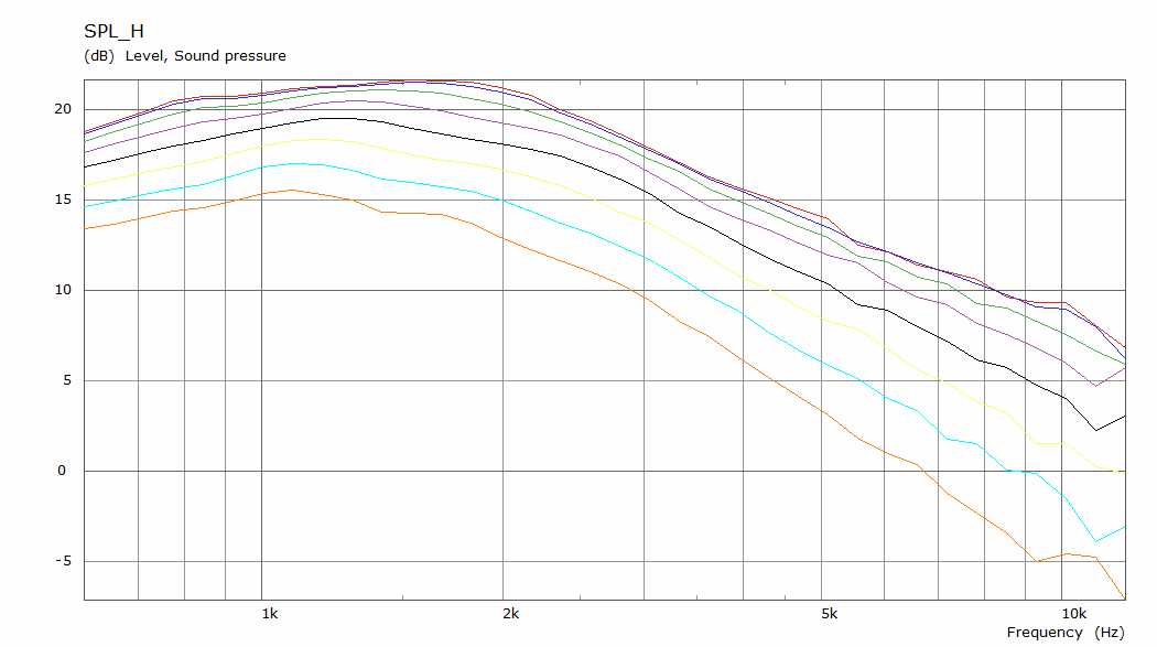

"Try vituixCad diffraction sim, it takes only few minutes to find answers all questions you can ask..."

... Try vituixCad diffraction sim, it takes only few minutes to find answers all questions you can ask 🙂
I will try that, thanks. It never occured me to try it.

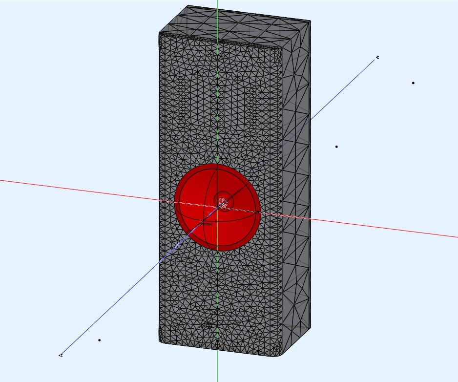

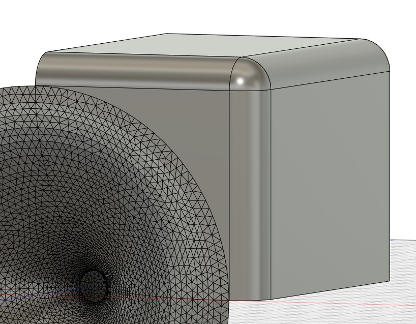

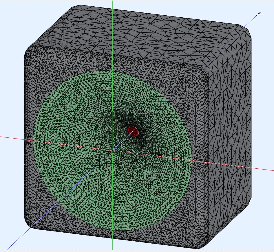

Can someone tell me what happens if you add large round corners on a large horn speaker, such as the Klipsch or Calampos with 15 + horn?
Say a 17.5" wide enclosure for our example. And the roundover corners say a full 4" ?
I'd prefer knowing what to expect, over the time it would take for me to sand pink foam into the corners and temporarily attach them. That is time intensive.

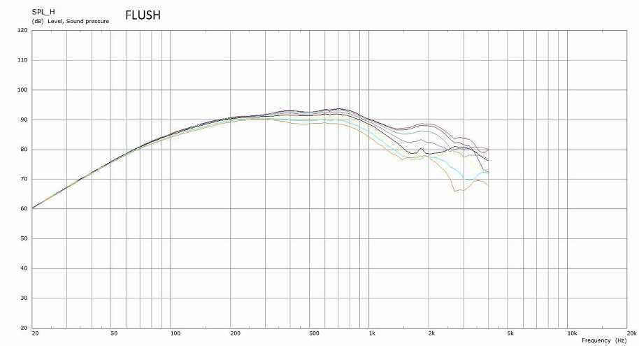

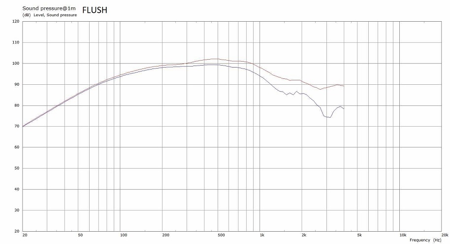

Putting large roundovers on any cabinet will reduce the effects of edge diffraction. This is still true when waveguides or horns are used but the effect is more subtle as less energy is sent to the edges due to the pattern control of the guide.
Building a chamfer or roundover right next to the horn mouth helps to reduce reflections that travel back down the horn from the mouth.
Earl Geddes speakers are a very good example of this where the waveguide blends in the baffle and roundovers to make the transition as smooth as possible.

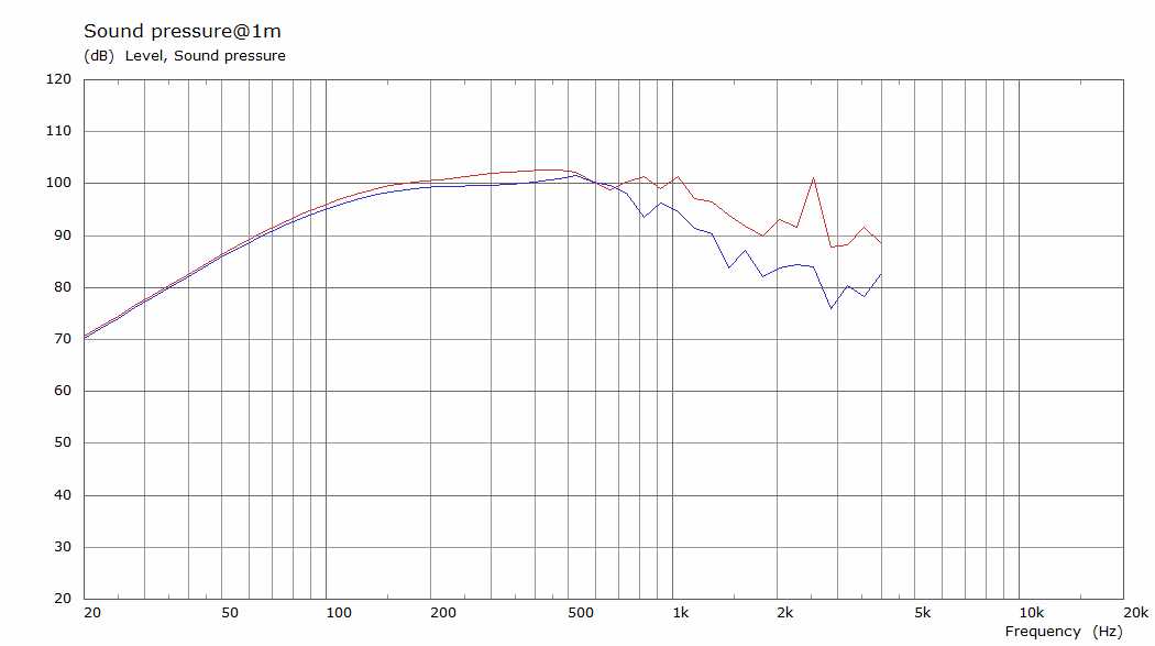

Smoothness of the off axis curves and power response is one of the most important factors in speakers rating highly in double blind testing from Floyd Toole and Harman. When you are aiming for that goal it seems silly to not worry about diffraction.
Puppet, small or large baffle moves the same phenomenon up or down in frequency. All frequencies above the transition to 4pi radiation will diffract, roughly the frequencies that have smaller wavelength than the baffle.
But as you say the driver starts to beam at some point and doesnt radiate sound along the baffle and there is no diffraction problem frequensies above that. Now we have a bandwidth of wavelenghts that can diffract at the edge and those are roughly between the baffle size and transducer size. From this a simplified easy to remember rule of thumb is: minimize the flat baffle area around all transducers and diffraction is minimized. Be it narrow baffle without roundovers or wider with roundovers or slants.
Think a typical two way bookshelf speaker, rectangular baffle where a woofer fits. The woofer wont have any diffraction problems but the tweeter has loads of baffle around it and there is going to be diffraction on the tweeter passband, unless the baffle was slanted or what ever, waveguide. One could widen the baffle to fit huge roundovers, but there is going to be some diffraction interference still, but in lower frequency than with narrow baffle would have in similar scaled down situation. Tried to demonstrate this few pages back and on some other threads few months ago https://www.diyaudio.com/forums/multi-way/374497-im-building-4000-speaker-kit-57.html#post6744241
Huge roundovers have a bit less diffraction interference than minimal narrow baffle without, but are much harder to build.

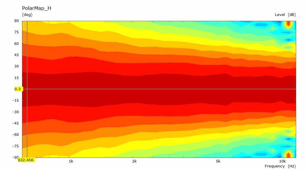

The lowest diffraction result I can get in simulation from a baffled waveguide comes from having as smooth a mouth transition to the most minimal baffle straight into a roundover on all edges.
Fluid, and it makes sense, that is the right way to do it if waveguide is on a baffle. Very good results. The freestanding waveguides with roundovers perform a bit better still but there are reasons to include waveguide into a baffle. Many of you already know all this, but there are plenty who havent thought about it yet 🙂

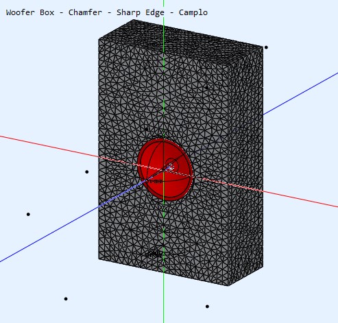

In most cases where I added a large round-over / chamfer to a baffle I could hear an improvement (less colouration)
You can try it on your existing speakers; cut a 25-50mm wide cardboard strip and attach to the edges of the cabinet with 45 degree angle with bit of tape to hold it on.
