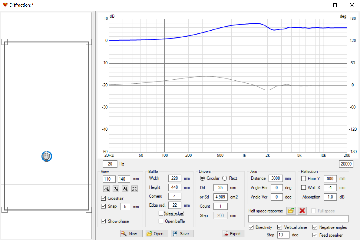

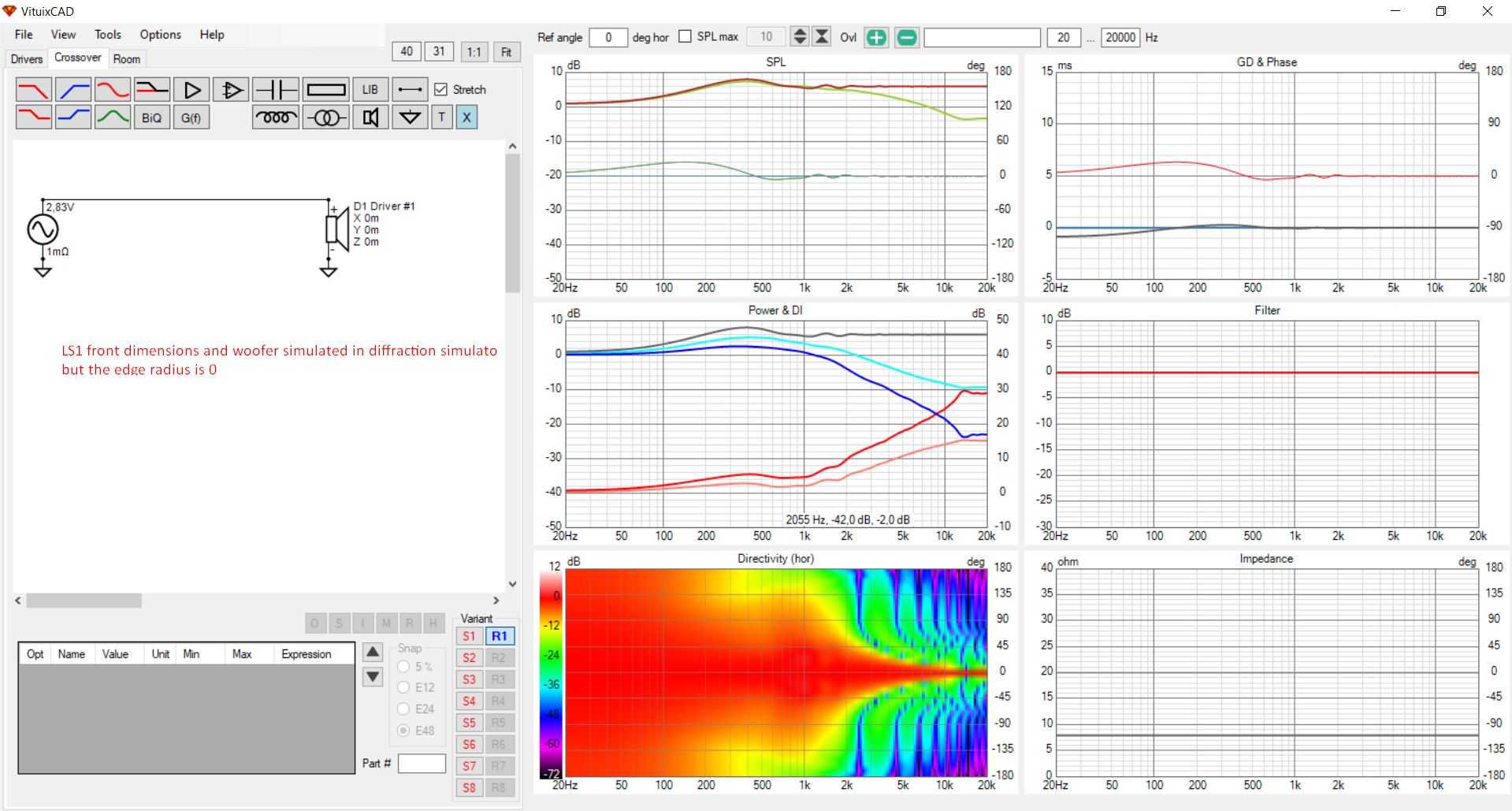

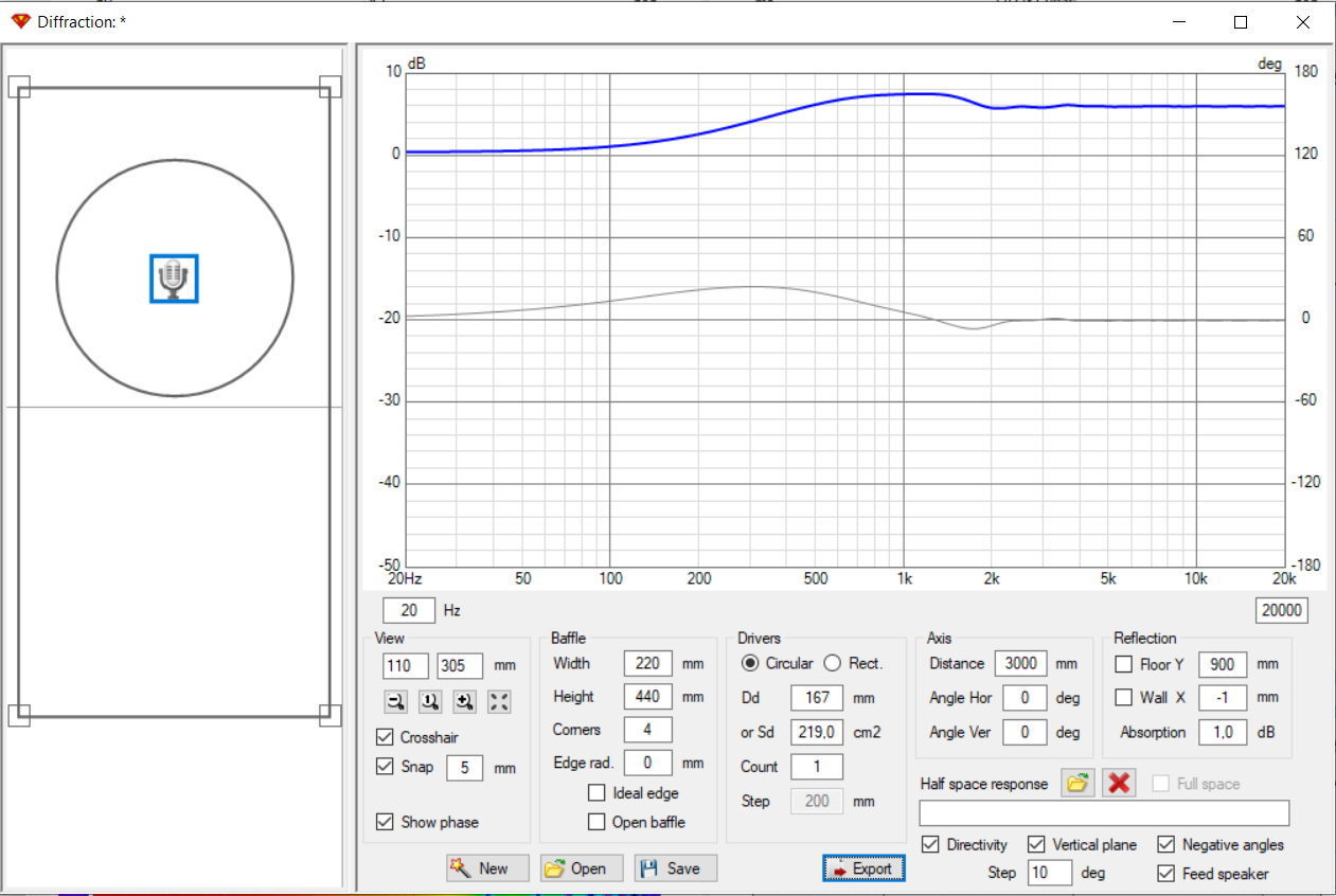

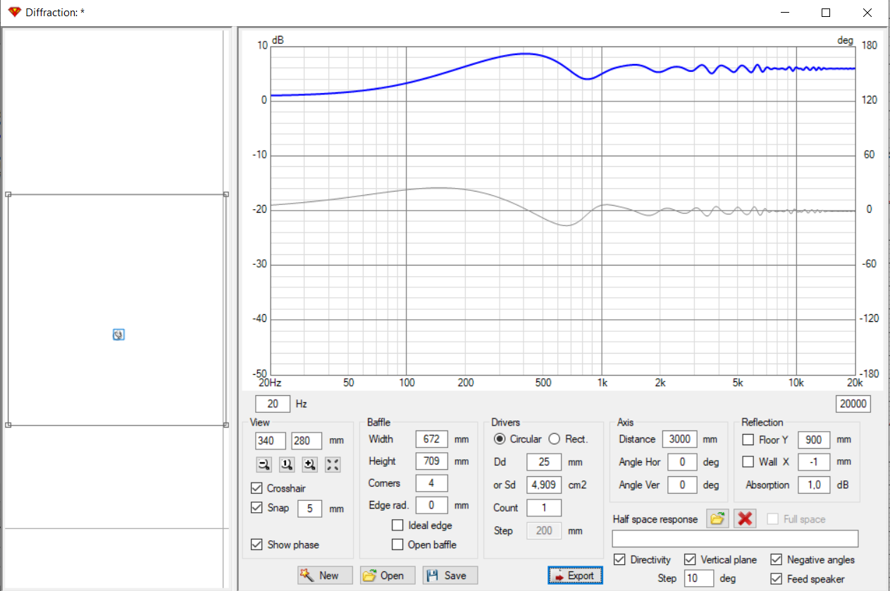

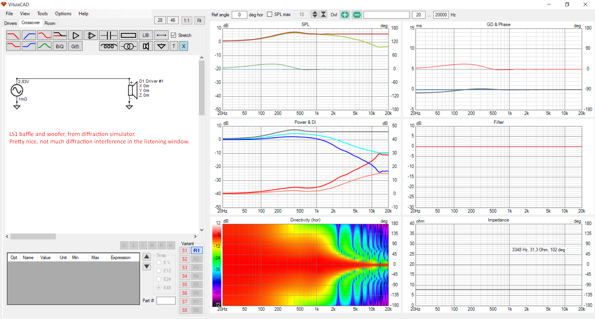

I've got to eat some of my words instead of popcorn 😀

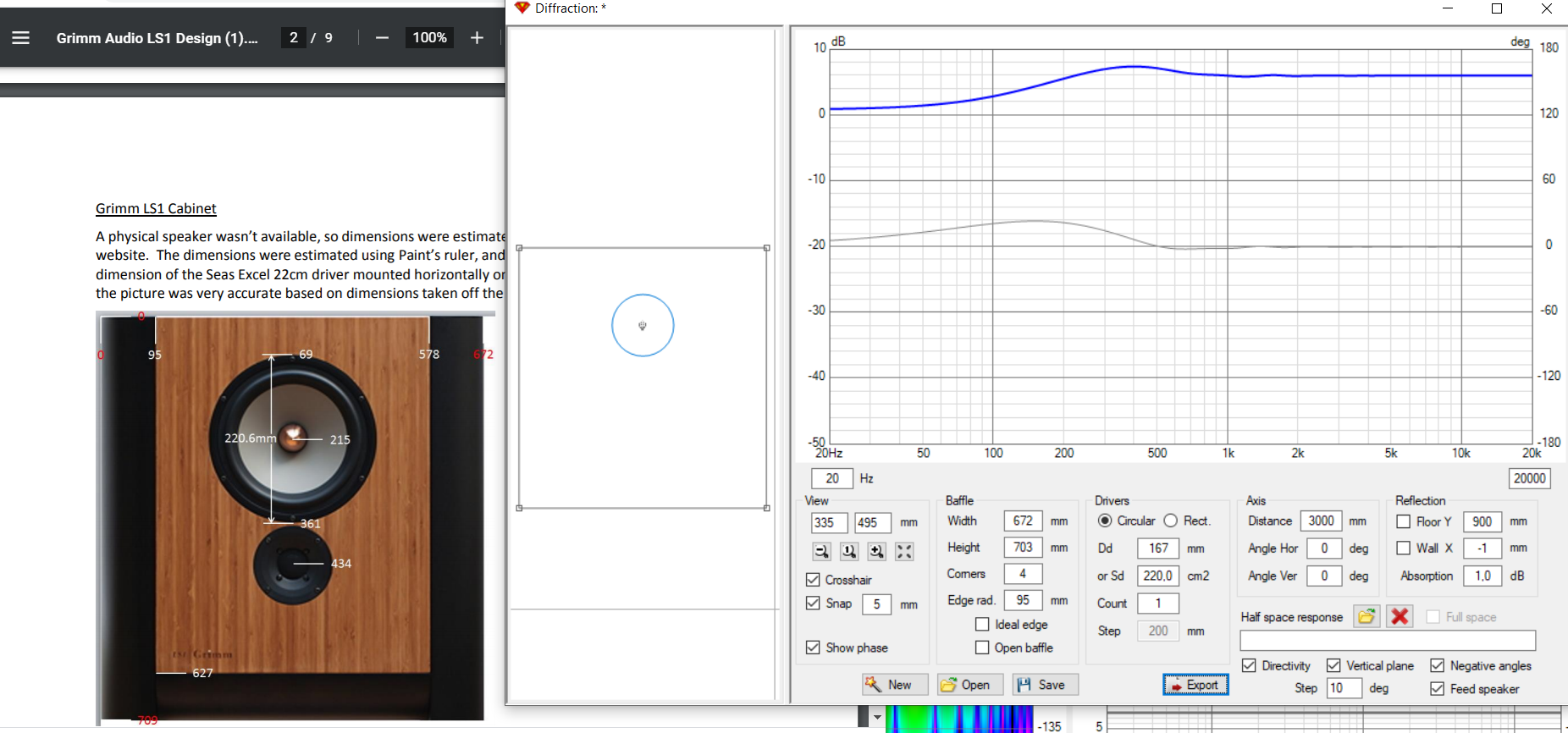

Attached some vituixCAD diffraction sim photos which say my words about roundovers being just about minimizing the flat front misleading since the roundovers help with the directivity lower in frequency than anticipated as well. Any roundover seem to help altough larger roundovers and big enclosures are a lot harder to manufacture than simple small square boxes.
The directivity changes with large baffle which should be advantageous. Actually the grim baffle seems to show almost constant directivity between about 300-1kHz and constant directivity is the thing.
Tree baffles simmed, the grimm ls1 dimensions are found from the PDF I posted earlier. One sim is with roundovers, one without and third one is kind of minimal square front for 8" twoway without any roundovers. Mind that the roundover is on all sides in the sim where as LS1 has roundovers on the sides only so there is some error. Also I'm not sure how the sim handles depth so this is kind of indicative stuff, not too scientific. Driver is ideal driver so flat frequency response all the way.

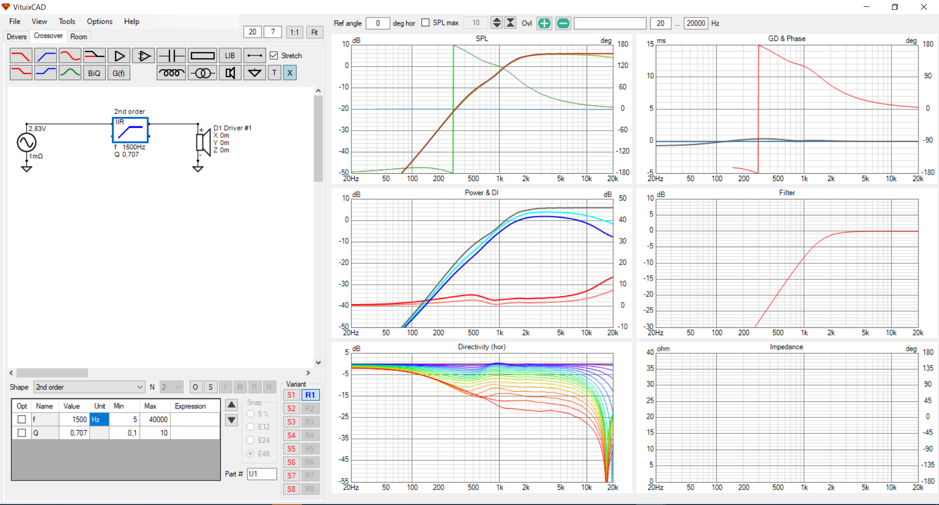

First attachment is a gif rolling around the three sims. Then the diffraction tool settings and the images used in the gif.

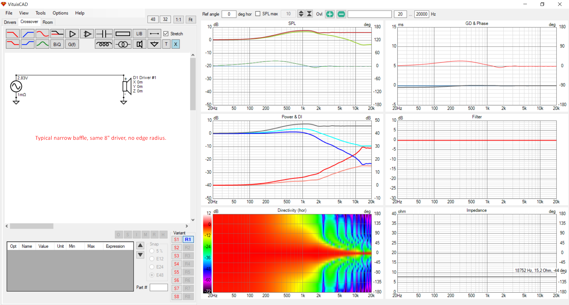

Note that the narrow baffle without any radius has almost as smooth diffraction interference as the wide baffle with huge roundovers. Main difference is that the wide baffle controls directivity to low frequency.
The LS1 have an interessant feature: the bsc have it's -3db frequency located around 220/250hz.
A 4" radius roundover see it's effect loosing control under 1khz.
Bsc and edge diffraction are the same phenomenon but at different frequency.
By this choice of baffle width/roundover radius both artefacts are treated continously: edge diffraction control take effect where bsc compensation stop ( almost) and vice versa ( bsc span 4 octave ( 2 both side 60hz/1khz) with center freq 250hz and edge diffraction control by roundover start at 1khz).
I don't know if it matters but i don't trust in coincidence too much...

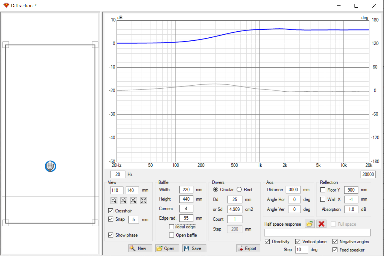

Yeah here is the tweeter, edge radius 0 and the LS1 95mm radius. Diffraction interference is still seen below about 1kHz on the polar graph. Added low pass filter to mimic the real one a bit closer (instead of playing all the way down to 20Hz).
Check out the non edge radius (second attachment) polar graph, pretty much diffraction related interference all the way from the baffle width to the driver diameter! This led to my rule of thumb, when driver diameter and baffle size get closer to each other, eg. baffle is the same size as the driver the ripple (bandwidth) goes to minimum. In this particular case the baffle is wider than the bandwidth of the tweeter. Hence, with roundovers tweeter has pretty much flat response with wide baffle as well.

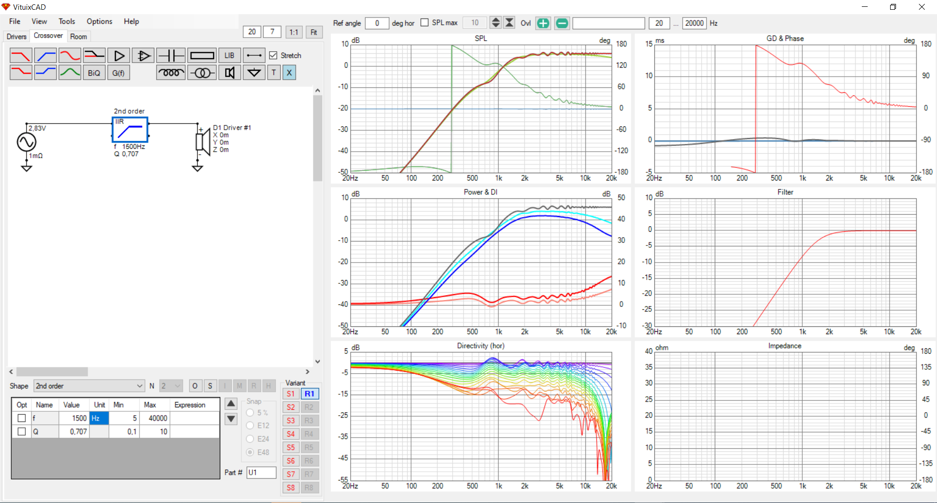

And one more, this is the "narrow baffle" from few posts before but now with a 1" tweeter instead of 8" woofer. If the baffle is as wide as the woofer, the direct radiating tweeter on same baffle gets pretty nasty diffraction interference. Attachments have roundovers 0, 22mm, 45mm and 95mm. This supported my minimize flat baffle thinking and the trapedzoid baffle fluid mentioned earlier today. Every driver seem to benefit from minimum baffle around it, or big enough roundovers. 10cm (4") radius roundovers seem to be good to about 1kHz but have some effect below it.

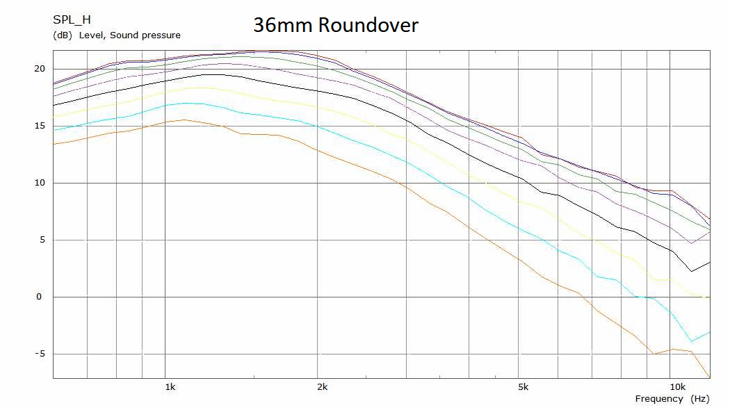

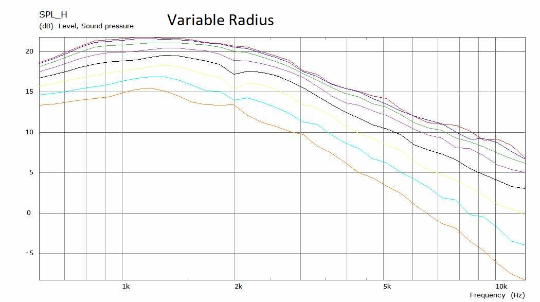

Here is an example of the difference between a variable radius roundover and a plain 36mm one. Hard to know if one is better rather than just different.

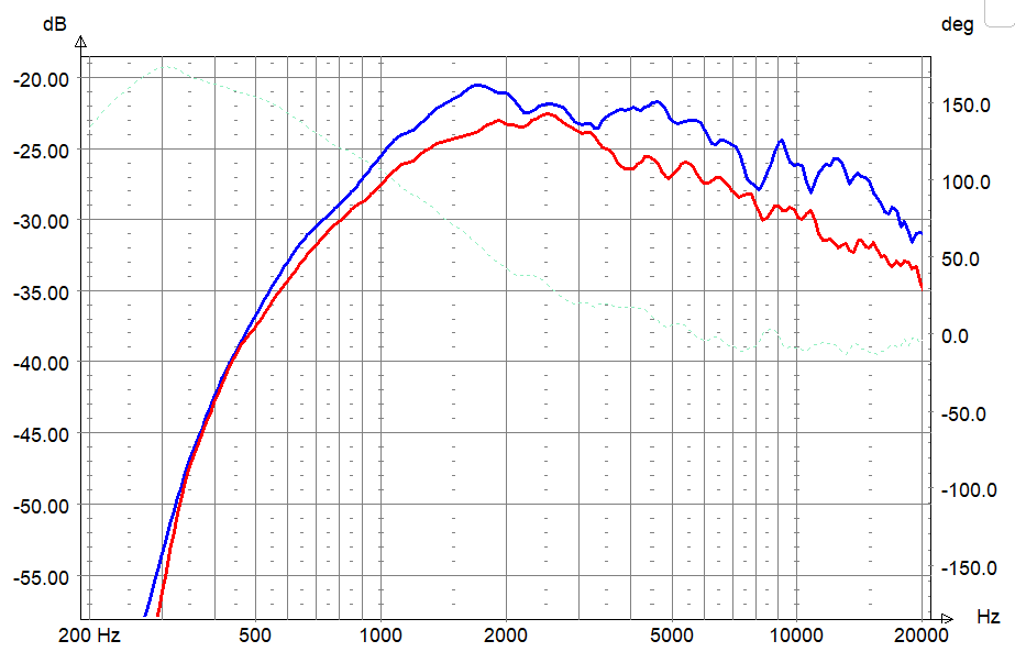

I'll post some measurements this evening, when i come home, of 7" midwoofer in a square cabinet with quasi-anechoic response good down to 100Hz or a bit lower.
Ok please do.

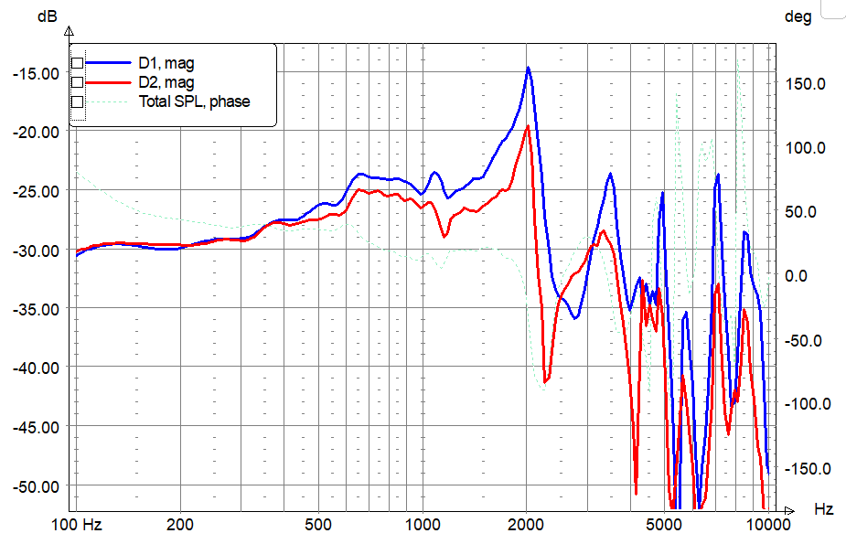

Measurements i promised. 0 and 45 degrees.
