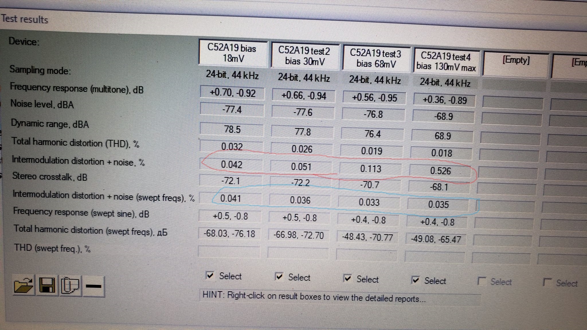

Was playing with just bare output c5200/a1943, and slowly increasing current. Measured the distortion using RightMark audio test. Distortion, thd and im was going down with increasing bias, as expected. But the IM distortion with sweep was going up. Any idea why?

bare output - made by Il Penitente schematic?
what is Rout of signal generator?
power level you're testing at?
edit: I can bet that - if you include source resistors for IRF mosfets, IM should go down, control of output BJTs being tighter
my choice is going without them, getting more uniform THD Spectra and it sounds better to my ears that way
remember, even if max power is sorta fair (25W) , this is still no NFB amp, more made as THD generator than clean instrumentation amp

no, not exactly your Il Penitente. Just a bare bones output.
I am using line out from fucusrite. You got a good point, perhaps I should try headphone output, that sure has lower Rout.
Tested at low power, ~0.5watt, with speaker connected as load. I do not like it loud.
No mosfet drivers.
Yes, yes, no NFB.
What I do not understand it that there are two ways measured IM, by one its decreasing, as it should, by other its creeping up.
But its not your circuit, so no worries, do not bother about it. I am just trying to understand it.
I am heading towards three pairs of outputs, no NFB, 0.5A each pair for 1.5A total. Kinda like JungSon.

just think about Beta
can't really do anything without proper drive
if you calc Beta as optimistic 100x, means that 1A5 of Iq demands hefty (Iq) 15mA of base current - you need to get it from somewhere and you'll certainly not get it from Focusrite in dynamic regime
