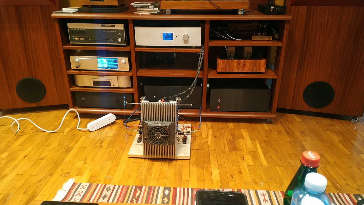

visited today my OSSoE (Official Second Set of Ears)
he said - after smaaaaaaalll Rakija and biiiiiiiiiiig amount of Tea, and some listening while chatting, and 2 tunes carefully listened - "Well, you didn't embarrassed your self, even with this one"
