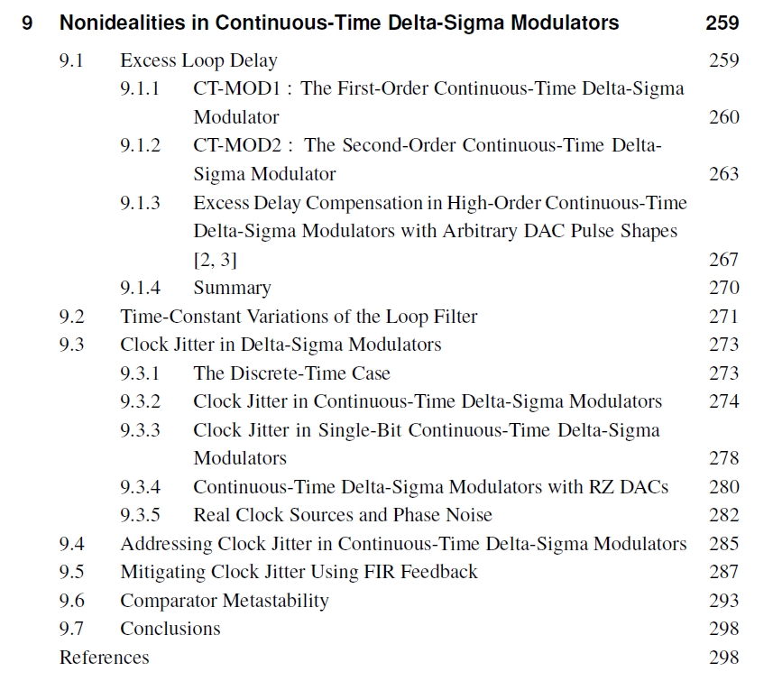

If you will take an opinion, I would say it is probably mostly due to jitter. Jitter can produce more than one possible audible symptom, it depends on the nature of the jitter, also on the jitter sensitivity of the particular dac architecture.
First of all, jitter can be deterministic or random. The random stuff is attributed to a few different mechanisms. There are books and articles on it going back many years. A couple of fairly recent brief articles: https://www.crystek.com/documents/appnotes/ImpactUltralow.pdf
https://www.crystek.com/documents/appnotes/SourcesOfPhaseNoiseAndJitterInOscillators.pdf

There is a good book: Understanding Delta-Sigma Data Converters, 2nd Ed. (Wiley-IEEE Press)
Part of the table of contents attached below. Just an example, there are other publications that go into the technical effects. Of course, engineers usually don't get into resulting perceptual effects in books like the one mentioned.
EDIT: The only point here is that, yes, clocks are very high frequency, but none the less jitter can affect audio outputs.
