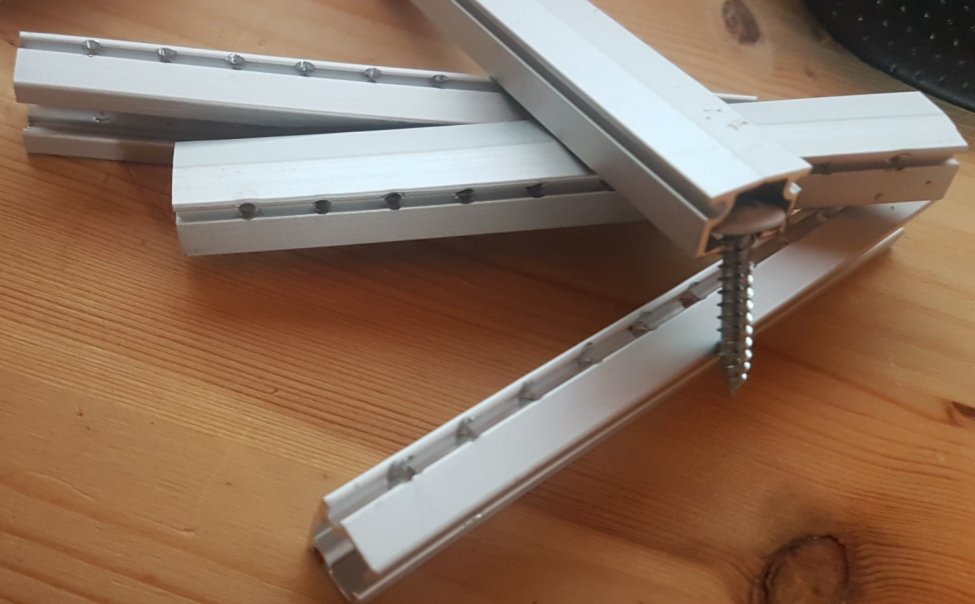

My first attempt to fasten the woven cords was by means of knots on screw heads. That was rather ugly. I found some curtain slide rails in my garage.
After some sawing, hole drilling and painting:

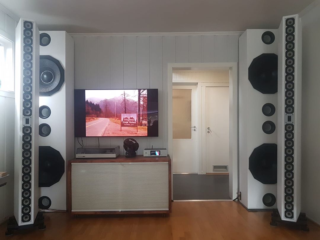

Thank you Wesayso.
The sims & wiring in nc535's thread is very interesting.
However, the internal wires in my column is drowned in a closed gutter with latex compound. Reversing this will demand a tear down of the rear wall.
I got two labyrinth boxes for single TC9FD-18-08's that I intend to use as Polk SDA simulators (reverse channels in reverse phase some dB under main speakers volume).
If I should make another column now (a 6th) I would implement both cardiode, f-dependent shading, directional phasing and cross talk cancelling together with servo subs.
Such effort is anyhow wasted as long as I do not build a new adapted living room.
