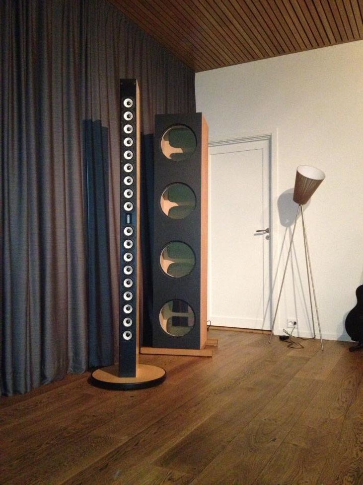

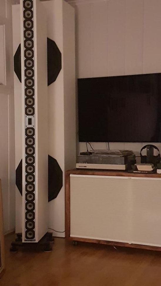

Inspired by Roger Russels pretty IDS-25, I finally built my own towers.
DIY'er "5th element" generously shared his impressions, tweaks and measurements with me regarding VifaTG9.
He pointed out that3d. and 5th harmonic distortion raise quite a lot from 500 hz and down. The void under the cap is a relative big chamber in front of the 6mm "pipe". The cure was to add phase plugs.
The solution was some volum knobs( for guitar) spray painted with Plasti-Skin (same as PlastiDip) and wooden spline dowels 30x 6mm with a drop of glue, just to secure. Luckily, both the knobs and dowels dias are 6mm, fitting the hole in pole piece precisely. In other words: Mostly Lego. Knobs are plastic, not disturbing any field.
All TG9 (4 ohm) got its own chamber, 4,7 liters each. Compartments are separated by 6mm gypsum fiber-sheet (rehab plaster).
Full range? Mostly.I will experiment with chime-in tweeter.
I doubt there is such a thing as high end 3,5" cone tweeters, so I added AMT tweeters from Aurum Cantus (Oscar JAS) . Tweeters are modified with flat faceplate and damped conical back chamber from graveyard vase.
Sub woofers are 21" Hipower Pro BR-tuned to 18 hz in room. Magnet is dia 13". Not easy to handle in workshop.

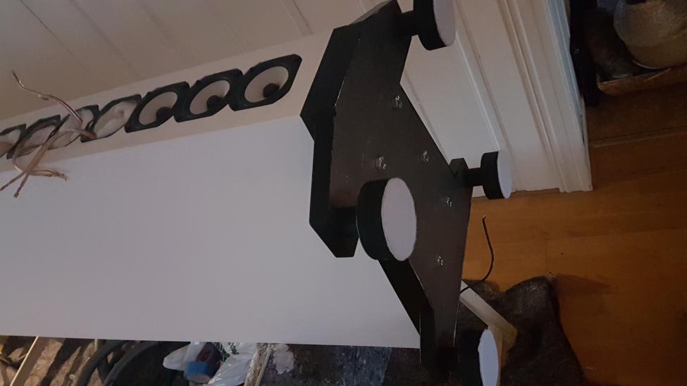

Baseplate for towers are 25mm Alu with EPDM rubber dampers (from domestic AC accessory) and ice hockey pucks with felt. This make it easy to push the speakers in position.
Speakers are CNC machined and painted with paint meant for floors and stairs. Nylon elastics on baffle inspired from Sonus.
For tuning I use Dirac Live and crossover by MiniDSP. Tuning is ongoing.
WAF? I'm happily married :)

It kind of looks more like the Adyton speakers if I'm honest. :)

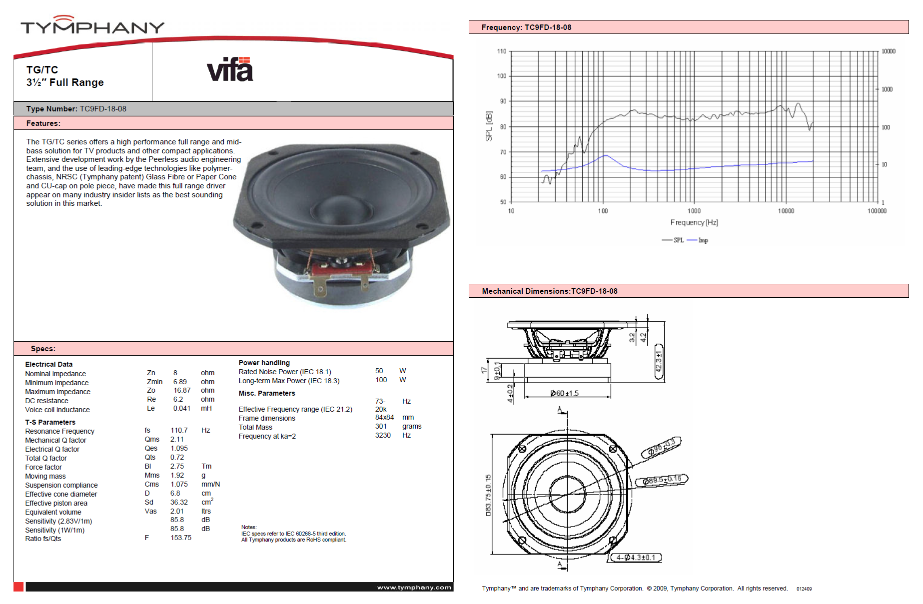

Pls correct my math if in error:
24 TC9 (drivers) x 36.3 (sd) x 2.6 (x-max) = 2265 (displacement)
1 (12") x 530 (sd) x 7 (x-max) = 3710 (displacement)

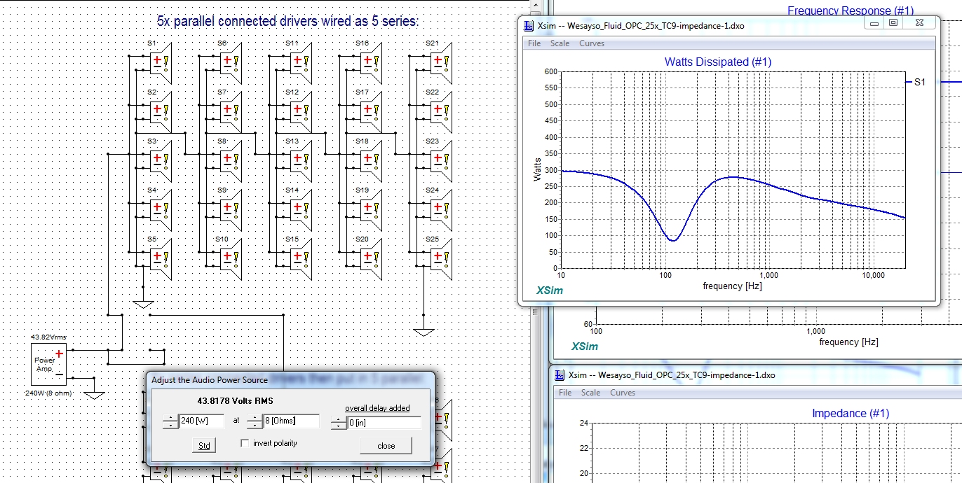

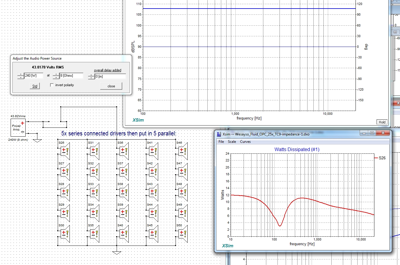

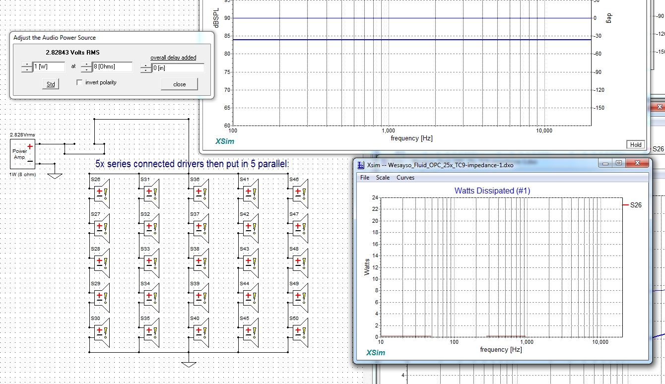

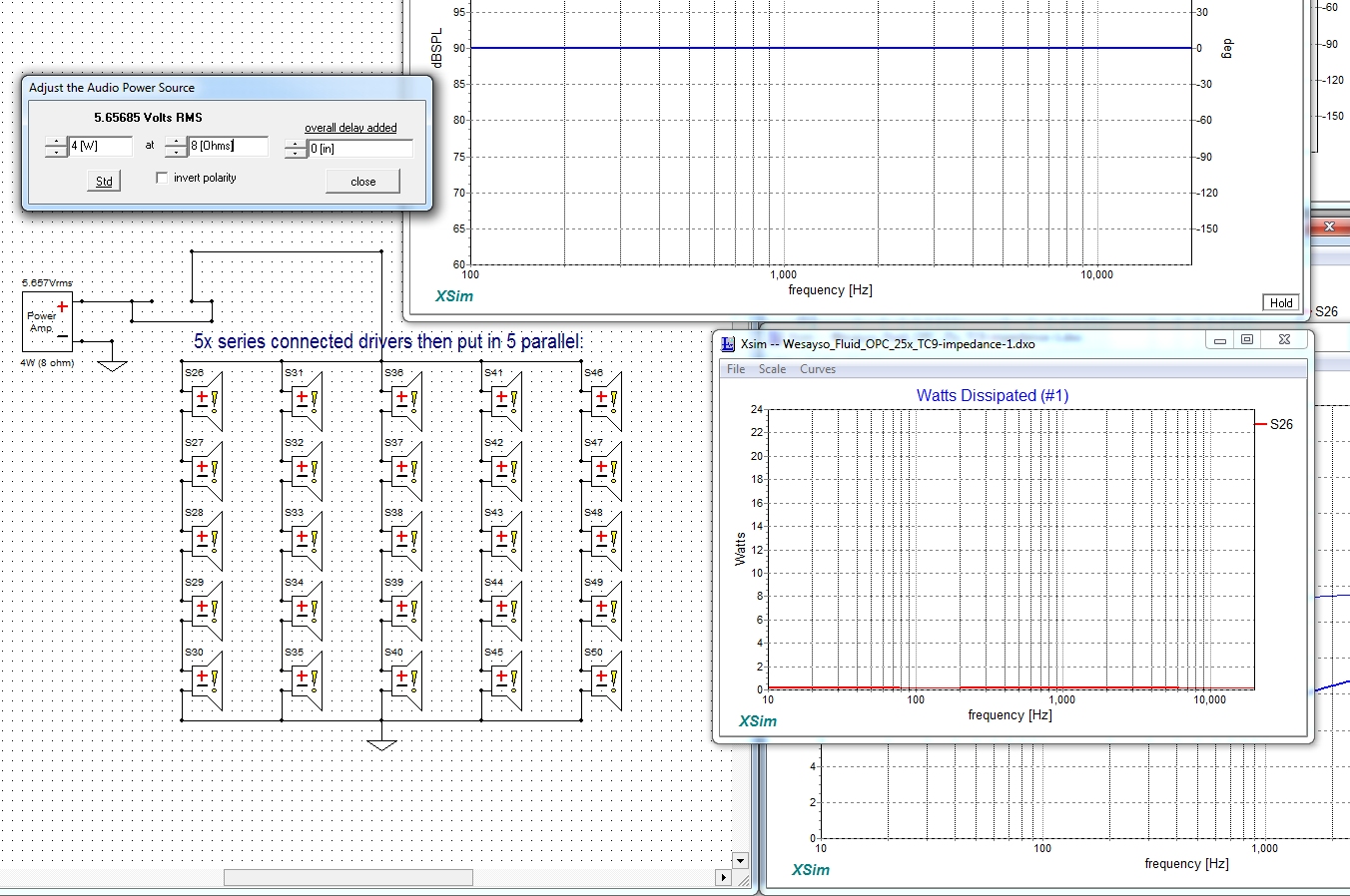

The 6 dB, translates to 4 watt compared to 1 watt, right? Doubling the power for each dB.
Let's fire up xsim and see, sorry, I used 25 drivers in series parallel because that's what I have in my library.
attachment.php
One watt, and the graph for a single driver in that array showing watts dissipated for that driver. Even though the graph says 84 dB for an array of drivers, the array behavior will add about 13 dB at ~200 Hz. At 1 watt it will be close to 97 dB/watt at 300 Hz. Dropping output potential below Fs of course. And dropping 3 dB per octave above that.
Now let's pump up the volume, putting in 4 watt for that 6 dB in gain:
attachment.php
Still barely visible what one driver gets, hence my comment about spreading the load between the drivers.
Let's pump it up, putting in 240 watt, like I claimed it could handle:
attachment.php
Each driver still get's a fraction of that, in this case: 8 watt at 200 Hz, 10.25 watt at 300 Hz etc. Depending on what version of the countless spec sheets you've got it is advertised as a 30 watt noise power handling per driver,
attachment.php
50 watt in rev1:
attachment.php
But I've always used 15 watt myself, due to wanting to keep things in one piece while boosting the low end.
The scale says it hits 107 dB, the array behavior will add the 13 dB to that, making it ~120 dB at 200 Hz, and falling off 3 dB each octave above that, where the watts dissipated drop down.

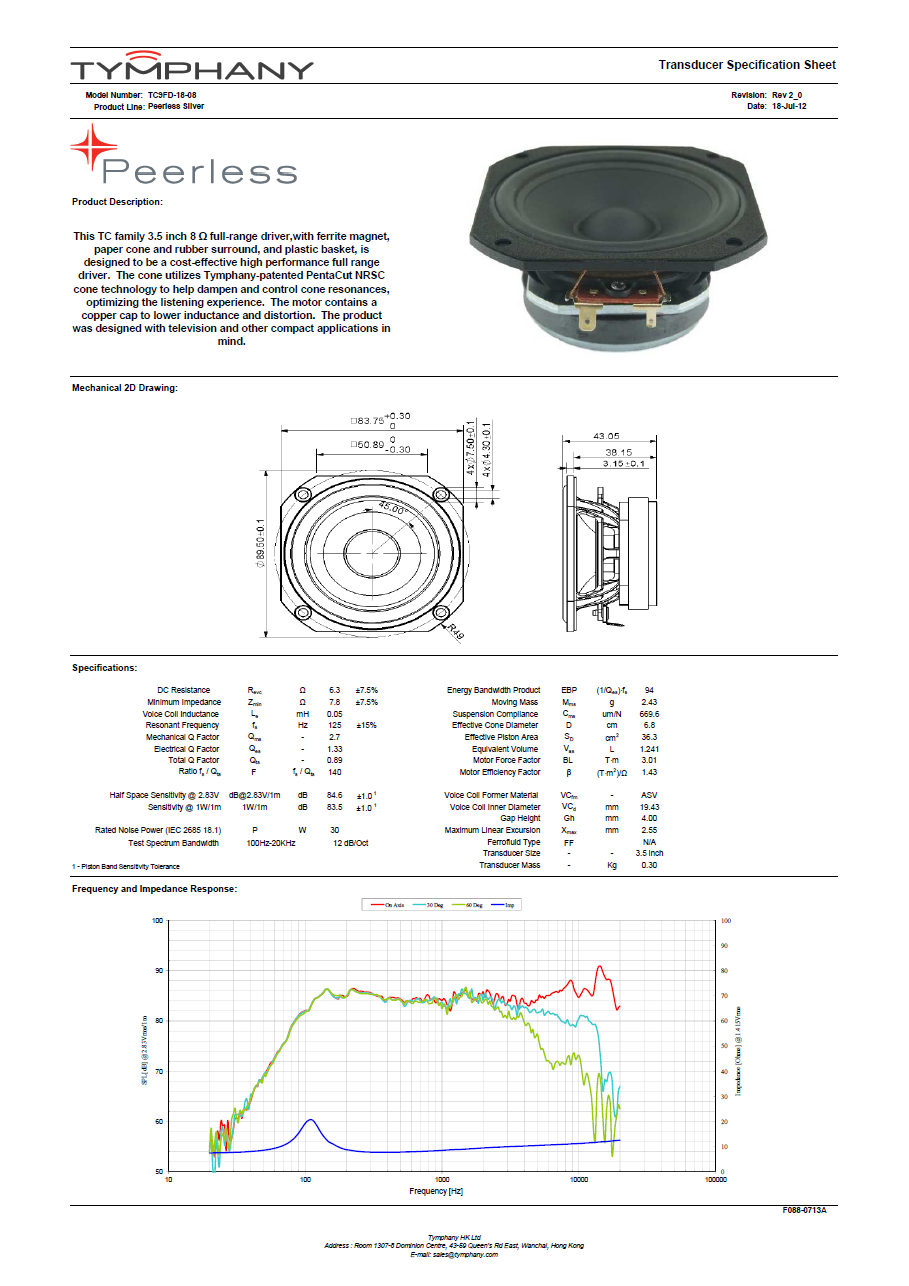

I could have figured you'd pick a healthy 12" driver. I have the Scan Speak 30W with 466 cm3.
Did you connect the drivers in parallel/series? Because I've never checked watts dissipated for that scenario :eek:. You could be right in that case.
So maybe this was a gross oversight from my side, thinking I had to rewire to parallel series because of the better behavior/handling at Fs? Is that connection scheme handling the total amount of power in each and every single driver of that array? It would/could explain why you ran into x-max very soon... I honestly never did that math(!) However I would think anyone building it like that would bother to check. I've literary run dozens of sims for my arrays.
Let's check it now:
attachment.php
25 drivers in parallel/series with 240 watt, one driver gets the full amount!
That would explain a great deal :eek:. It also puts an end to my personal rewiring dreams :eek:. (I have to say, I'm pretty sure I would have checked this in advance before rewiring)
I have learned something new today, for that I do thank you. But I feel ashamed/stupid I've never checked this before. Why didn't anyone else ever check this and correct me? For all the times I promoted the wrong schematics? I'll copy and paste this in my thread as a warning!
756307d1557737322-ids-25-stalker-ids-24t-wattsdissipated1-jpg
756308d1557737324-ids-25-stalker-ids-24t-wattsdissipated2-jpg
756309d1557737665-ids-25-stalker-ids-24t-wattsdissipated3-jpg

Let's check it now:
756314d1557739440-ids-25-stalker-ids-24t-wattsdissipated4-jpg

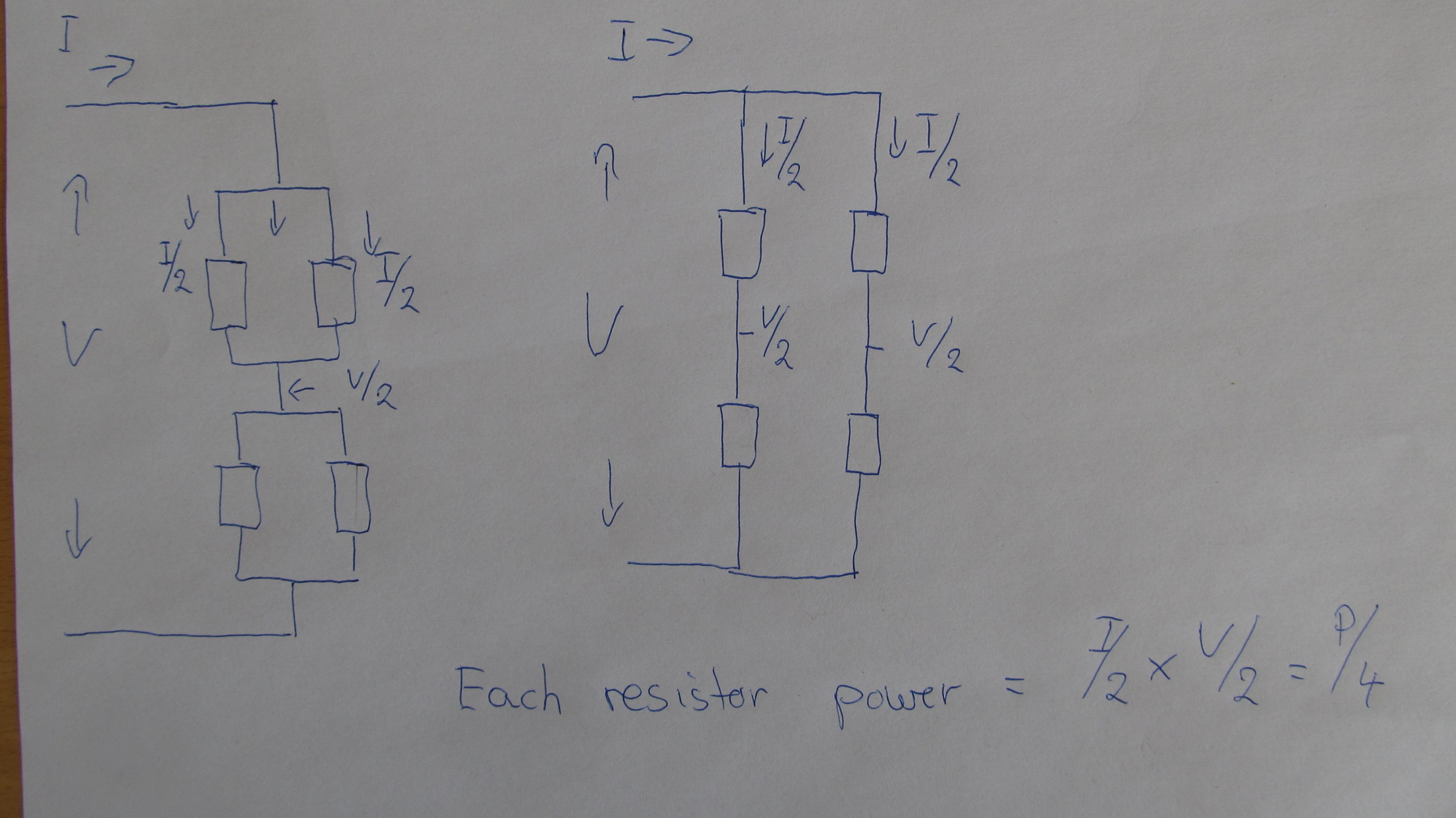

I am not sure what went wrong in your sim of this , and I have not yet gone through the schematics of the two situations, but your conclusion is wrong!!
No matter how you wire them parallel/series or series/parallel each of the speakers will get 1/25 of the total power you present at the total array.
When I look at such problems I always try to take a simple example to show how it works. 4 resistors can be put in parallel/series or in series/parallel and this shows what happens. Dosent matter how many you are dealing with, the situation will be the same. This is Ohms Law and no sim software is going to change that IMHO :D
That's what I have always figured as well.
It should not matter... I just picked the schematic that Byrtt made and typed in the power numbers. But theory is that these drivers do share the load, right? Or something must be wrong, like in my quick example.
I may have done something wrong in the schematic, as I have used that for other purposes.
Let's check it now:
Hi wesayso, koldby is right.
Series/parallel or parallel/series makes no difference.
All that matters with regards to equal power dissipation is that the voltage to each driver, in whatever wiring scheme used, remains the same to each driver.
I highly recommend ditching thinking in terms of watts, and working with voltage....
It looks like you need to remove the ground from the left side column of drivers in your sim...that should fix things..if I understand the sim correctly..

Crossover points: I start with 100 hz and 3500-4000 where the Vifa start the 30 & 60 degree downwards slope. I'm not finished with tuning yet as one amp had a breakdown.
The woofers are used in former Midgard Audio Centurion subs .
They got glorious reviews, so I made my choice when 4 of the 21" drivers appeared for sale on a swap meet.
My woofer cabinets are specified by Midgards Audios engineer.

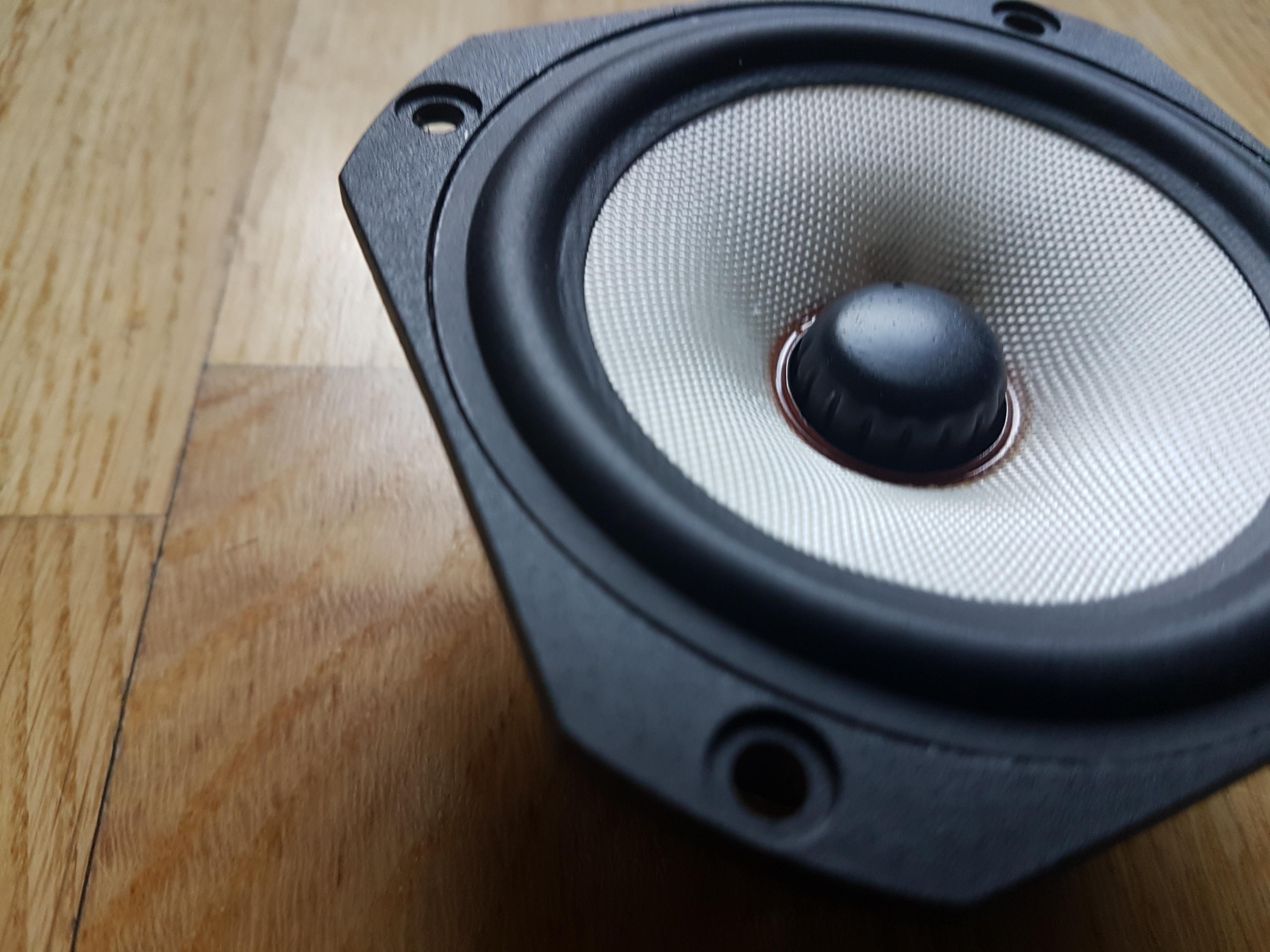

All I was really wondering about is why the mod on the drivers was needed with drivers that don't have to go down low.
But it would let you try it instead of using the big guns.
The big woofers is quite a good and solid solution if you ask me. :).
I see you plan on running different solutions, you have lots of options this way! I hope you keep us posted how you do with both low en and upper end support.
I do like the visual end result. No way I would be allowed something similar though... I'm a bit jealous/envious :D.
