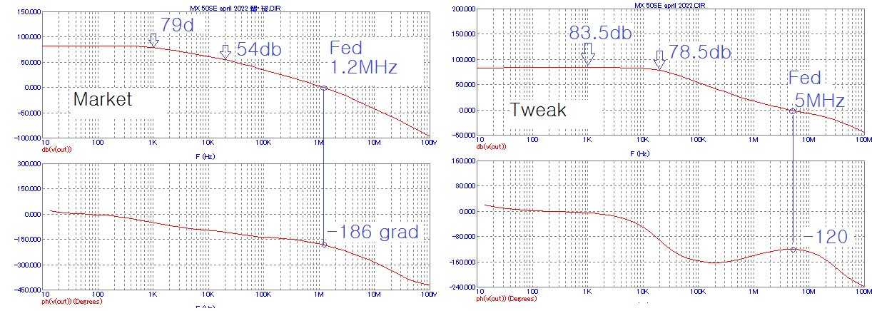

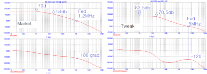

This is true for amplifiers with miller correction, i.e. most vintage amps. With progressive correction, the linearity of which is high Open loop, so this statement of yours is not relevant.The damping factor is frequency dependent due to both the open-loop gain dropping with frequency and the output inductor.
see attachment on the left Miller correction, on the right progressive correction

in fact, not all circuit structures of transistors can provide linearity in Open loop amplification, so cascade linearity is very often formed using local feedback and only then a General negative connection is introduced. If approximately the Damping Factor for speakers is sufficient DF = 20, this is the depth of the NFB = 24 dB, for a low-frequency woofer DF = 200 is sufficient, the depth of the NFB = 46 dB. Depending on the quality of the audio material and its compression ratio, the gain factor is selected, which, together with the feedback depth, gives the overall gain of the Open loop amplifier circuit.ARC has settled on less feedback,
