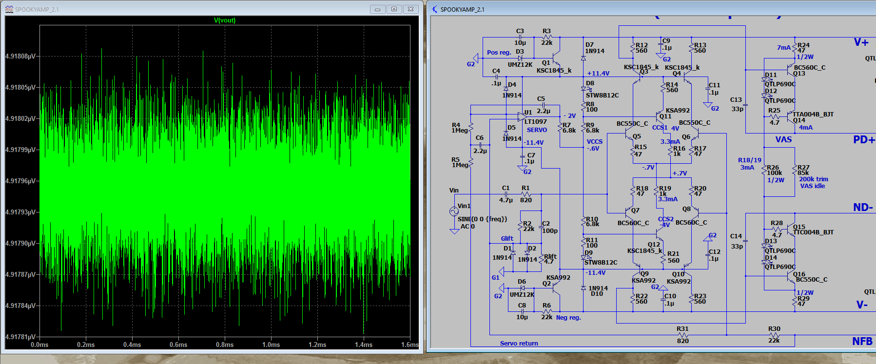

Why is that? I see only one inversion in the DC loop, so the loop polarity is correct.If the DC servo really is as shown, I would expect U1 output to be stuck on a supply rail. R49 should be connected to ground rather tied at R50, C30.
I'm embarrassed, but I must withdraw this comment. Maybe my eyes are failing, but I thought the error amp was a differential integrator, i.e. non-inverting integrator. But it's not. Opamp plus input is grounded--- a simple pole followed by inverting integrator. 🙁

Good point--it's a regular LTP without Q5 and Q8, and they turn it into a long tailed trio.It looks slightly more conventional when you ignore Q5 and Q8, then they simply take the output current from one side of each input differential pair. Q5 and Q8 are needed because of the differential input, so the differential-to-single-ended conversion and input differential pair are intertwined.
Without overall feedback, the DC servo would have a bandwidth of roughly 1/6 rad/s, 0.026 Hz, so it would take about 30 seconds to settle within 1 % of the initial offset. The overall feedback probably makes it even slower, and it gets slower again when you push the mute button.

Q15 and Q16 appear to be drawn wrong.
The voltage regulation is applied to only part of the front-end. Combined with little negative feedback, the result is hum.
I suspect a lot of the sound of this amplifier is due to the high (~0.8 ohm) output impedance. The effect can be mimicked on a good amplifier by adding a resistor in series with the speaker.
They look like normal FET current sources to me: N-channel depletion MOSFETs with a resistor from source to gate to give some series feedback.
162/3.3 = 49.1, is that really much different from 47 ?The feedback netwoek 162k:3k3 could easily be changed to a more conventional 47k:1k
TBH I was a bit disappointed to see a GNFB loop at all, with that number of complimentary output transistors I'd have hoped for a more imaginative design. Leaving them out of the feedback look, perhaps as part of a darlington, would also enable the low level signal earth to be decoupled from the speaker return path perhaps.
I like the FETs on the input, probably helps the sound, NFB only really works well on a linear system IIRC, so perhaps this makes it sound nicer.

I'm curious what schematically causes this amp have high output impedance? Does this also mean that it's dampening factor will be low? From a sound standpoint, this amp appears to have an iron grip on the speaker, as it's bass is very extended, fast, tight and controlled.
small depth of negative feedback, i.e. low gain open loop.'m curious what schematically causes this amp have high output impedance?
