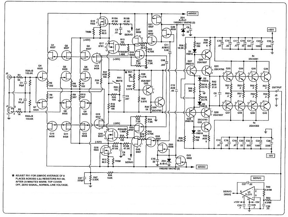

I'm still wondering what in the design causes this amp to have high output impedance, and does high output impedance also a cause a low dampening factor?
I did a rough estimate of the output impedance by dividing 15K (R45) by the current gain of the EF2 (about 10^4), and then dividing by two for 6dB of negative feedback. This gives 0.8 ohms.
There is also small-signal impedance of the BJTs and the 0.2 ohm emitter resistors that I am ignoring.
Typical solid-state amplifiers use much more negative feedback (20-60dB), and so the open-loop output impedance is divided by a factor of 10-1000.
