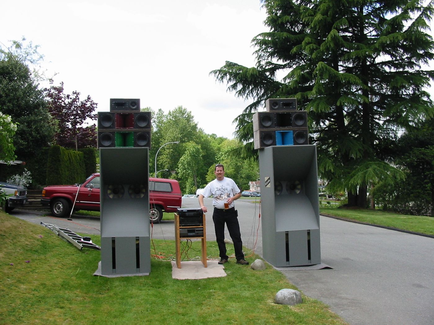

6x6M is a good size, about 50% bigger than the garage I took over. See Here
Mine has the luxury of a 3.3M ceiling height, which really helps.

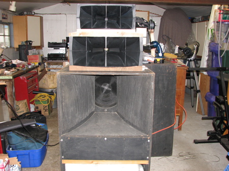

My system is a highly modified Altec VOTT A5.
Acoustic crossover points are about 750Hz and 9Khz. -3dB points are 28Hz and ~17Khz.
- 15" Altec 416-A woofers
- 1.4" Altec 288 compression drivers on Altec 1005 multicell horns
- Fane bullet tweeters.
Seems to be plenty of speaker for the room. Tho a buddy wants to give me his big Meyer Sound 2x18" powered subwoofer. That would be a lot of fun, but where would I put the beast?
Anyway, because of corner gain, I have to reduce frequencies below 80Hz on The Altecs by 3dB. Too much low end bloat if I don't.
My other speakers are Open Baffle. 2X18" woofer + 8" fullrange each side.
