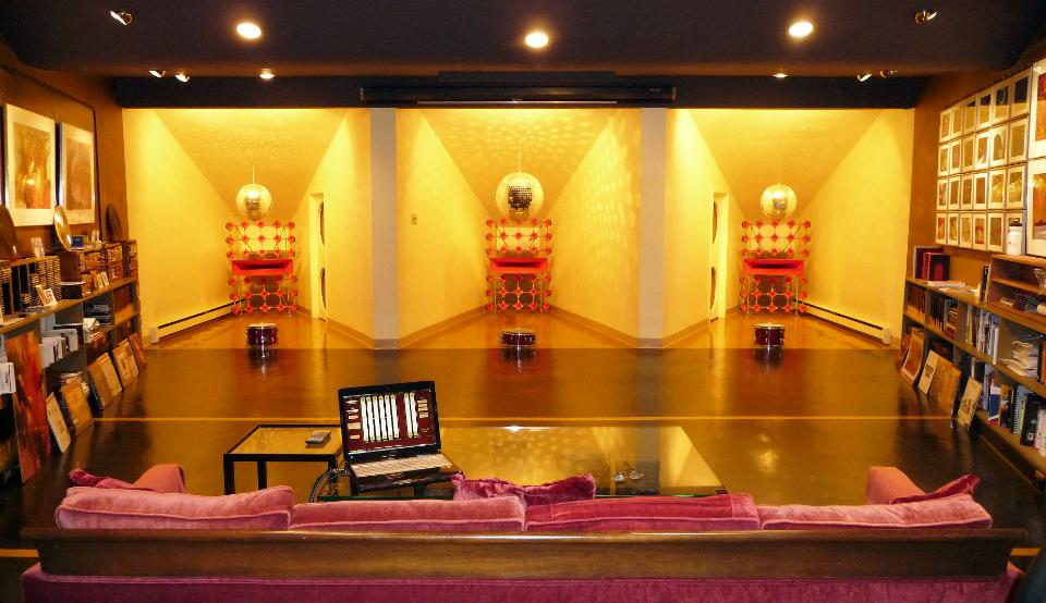

If I wanted "man cave crazy" speakers I would follow POOH's Stargate 6 Horn System thread
http://www.diyaudio.com/forums/multi-way/251665-stargate-6-horn-system.html

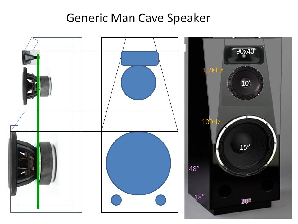

If I wanted "man cave generic" speakers I would acknowledge the long success of the JBL 3-way studio monitors:
18sound NSD1095N 1” compression drivers
Denovo 12” OS elliptical waveguides
LR4 at 1,200Hz to a high efficiency 10" midbass
Lambda TD10M, Faital 10PR300, JBL 2012H, Eminence KapaLite 3010H,
LR4 at 100Hz to
Etone 1525 15” woofers
you can decide between efficiency of ported, vs. MiniDSP equalization flexibility

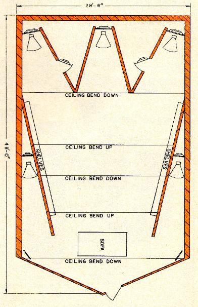

Scale Down From This [1]
If all depends on how you plan on reproducing the first decade.
WHG
[1] Dick Burwen

You could probably build quite an extensive SW horn or two in the garage attic structure🙂
