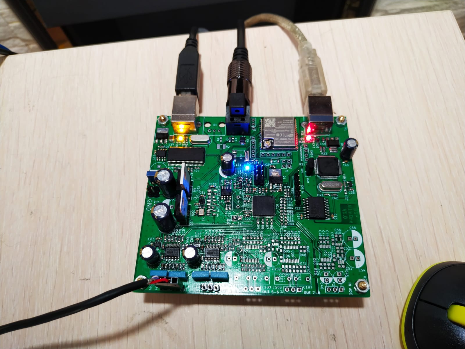

DSP ADAU1452, Out up to 4 DAC PCM5102, 8 cannels.
Optical input, USB input STM32F446 (96-24), Bluetooth input and control - ESP32, analog input PCM1808.
Sigmalink DSP programmer onboard.

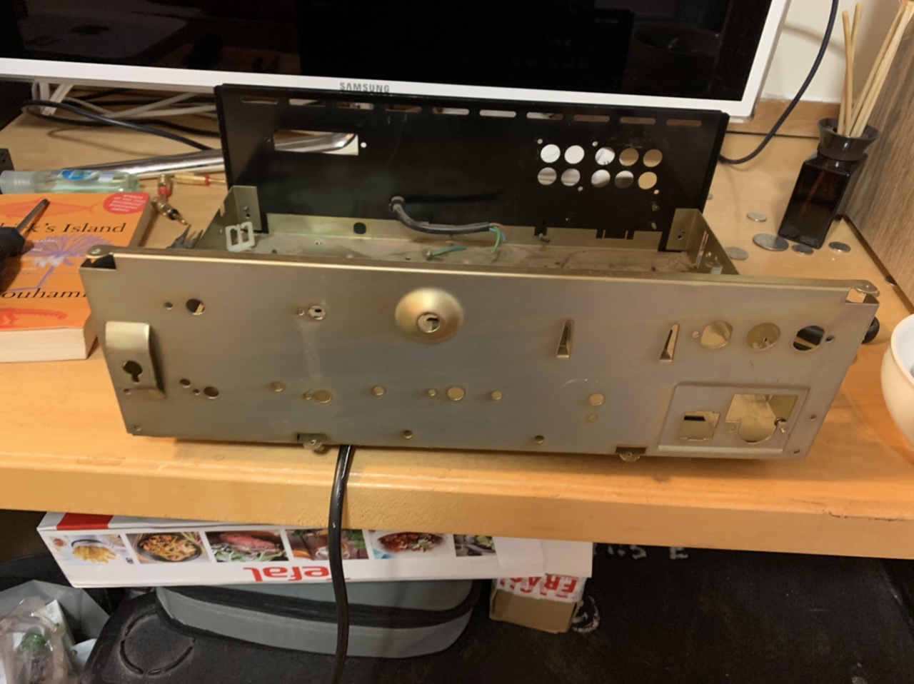

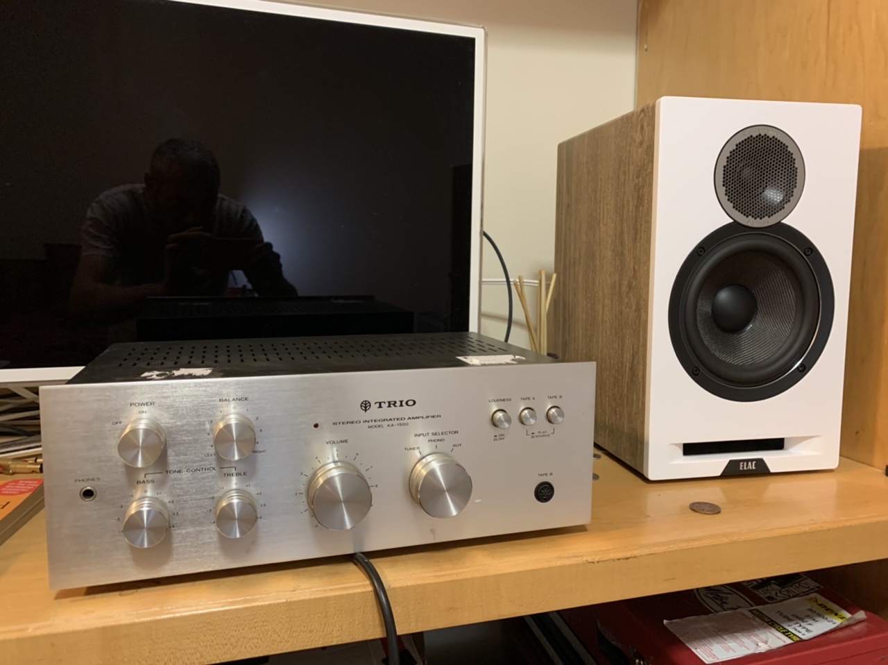

My amp after a few months has not failed to impress me. My only issue is that it runs warmer than I would like. Since adding a RaspberryPi and usb power supply I think my case is a bit crowded. To solve this issue without adding a fan I decided to get a bigger case. Rather than a nice new case I have gone for something retro, I looked on eBay for a 70’s amp to butcher. I wanted something with a simple clean look, no square buttons or sliders and even though they look cool no VU meters. I found a Trio KA-1500, I think it looks great and hopefully it will solve my cooling problems. If all goes well over the weekend I will post some pictures of a slightly warm and cool looking amp. My Trio only has one channel working so I won’t be ruining a perfectly good amp for this project.

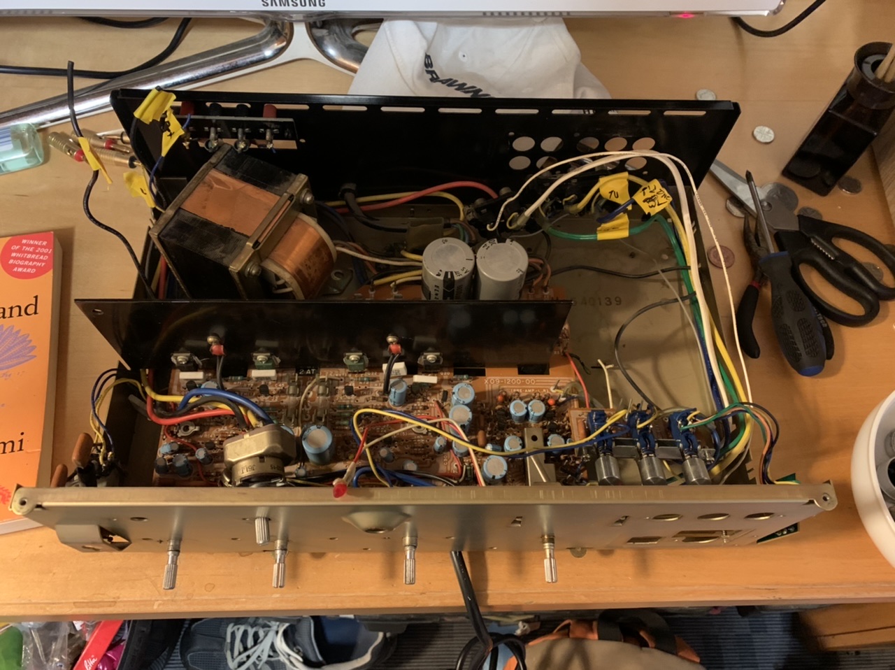

My Trio KA-1500 arrived on Friday. I stripped it out and then installed the main bits from the cramped amp case. I want to use the Trio power switch so need to add a 240vac relay. The only other bit I used was the power LED and a scavenged resister so I could connect it to the 12v aux on the 3e TPA3255. I added a separate power switch for the raspberry pi on the back as it is hassle turning it on and off. I used little lever connector blocks for the 240vac wiring, they were very handy. The iPad usb charger was used because I could wire it in unlike most which only plug into the wall. It barely gets warm now which is what I was hoping for. I put all the pots back in to mount the knobs except the volume which is a 10k SMD DACT type 21 step pot.
