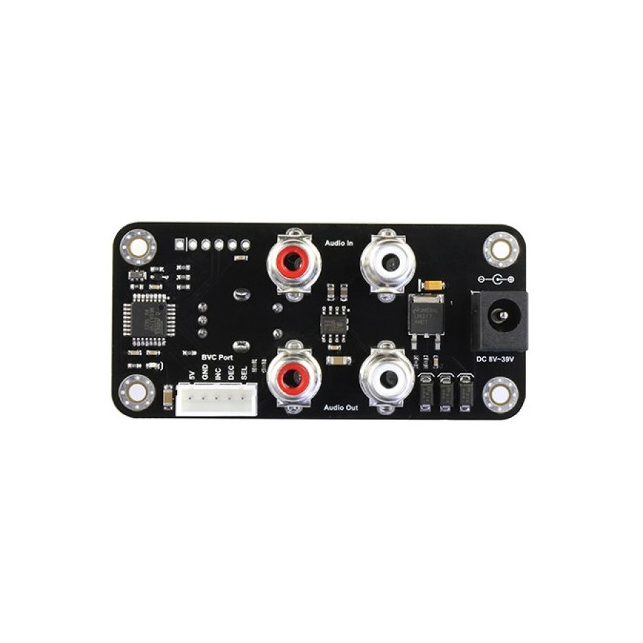

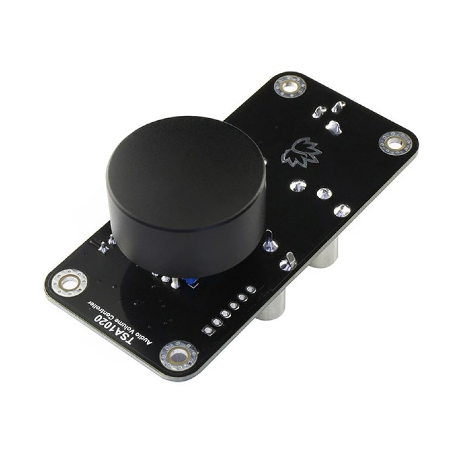

On my next TPA3255 "non public board" project, I will try this Digital Volume board :
It is really interesting because it includes a BVC input that allow you to add a Bluetooth controler later )

Does this company have a Bluetooth board for this controller as I couldn’t see anything listed on their site. They also don’t say what chipset is used ?? They do have an IR based one listed. They do another model that already has the Bluetooth capability on the volume control board.
Given the amount of trouble you have gone to with rolling the Op Amps on the main board I always get worried about front ending your audiofile power amp with a cheap Chinese volume control. TI do a chipset for a volume control that some people seem to think is good enough to put in front of the TPA3255 series amplifiers.

I do not know so much about this volume control. It does not work like a regular potentiometer. It is a kind of digital volume control(chipset based) that needs a 12V DC to 35V DC PSU. But I own it =) You can also mute it when pressing into the center of the volume knob.

What’s the chipset on the board. Can you read it off the chips or send a photo ?
Sure, the best I can do since it is really tiny...
If you zoom in, you would be able to check.
I see something like ATMEGA 328P UTH ....by ATMEL

So the little chip in the middle is a PT2257 digital volume control which is controlled by the Atmel custom programmed processor. Quite simple but not too sure how transparent the volume control will be. This company does other boards that already has the Bluetooth remote control functionality already built in so you can control it with an App on your mobile phone.
