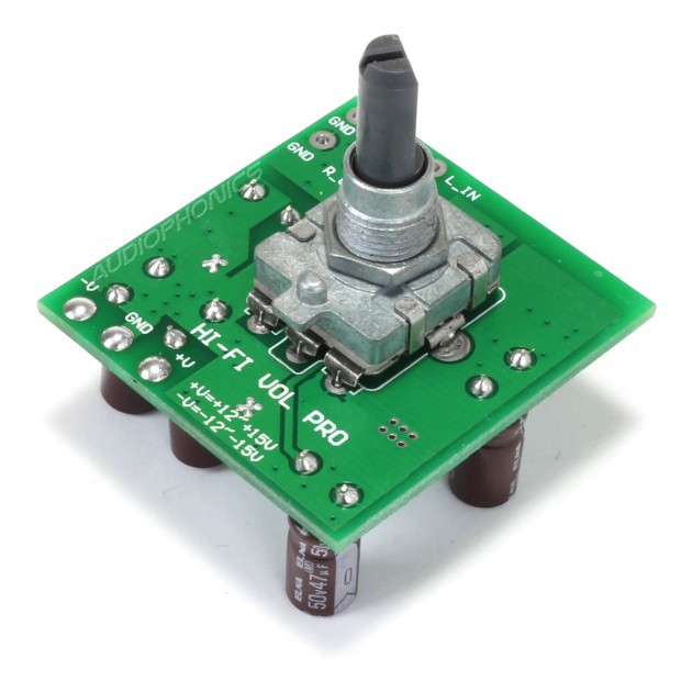

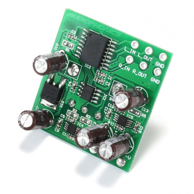

As per TI recommandations, the PGA2310 works fine with the TPA32XX
A choice to consider for a Volume control with some ALPS on it :

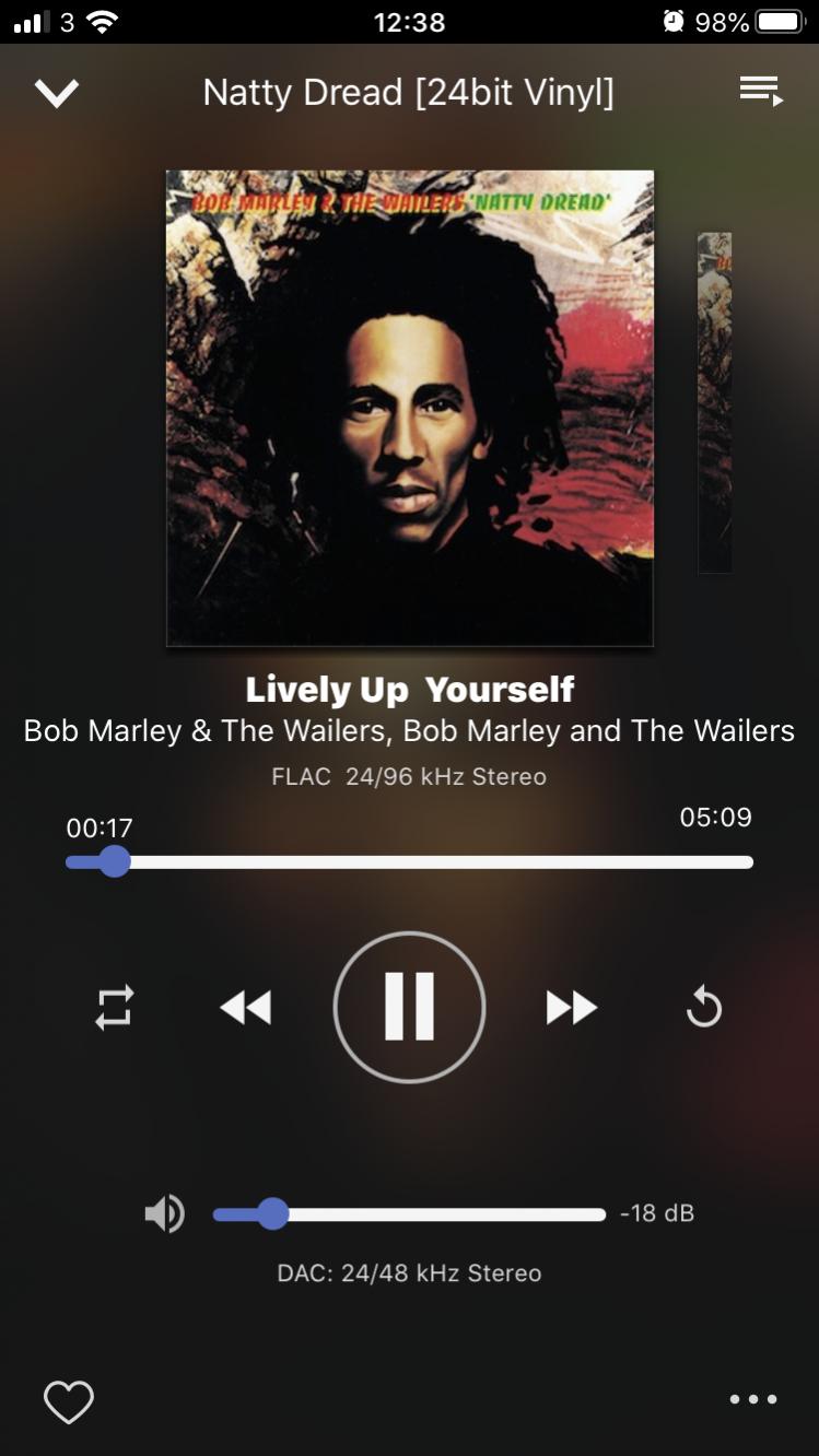

I have Audirvana on my Mac, it has an excellent remote app so I won’t need to have a tv or monitor on when I listen to music. It is supposed to be the best music player out there!
