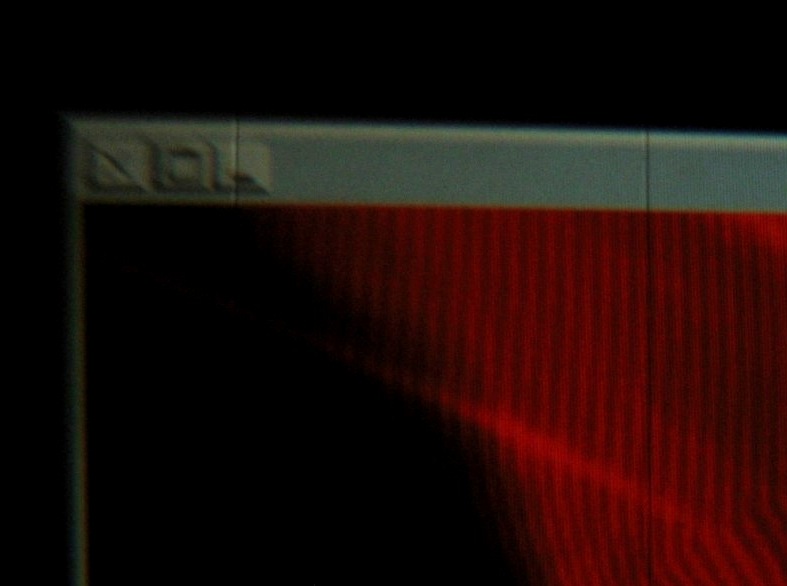

Ideal fresnel lens for 15" and 17" LCD
top left showing dim corner, and bad focus... You can see where the screendoor kicks in.

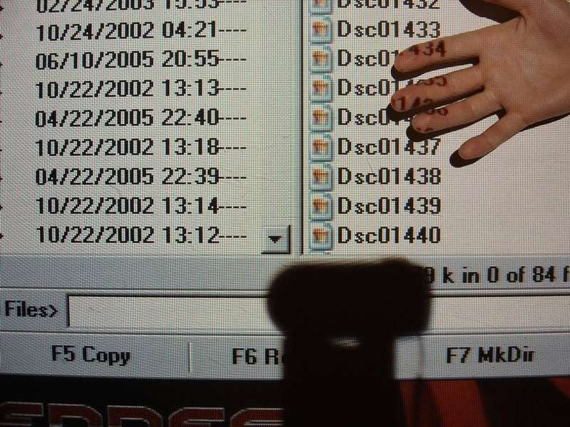

Overall I'm actutually blown away that its as clean as it is. I need to get a better screen to improve brightness, but these pics were all taken during the day with my blinds shut- enough ambient light to read a newspaper (just).
The modified triplet is not very good. The image is always slightly blurry. Its way better in this setup unmodified IMHO.

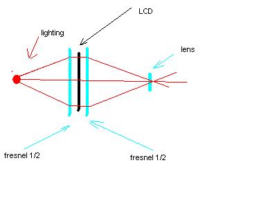

probability that dimidiate at two doings,that one arm will been LCD a two arm after lcd.
At this style is attained that lighting passage under angle by 90'pitch
ahead area level.
