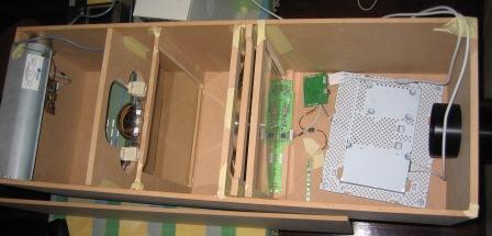

Made a coffin box.
Stripped my 17" LG1710B, and mounted all the bits today.
Fired it up with a 400W double ended Osram 6500K MH bulb.
lamp-IR glass-330mm Fresnel-LCD-550mm fresnel-pro lens

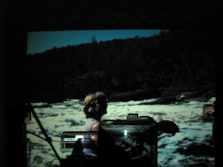

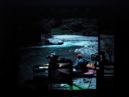

135mm from DIY has a great image in the middle- the screen door is highly visible on a 12 foot diagonal (in the centre) and on high res photos looks fantastic.
But as Rox and so many others have pointed out, the 135mm lens does not have corner to corner focus. FOV is too small for 17". Might be able to get away with 13" 4:3 if lucky enough to have one. :dodgy:
The light is even right up to the corners with the 550mm lens but if you focus for the edges, the middle is not focussed. 😕

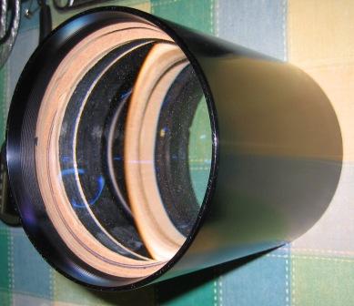

We pulled apart another 135mm and reduced the spacing between the lenses by 20mm, replacing the plastic rings with hand cut MDF rings. It increased the focal length, but again- no corner to corner focus. If anything it looked a lot worse. :bigeyes:
I'm projecting onto a slightly yellowed wall, so brightness is a bit dissapointing. On normal DVD res, the image is awesome in the centre. But no way to get 1280 x 1024 with this lens for use with text. :whazzat:

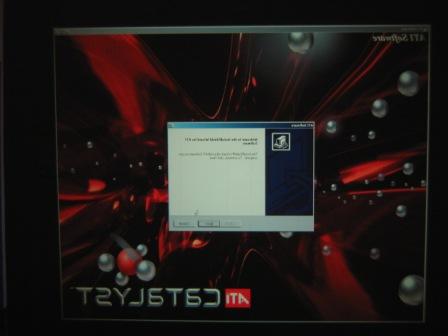

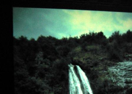

I moved things closer to the wall and tightened up all the lenses etc. I'm still trying to find some kind of driver to do horizontal mirroring. Any tips?

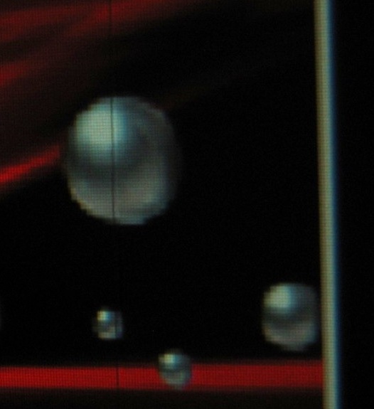

This is 1280 x 1027, showing the centre right hand side. Focus is OK in the centre, even at the sides.
Light in the corners is still not optimal, but a pre-condenser and better lamp placement might help.
