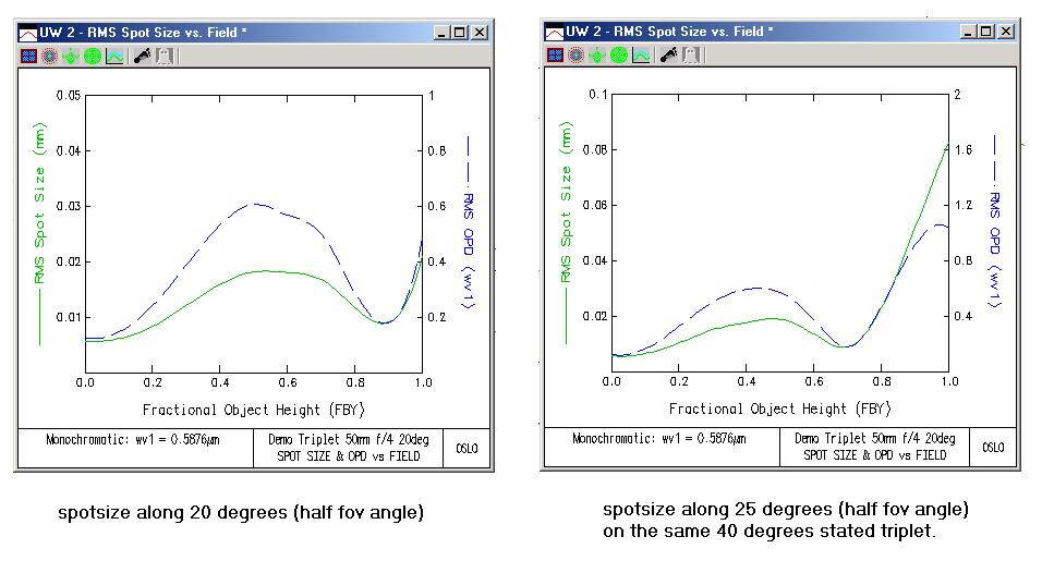

an image is better than 1000 words;
look at the images, they are form oslo spot size simulation form a demotriplet design (came with oslo). The triplet is originally designed to have 40 degrees FOV angle (20+20 half angles).
The spot size is the lens performances sumary along the lens fov (0 degrees- left to 1-full half field side)
Left is a simulation where the field angle is the stated one (40 degrees) check the spot size keeps minimal. The corrections on the lenses are made so the spot size is keep under the max 0.02 value for the green line and 0.6 value for the blue line.
now right is the same triplet but I throwed 50 degrees FOV to it to see what happens. The performances up to 40 degrees are just like the previows image, but farther than 40 degrees, the spot size falls drastically. The green line takes 4 times the max value on the 40degrees test, and the blue line takes double value than the 40 degrees test.
So this lens will show worse performances on the 40 to 50 degrees range. Now consider the 24 degrees stated FOV on the 135 triplet and make it work on twice the stated FOV (somewhere 46 degrees for the 17") DO you see what a dissaster?

nice example, Rox
It's good to see some actual spot size diagrams, so people can understand what we are talking about. The example lens you used is certainly optimized for 40 degrees FOV. It looks like the designer didn't care how it performed at 50 degrees. There are many possible similar designs that would not work quite as well at 40 degrees, but would work almost as well at 50 degrees. It just depends on the design goals. It would be silly to compromise the performance of your lens in the FOV region it needs, just to make it work at an FOV angle it does not need!
Every lens design I have looked at with OSLO has similar curves. The spot size is very low near the center, rises to about half-field, and then falls near the full-field point. (Or it may be the other way around: High at both extremes and low at mid-field.) That is because the designer chose the lenses and spacing to make that happen. He (or she) tried to minimize the average error, while keeping the maximum error below some value.
Another thing to keep in mind: You use the example of the spot size going to 0.08 mm as "bad", but a 0.293 mm LCD pixel with 6X magnification on the screen is 1.76 mm across. That is 22 times bigger than your "bad" spot!
One thing you are absolutely right about: Most opaque projector and overhead projector lenses are designed for a diagonal field of about 14.8", (ie. a 10.5" by 10.5" stage). So they will probably work very well with a 15" LCD, and not so well with a 17" LCD. One limiting factor is the lens length/diameter ratio. These lenses are usually longer than they are wide. That limits the passage of light from wide angles. My process lens is much shorter, because the designer did not want to block the light. I notice that a lot of the 80 mm wide projection triplets are also pretty short.
This is why I suggest a good custom LCD projection lens should be a wider version of a process lens. But when you consider the pixel size, it does not have to be a very good process lens.

that example I used is not a valid one for your LCD pixel size observation, The example was done just to show what happens when we feed with a wider FOV than the "expected" one.
The triplet I used is the one that comes with OSLO, "demotriplet" is the name it has, and it is 50mm focal 40 degrees full field angle stated (or designed for). So the spot size Vs pixel size comparation is not what I was getting to in this example but the performances curve along the FOV.
Now, I agree that If we have a spotsize somewhere as big as the pixel, it would look pretty good on the projection.
Let´s see a fast calc; imagine we upscale this demotriplet lens to 450mm focal lens, then the spotsize will be 450/50=9 times biger as well; 0.08x9=0.72mm so it is more than twice the pixel size (this means that the pixels would be projected diffused, one on top of the other... bad focus on the edges...)
by the way let me tell you something I thing you are doing wrong; the spotsize simulation I did is a "inverse projection" simulation, just think on a photographic camera that takes far light and does focus on the film. Now this is not the case on our projectors, it is like the negative film is outputing the light and it is focused out on the wall, so the spotsize is not aplicable on the negative but on the wall.
Our spotsize needs to keep under the LCD size,i agre with you on that, but if we do the simulation on oslo at same conditions (changing the conjugates so the perfect light source is somewhere at a typical LCD to lens distance and the projection is at a far distance, then the spotsize will show MUCH larger size. But as you said if this value keeps under the lcd pixelsize (considering the magnificatin introduced to pixelsize) then we are safe as well.
Finally let me tell you that I would consider the subpixel size (0.09mm), not the pixel size (0.29mm) for our optical considerations, this makes the things harder for us.
