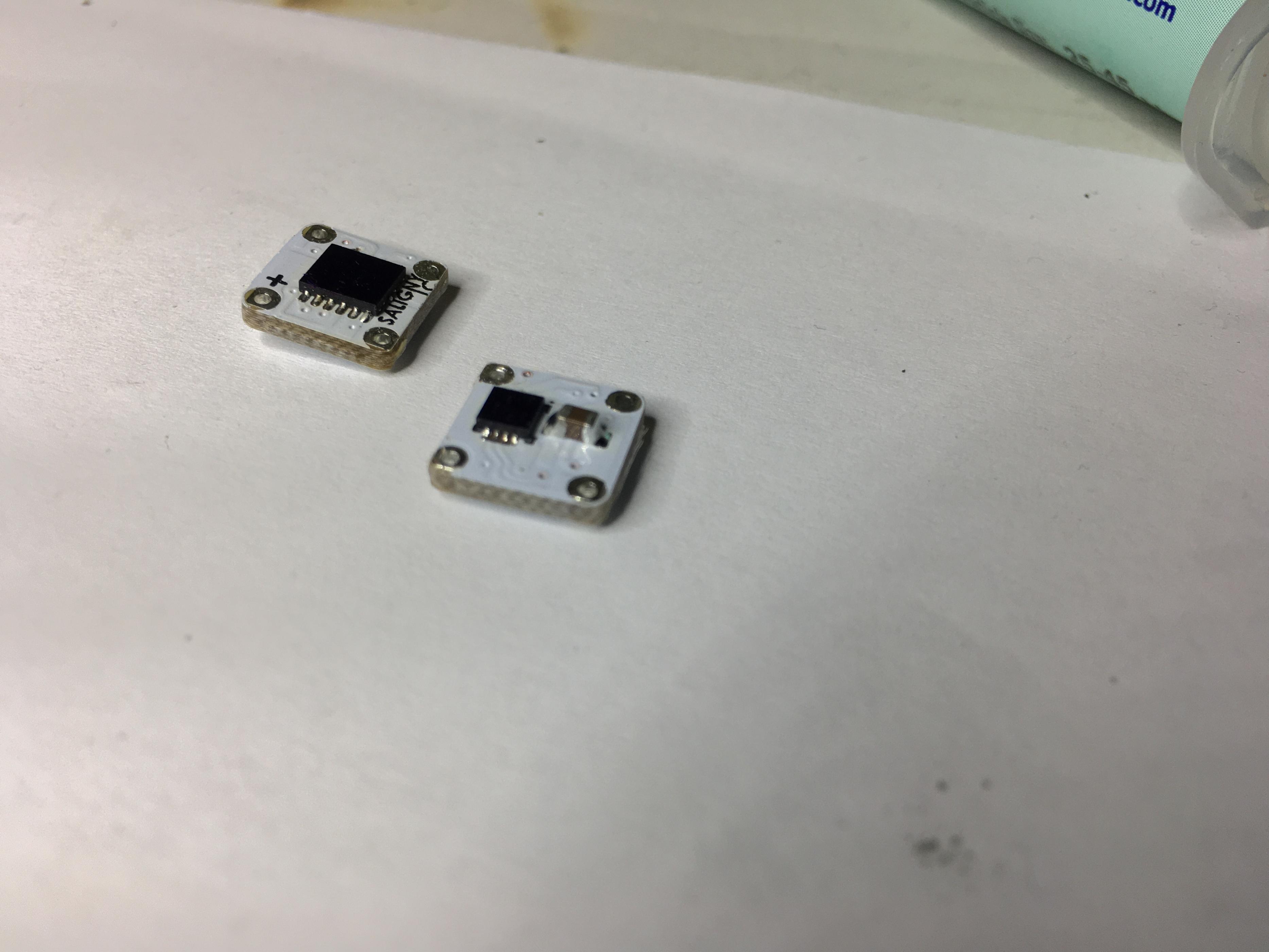

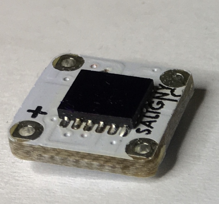

Saligny LC - low current.

Very nice. What are the V/I limits for this setup?
Jan
Min Input = 6Vac
Max Input = 40Vac
Continuous load = 5A
Peak load = 8A
Tibi
