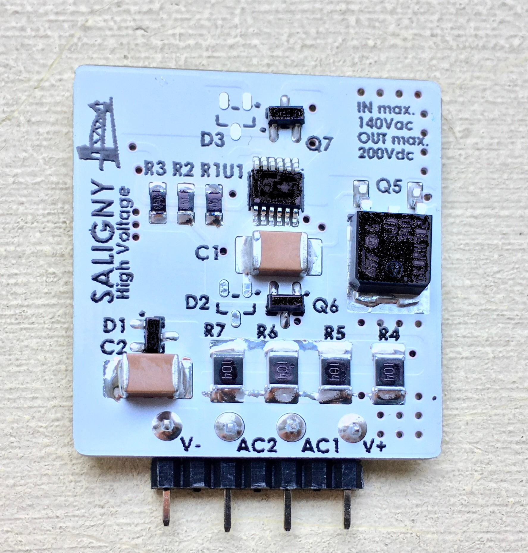

Just finished to mount first Saligny HV. These mosfets are very like unobtainium. Low Rdson and high Vds is tough combination.
Some hard tests will follow to see what this 30mm x 30mm baby is able to deliver.

Watching with interest, a couple of those would be perfect for a new amp project I'm planning if they perform like the first saligny.
Hi Tibi,
Glad to see the prototype there, I'm interested in this for preamp circuits as well. Hopefully the price makes +/- PSUs feasible to get above 300V total for output stages too. It'd be a shame to have all that current capability unused 🙂

Development has ended. Production is hard. Sourcing the mosfets delayed production in mid November.
Saligny HV is performing above my expectations. It was tested in 4 amplifiers. Two Class A, one AB and one D. Sonic improvement was substantial in all of them.
So far any circuit that got synchronous rectification got far better performance.
Tibi
