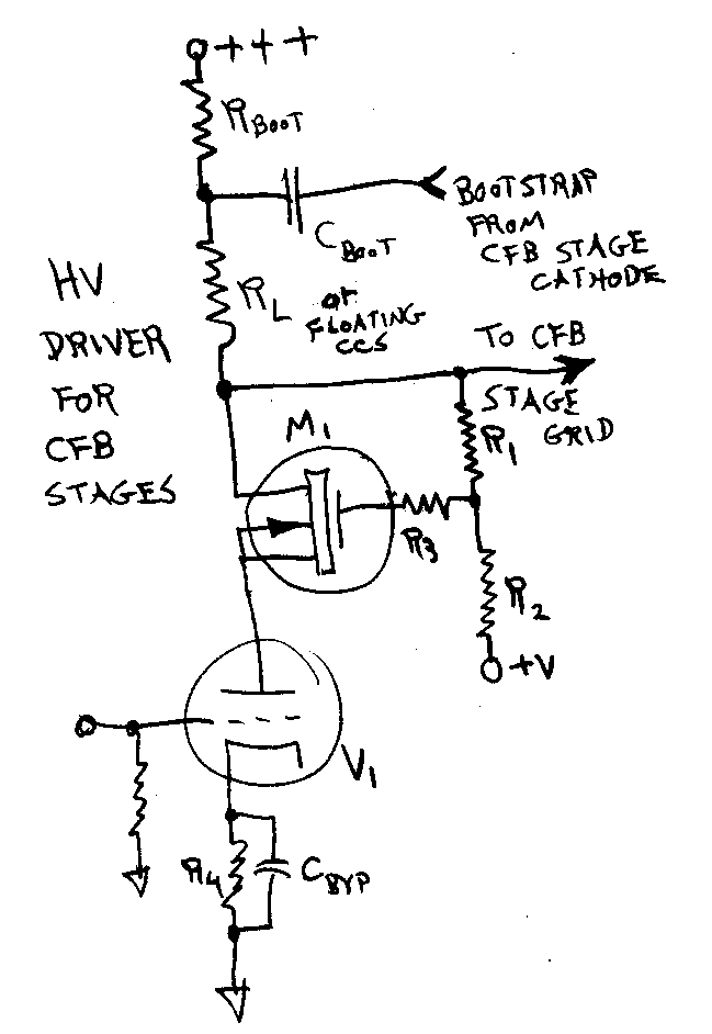

I have attached the drawing of the circuit and am currently breadboarding this up. I'll post measurements as I get them.
I'm thinking that bias stability might be an issue with this. I don't know how much drift with temperature that there will be with the EL34, but I think the final solution will contain a bias servo to keep things running just right all the time.
Please excuse the fact that some of the mosfet symbols and zener diodes are not correct. I was doing a board layout, got lazy, and just grabbed parts that had the correct footprint. I hope my labels will make it clear what is going on.

Here is an idea.
HV Mosfet cascode with N Fdbk to the triode plate (thru Mosfet Gate to Source).
Triode could be a high gm 12HL7 in triode mode. Or maybe an E55L/8233 for $$$.

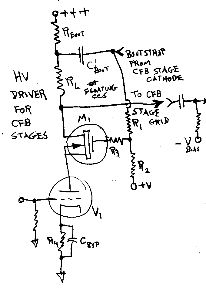

I just thought of a nice improvement on the previous HV Cascode N Fdbk driver.
By moving the top of R1 (of the N Fdbk attenuator R1, R2) up to the bootstrap signal point, coming from the CFB output stage cathode, the circuit then controls the CFB stage cathode V to be
CFB cathode V = Mu x (R1+R2)/R2 x Input V
(instead of controlling the CFB stage grid V as before)
Just more effective use of the N Fdbk that way. And that keeps the R1, R2 attenuator current out of the equation (or out of the floating CCS current, if that is used)
I'm really liking this circuit now. A programmable HV high gm triode. (that even fixes any non-linearity of the output tubes)
One could turn this into a differential version too. Just use two circuits, with a CCS tail under them. (the tube cathodes connected) Probably have to put Gyrators up top then, instead of CCSs. Ehhh, could just use the simple bootstrapped RL loads up top then. They are close enough to constant current. The differential triode tube base can handle a tiny amount of current variation linearly anyway.

Here is the amended HV cascode N Fdbk driver schematic. Might want to move R1 (top) over to the left side of Cboot, depending on how DC levels are set up in the Amp. Alternatively, the bottom of V1 could be moved to a negative supply.

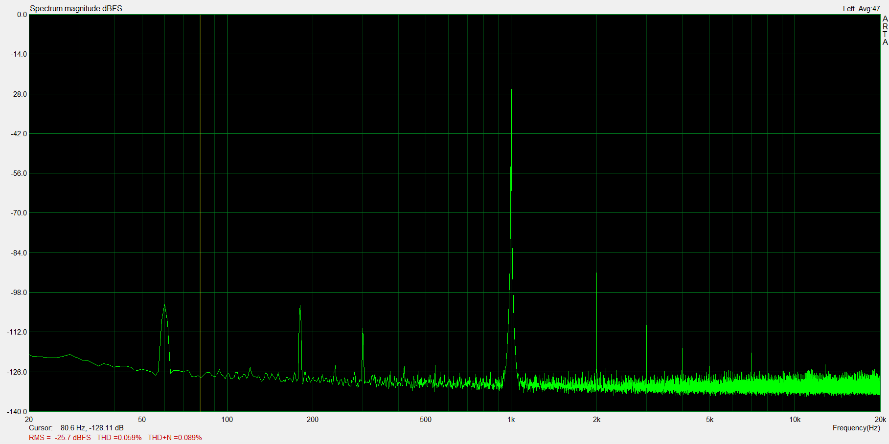

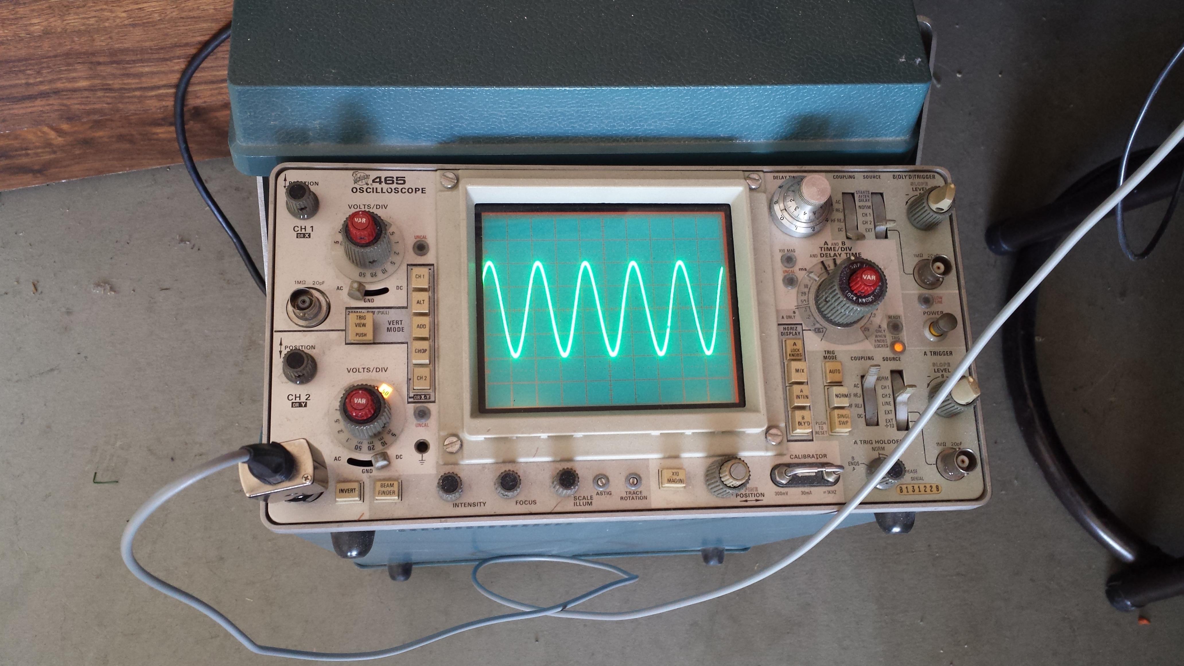

Alright, I fired up the prototype today. I expected plate voltage to wander a bit as the tube warmed (because the high gain of a CCS-loaded pentode) but was surprised to see it stay stable within a few volts for 20 minutes or so. Final circuit will probably include a bias servo to maintain idle plate voltage at 1/2 of supply voltage.
I was running it with a 400V supply with plate idling at 200V. The circuit is configured for a gain of 10. I ran the screen at 100V.

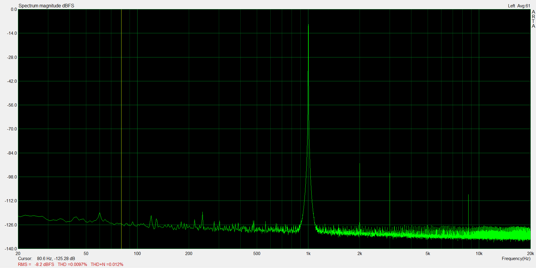

The scope capture is of the circuit putting out 200Vpk-pk. Unfortunately, I can't use the signal generator that I used for that to make a good distortion measurement as the generator puts out ~0.3% THD.
I drove it with 1.8Vrms from the sound card for the distortion measurement. Output was 18Vrms.

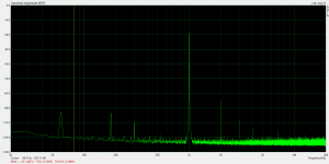

I'm pretty happy with this ADA4700 test setup. I'm getting a gain of 20 and pretty good output swing. This will be a great setup for trying driver stage ideas. Attached is a measurement of the soundcard looped-back so you can get an idea of how much (or little) distortion the ADA4700 is adding.

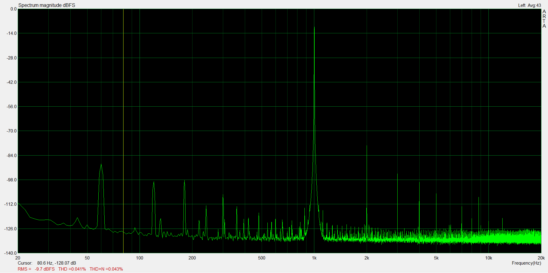

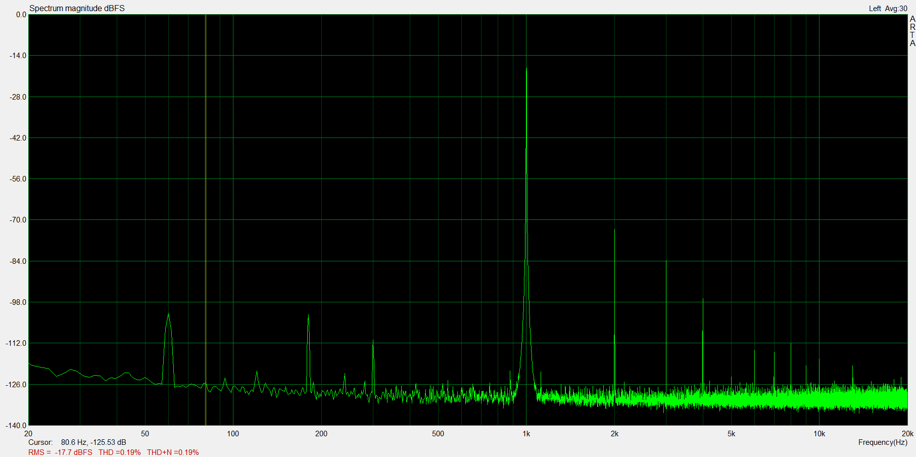

Now here are distortion results from the EL34. Output levels are 30Vrms, 75Vrms, and 105Vrms.
I couldn't go over 105Vrms with the 420V supply that the EL34 is currently hooked up to. Next I will have to construct an 800-1000V supply to test with.

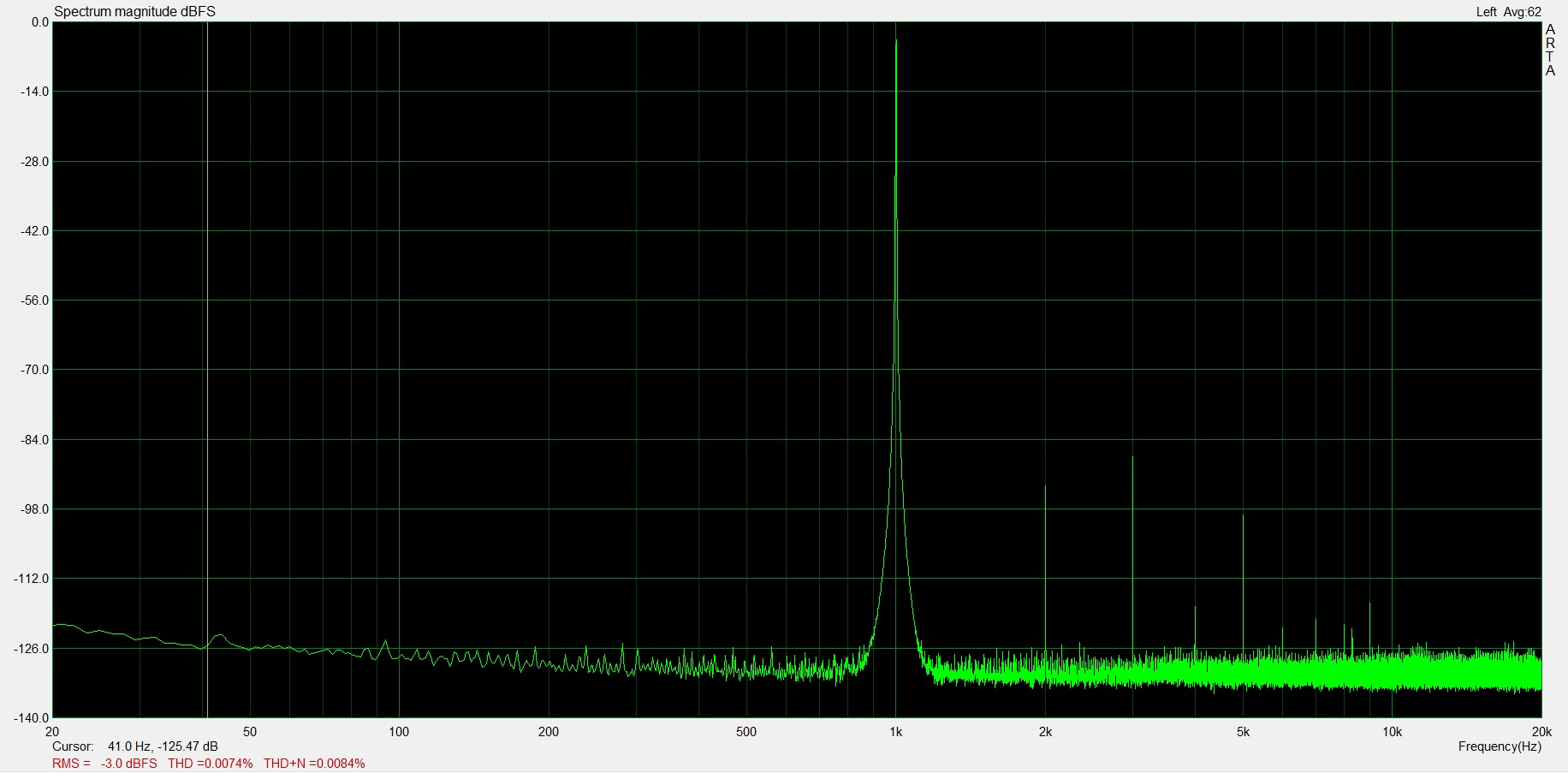

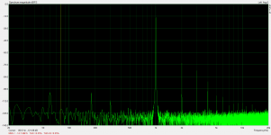

Attached is the distortion spectrum. Anything above 3rd harmonic is unmeasurable and distortion is <.01% all of the way up to the +-48V rails. This should be adequate for generating drive voltages to drive the EL34 all of the way up to where I want to test.
Next step is to construct the higher voltage B+ for further experiments with the EL34.
Note: the ~8.7k peak is some artifact of my measurement setup and is always present even without signal.
