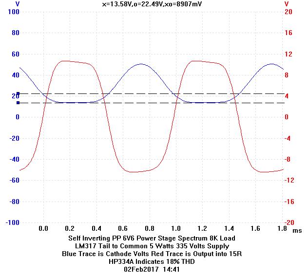

I am about to recieve some 6080's and some 6AS7's and I was just starting to think what I might do with them. I had a crazy idea to build a 2 tube PP amp. The idea would be to have a beefy single pentode driver stage (choke/CCS loaded) and then to do the phase splitting by taking the signal for one of the 6080 triodes from the cathode of the other. In this way it would be possable to build a complete stereo PP amp with just 2 driver tubes and two 6080's. If there wasn't a suitable driver pentode, how about using a ECL86 as the driver and maintaining the two tube approach.
What do you think of my chances of success. I understand that the 6080 and the 6AS7 can be very variable, even within the same envelope. I also understand that cathode bias is mandatory and that these tubes can bias up at wildly different voltages - sounds like a bit of a long shot to get this working, but what do you guys think of my minimalist idea?

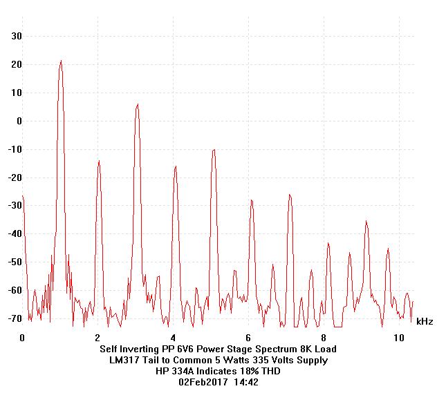

Many versions of the self inverting power stage have appeared beginning in the late 1930s. I did an exhaustive study of its performance in 2017. In any version of cathode return I could conceive of, the resulting amplifier failed miserably.
Measurements of the performance of a version using PP 6V6s was tried. The results measured with an HP334A THD analyzer & Pico Technology Spec A. No version was able to deliver more than half the audio that a normally driven cct would do. And the distortion at that point was usually something like 15%.🙁
The results are all summarized in a PDF report. If you would like a copy, let me know. If you do build, you will eventually need to use a normal inverter to drive whatever tubes you choose for the output.🙂
The tests showed that no matter what cathode tail was used the cathodes were never pulled down to less than about 13 Volts. Under that circumstance it was impossible for the following 6V6 to be ever driven to full power. That is the flaw in the circuit. See below.
Results measured were for tails of resistance, inductance, NFET & LM317 to Common. And all to a negative supply of 22.4V, attempting to pull the cathodes down farther. Some of the results are summarized in the spreadsheet.
The best results obtained were with the Hammond 5H choke returned to common.
The blue trace shows the cathodes are pulled down only to 13.58 Volts. But the positive going part gets way up to >46 Volts. The result is very unsymmetrical & causes much distortion in the output signal.
The measurement system showed 5 Watts ..... but 18% of that was harmonics. Something to think about.😀
The Wattmeter I used is a MetraHit 29S, measures volts, amps & phase to get real watts. The Spectrums, Etc by a PicoScope 12-bit (72db) virtual instrument, 10 MHz BW.🙂
