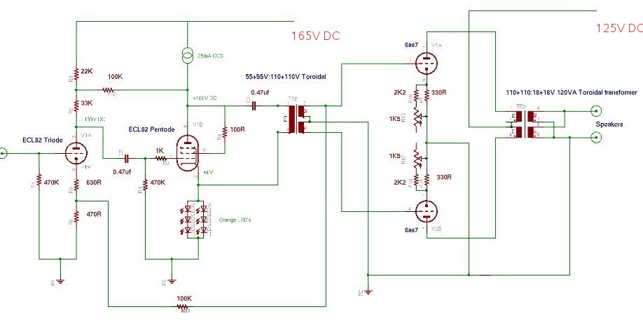

Shoog, I found your schematic
Your right on the button with the ratio's.
Thats not the schematic, I replaced the ECL82 front end with 5687. I also configured the interstage as a CTC and increased the parafeed cap to 4uf. Also the secondaries of the interstage need loading with a 100K resistor to stop ringing.
The frequency response is good but a little rolled off at the top end - this is the fault of the interstage rather than the output transformer. Response is down to 10hz. The roll off is pleasing rather than annoying.
Shoog

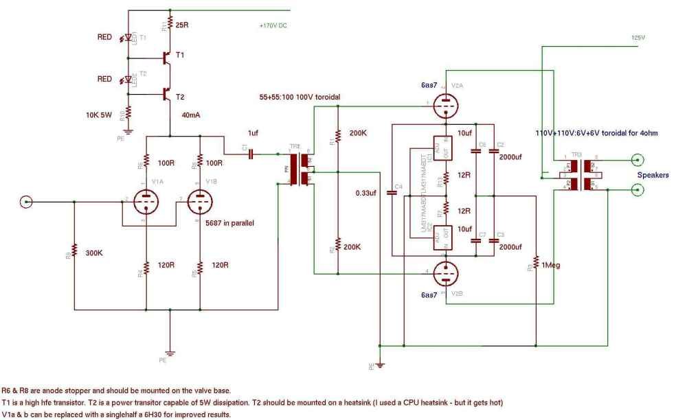

I have had recent success with moving the phase splitting transformer to the front end and using LTP from there on. I attach a concept schematic to show you what I mean, but I would be inclined to modify it slightly before going ahead and building it.
The best thing about this amp is the operating point of the finals 100V,100mA works really well - also the differential output stage is essential when using toroidals as output, which again work amazingly well.

If you need a mathemagical explanation I'm not your best tutor. I do a lot of thinking like this with my hands which I can use to pick up my handy reactance chart. It works for me. For any given frequency as you increase the number of turns and increase L, you also increase the AC impedance. For a fixed number of turns on a given core, as you lower frequency the Z will drop. The plate circuit of your driver stage wants a pretty high plate load Z, otherwise the dinky amount of plate current available won't be capable of creating a sufficient voltage drop across the coil.
Forgetting about frequency or any loading, if you have a plate swing of 100 volts at 10 mA, that primary winding has to look like 10K ohms. Now consider bass frequencies which require the most L for a given current. Looking at my handy reactance chart I see that 10K Z= a 30 Hy coil at 60 Hz. To swing 100 volts at 20 Hz from a 10 mA source would require about 85 Hy's.
As a power xfmer, if your 50 volt winding is rated at 50 watts at 50 Hz that is 1 amp. According to Ohms Law (not R's Law) that is a Z of 50 ohms. According to my handy reactance chart that coil is about 0.16 Henries. You are way on the short side of not enough L.
By cap coupling this winding to the driver tube plate you will get whatever voltage across it that can be developed with 10 mA. At 50Hz that would be about 0.5 volts. The waveform will be extremely distorted. Now add secondary windings and loading and this gets even worse. Try to reduce the frequency to 20 Hz and it gets even worse again.
You might be able to use this xfmer as an interstage but it would have to be cathode driven by a tube with a low output Z. Maybe another 6080 with sections parallelled.
