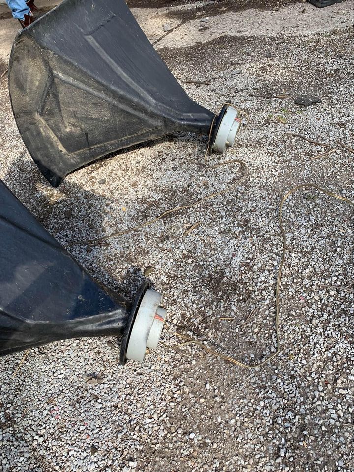

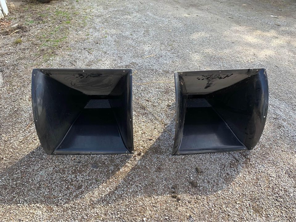

New find. Any guesses? I tend to think Community S&L but the pics I see online do not match. Seller wants $50 for the pair and includes RH CD3301 drivers.

I would buy them just for the drivers.
The horns are something special. If you measure them and add a DSP they may be usefull with some tweaking, Like laminating them from the outside to cure resonances. The should go quite low. Most RH drivers where 2-way capable.

The conical expansion PC264 is a flat front horn (circa 1999), the horns depicted in post #67 are radial semi-exponential horns with a round front edge.
