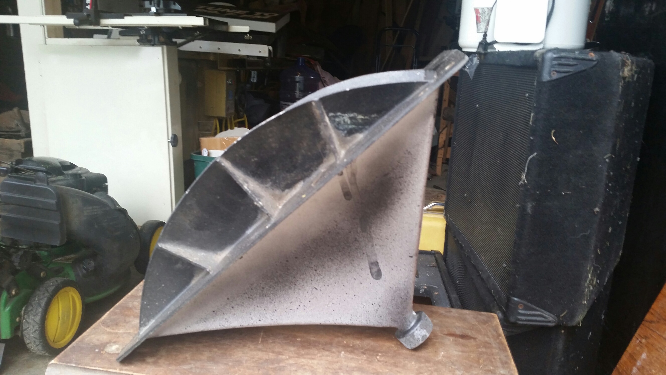

I agree. Looked at a few 8HD online and mine seems different. Pic attached. Mouth is 7" x 17". I am still kinda in shock how heavy this stuff is. Horn and driver are close to 10lbs each. In addition, the crossover components are equally massive to me. There is a capacitor in there that's larger than a D cell battery and an inductor which looks like a flux capacitor to me. 😀

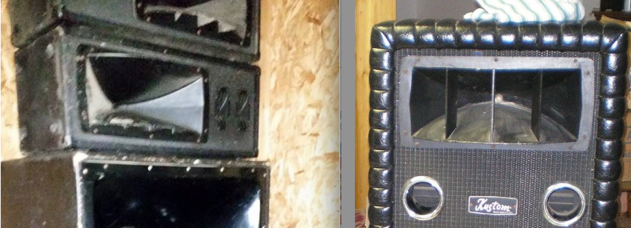

The EV 1824 would probably be a better mid driver than the D202ti, and the T35s (not T350, which was a "baby butt" type horn) you have would have more extended and wide dispersion HF, the old cast mid horn is probably quite beamy above 6 kHz.
I had not looked at the cast mid horn in the OP, it looks like the one Kustom used in their cabinets in the 1970s, only with the interior vertical ribs removed.

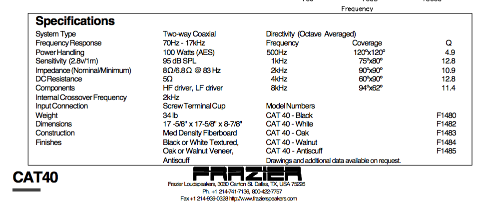

hey Art - what do you figure roughly is the crossover in a Frazier CAT40? - I''d like a larger version but don't know if practical
Spec sheet says 2000 Hz.hey Art - what do you figure roughly is the crossover in a Frazier CAT40? - I''d like a larger version but don't know if practical
wondering the slopes - it sounds very "coherent" and supposed to be time aligned - I'd like a tougher version - if sound quality could be preserved

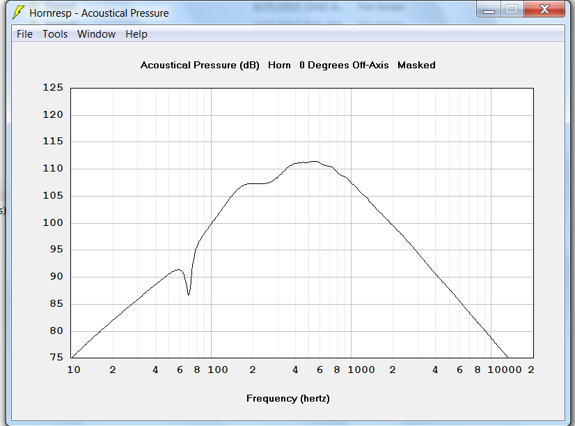

Any care to offer an opinion? Pic attached is EVM 15B vs Dayton PA380. Bold is EV and grey is PA. Sim is definitely suspect as it cannot be modeled correctly in HR but I am curious if it would worth another C note for the EV15Bs. Maybe I am OCDing but still learning... THANKS

If you are not planning to use subs below these, you should lower the tuning by about an octave to around 35 Hz. After doing that you can get a more realistic idea of which will work better, but according to the sim the PA380 is not going to have the midrange sensitivity of the 15B, assuming you have entered parameters correctly.Any care to offer an opinion? Pic attached is EVM 15B vs Dayton PA380. Bold is EV and grey is PA. Sim is definitely suspect as it cannot be modeled correctly in HR but I am curious if it would worth another C note for the EV15Bs. Maybe I am OCDing but still learning... THANKS
That said, the difference of 10 dB at 400 Hz seems far greater than I'd expect, re-check all your TS entries.
Yep; planning on a sub. I've rechecked the TS data more than several times and have confirmed with another member the offending piece of data is a very high Le for the PA380. Le for the PA380 is 4.12. Very odd to me. Typically I see it near 1.0 and if I change Le to 1 it sims much better, but still not as good as the EVM15b. What's crazy is there is a MCM Electronics driver that sims nearly identical to the 2220 but unsure of accuracy of the TS data. MCM Audio Select 15'' Die Cast Woofer with Paper Cone and Cloth Surround - 200W RMS 8ohm | 55-2963 (552963) | MCM Audio Select Would be tempted to give it a shot if you think it is a passable driver. That said, an all EV system would be very cool thing to me.
