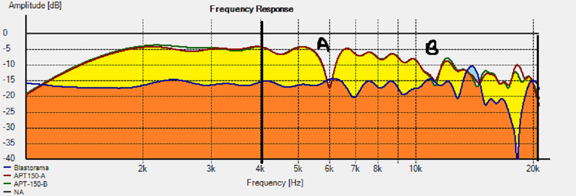

Ordered some inductors and APT150. Hooked the APT150's up and do not like them at all. Blah. What did I expect for $25?! 😀 I was hoping for a bit more extension... Anyone think the EV ST350 are much better than the T35? I like the T35 but it seems a bit mild, so if the ST350 is improved then that might be a way to go.
ST 350 probably won't be much (if any) improvement over the APT150, they are only a minor improvement to the T35.Ordered some inductors and APT150. Hooked the APT150's up and do not like them at all. Blah. What did I expect for $25?! 😀 I was hoping for a bit more extension... Anyone think the EV ST350 are much better than the T35? I like the T35 but it seems a bit mild, so if the ST350 is improved then that might be a way to go.
The APT150 would benefit from a bypass cap to bring the HF up to the mid level, without the bypass cap the top end is 5 dB down.
Zwiller,Thanks Art. Compression driver a better way to go? 1" Selenium 220 a waste of time?
Better in that you could eliminate the mid/high crossover point required when using the 1824 high mid drivers. Crossovers are the hardest thing to get right, especially right in the middle of your hearing's most sensitive range.
I have not heard the Selenium 220 driver, but there is nothing in the specs that would indicate it would be a step up in fidelity from the APT tweeters. I used the APT80 in monitors, sounded good, though had inconsistent response from unit to unit, same could be said of the EV T35.
I'd suspect the hard chines on the APT150 horn cause more diffraction effects than the smooth exponential APT80 flare, which also does not require as much HF boost (or mid cut) as the constant directivity APT150.
The APT150s definitely need a bypass cap to bring up the HF. They should also not be used below 3kHz or so (at least the manufacturer says so), even though they measure quite flat on-axis to 2kHz.
If used with a "normal" HP filter, they'd probably sound like crap. All shriek with no "top".
Not that they're perfect. See that BIG suckout @ 6kH? That's a DRIVER issue, and not caused by the horn. It was still present when I measured the driver alone. And that's why I opted to use different drivers for my design (I kept the horns 🙂).
