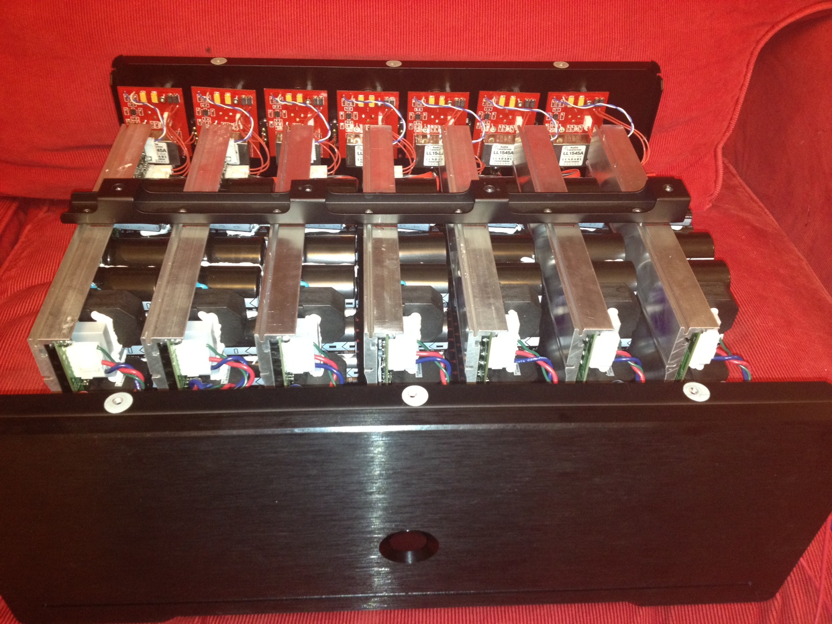

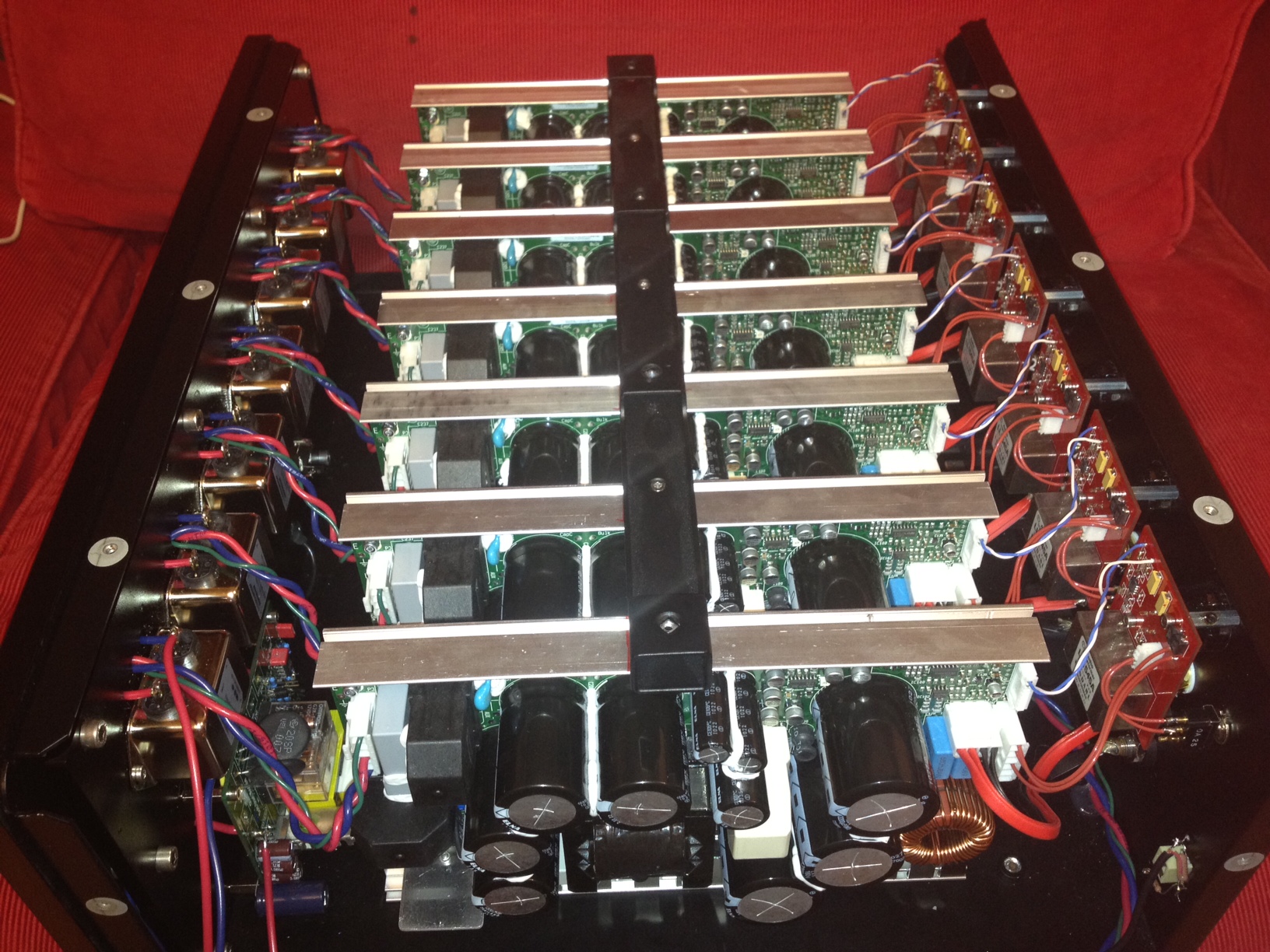

my small AV amp progress:

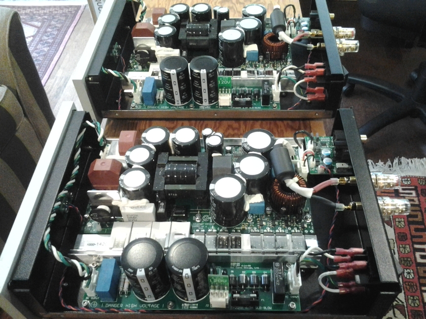

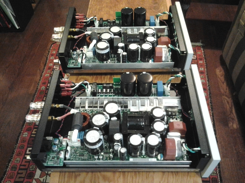

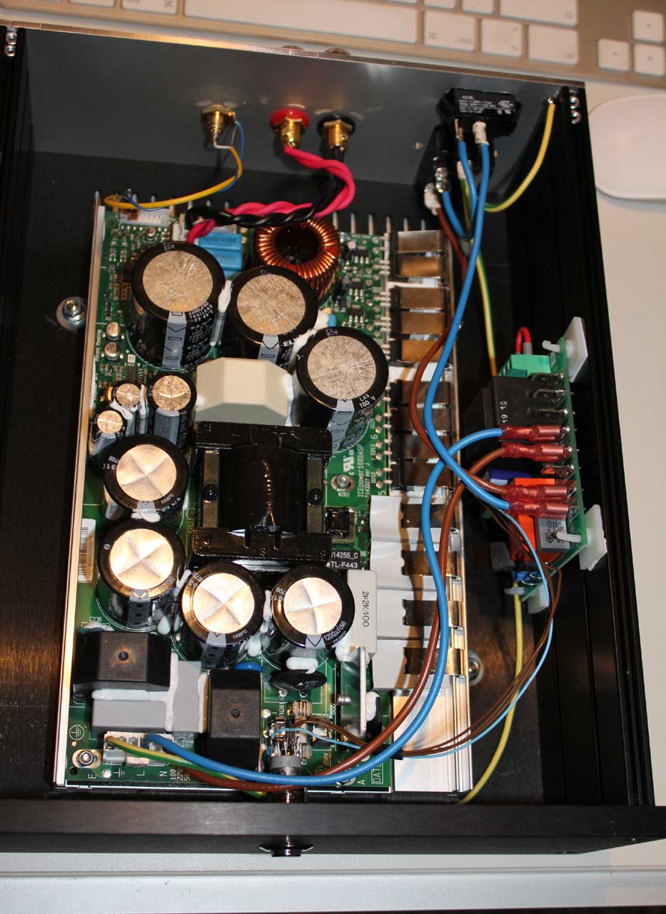

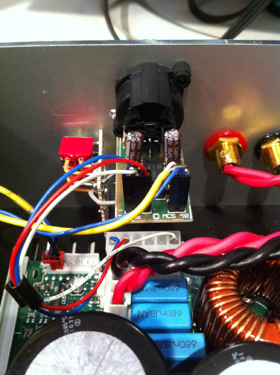

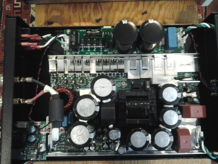

More info related to the Bel Canto AC Input Board...
According to these articles, if you connect the output of a PFC to AC input of ASP1000, would it work?
The PFC output 385VDC, does not affect the input circuit (oscillator) of ASP1000?
That 385v seems to work based on the pictures of the Rowland amps.
The Bel Canto board likely produces closer to 320v based on this article and circuit from Wikipedia:
Rectifier - Wikipedia, the free encyclopedia (see Voltage-multiplier rectifier section)
File:SwitcheableRectifier.jpg - Wikipedia, the free encyclopedia
Anyone gotten any more info on the Bel Canto board other than what the Wikipedia article implies. I did get these pictures from someone who had one of the amps, but no more info than that. Still looks like a pretty simple mod, but I'd really like to get my hands on one or get info from someone who has before risking my modules.
Greg in Mississippi
P.S. Best as I can tell, the Bel Canto board matchs the full-wave bridge voltage doubler circuit... my guesses based on the pictures are that it contains:
1. An input filter cap (black .33uf 250v x2 cap)
2. A fuse
3. 4 rectifier diodes for a full-wave bridge
4. A couple of high-voltage (200v?) electrolytics
5. A jumper plug to set 120v or 240v operation (voltage doubler or regular rectifier)
6. A couple of bleeder resistors
7. An output bypass cap
But there are a couple of small components between the rectifiers and the first cap that I can't make out... one looks like a surge protector, but funny to see it so far downstream. The other I can't make out at all.
Can anyone get to to one of these and get more intel?
