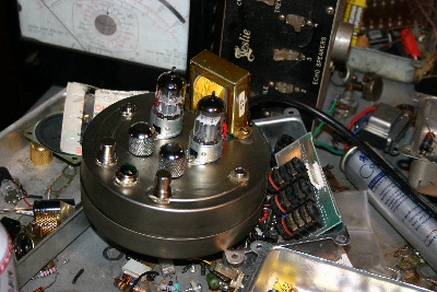

Look for the classic, and elusive Altec ring of three circuit, Neve and others use it.
Built a tube version years ago. No need for a xfrmr...
