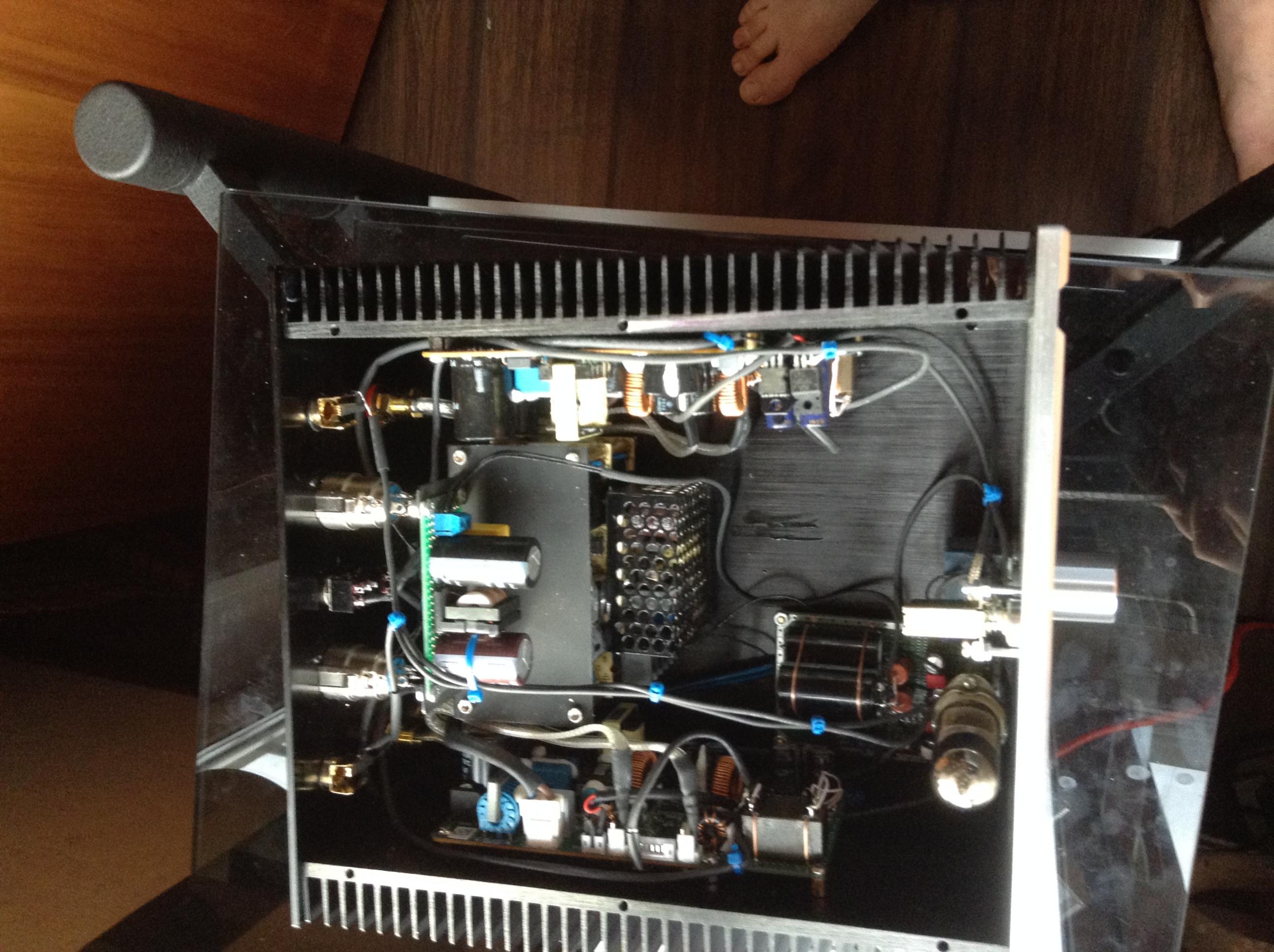

I used modules SE BTL mode. Need ustonovit moschny jumper between two negative outputs of the module.
In its implementation of the buffer I applied on the lamp fahoinvertor Lundahl transformer.
Impressions are the best.

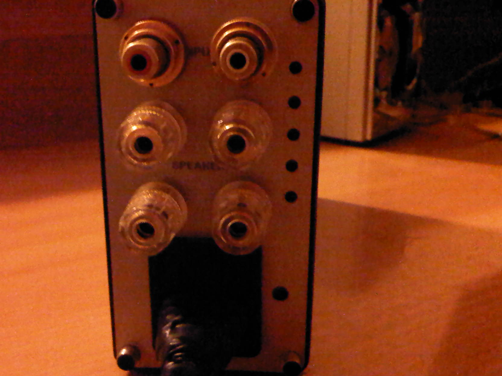

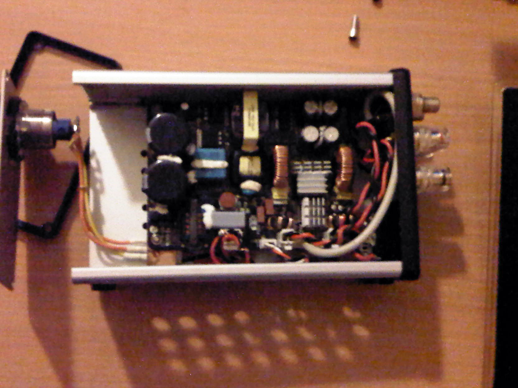

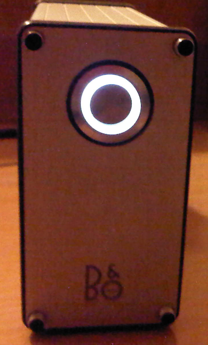

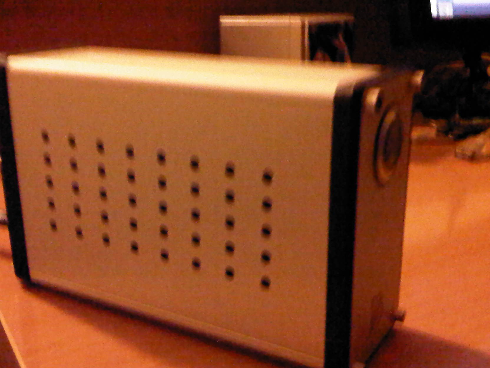

Some photos
Some of enclosure photos for 50asx2. sorry for bad quality

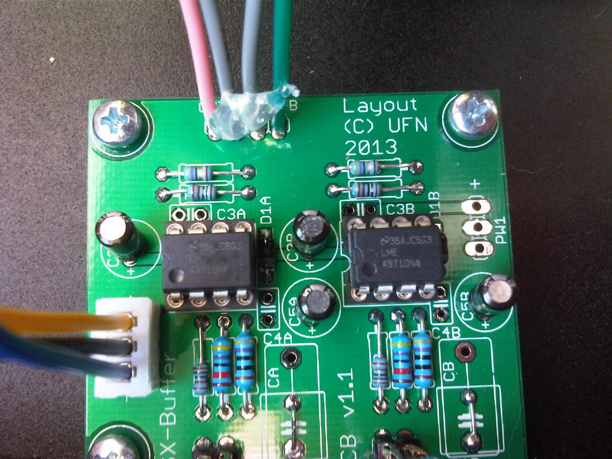

I've just finished connecting an 50AX2 SE module, ASX buffer and +-12V linear PSU.
Buffer is Nisbeth design using LM49710 OP amp :
https://theslowdiyer.wordpress.com/2013/09/02/project-files-opamp-buffer-for-icepower-asx-modules/
PSU if from diyinhk :
Classic Reference 78xx power supply linear regulator 3.3V 5V +-12V - DIYINHK
Sound is very nice and detailed 🙂
Definitly those 50ASX2 modules need an input buffer !
There is no caps at at the input buffer the amp being connected at the output of my Najda DSP.
I will evaluate the sound inpact with caps in few days.

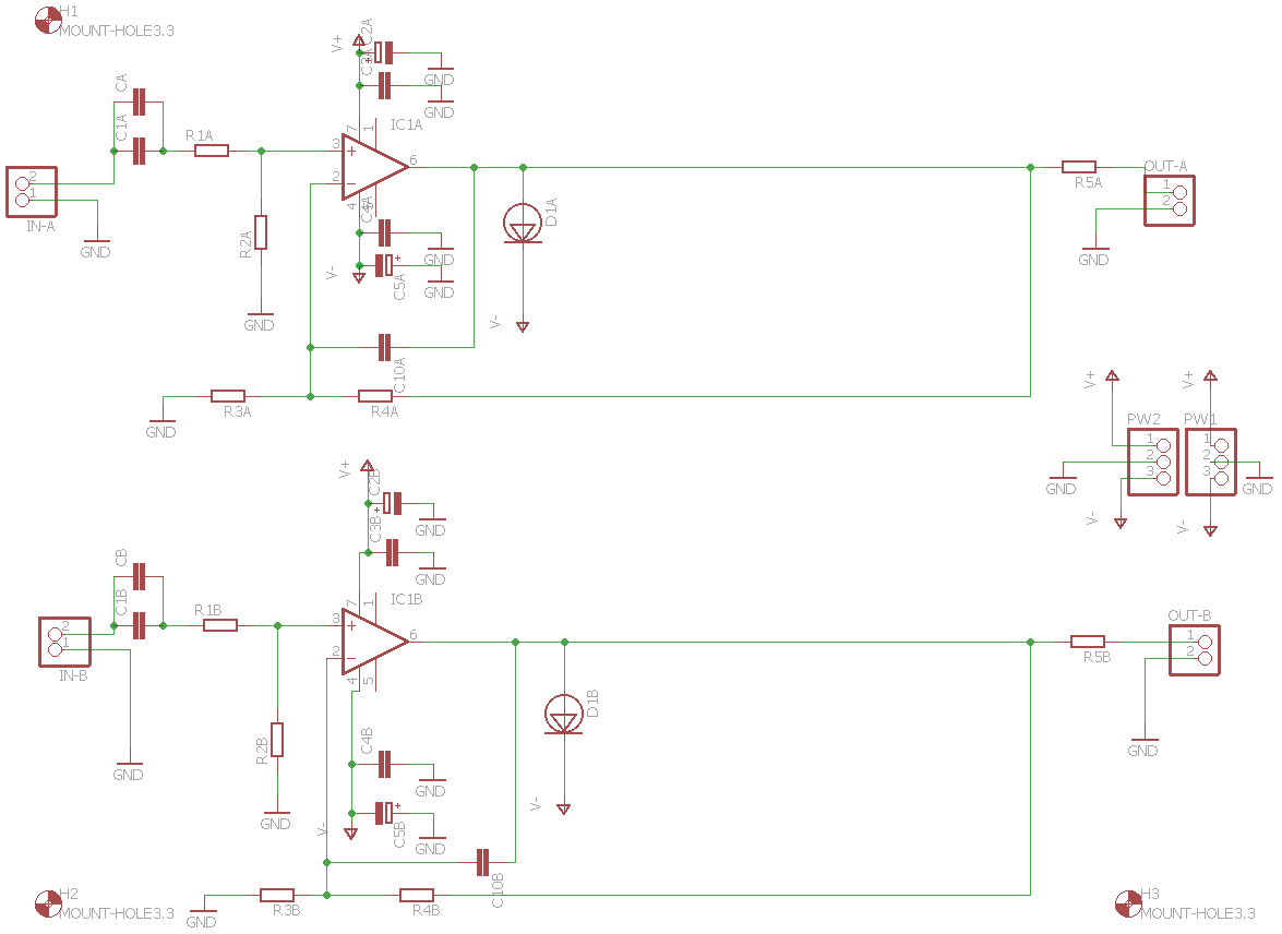

See below the schematic and the component values of the buffer.
I was wondering if I must put R5 because as I HAD read that the input impedance of the module is not constant.
I've shorted it on the PCB and sound seems better, less sweet but subjectively more natural.
Any advice concerning this part (R5) ?
Part List
C1 1uF - 2,2uF -> short
C2 10uF
C3 100nF
C4 100nF
C5 10uF
R1 470R
R2 47k
R3 1k
R4 1K (R4 sets gain G = 1+(R4/R3) -> 2)
R5 47R
D1 1N5296 (0.91mA CRD)
C10A 100pF (1206 SMD)
OUT JST XH or similar PINHD-1X3 1X03 PIN HEADER
PWR JST XH or similar PINHD-1X3 1X03 PIN HEADER

The 50ASX2 two channel amp with ASX buffer is finished, ad working nicely 🙂
I will add a second 50ASX2 module and buffer in the case in few weeks.
Value used for R5 is 0 Ohms (short)
Value used for C10A on my board is 100pF (1206 SMD)
Some readings recommend a value around 40/50 pF.
The aim of this cap is to prevent OP amp from oscillating cf.
Working with Cranky Op-Amps
