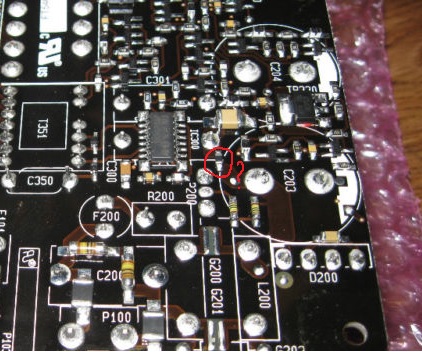

So is there any result from using the 50ASX2 stereo module in BTL mode. I am thinking of buying one for powering an active sub in case I can't fix the internal amplifier.
Has someone checked what other components besides the outout choke where omited on the BTL version? While I can see that a big inductor saves cost I am not so sure about other parts.....
Ingo
In reviewing the 50ASX2 documentation and some images of the circuit board it looks like the jumper selects how the seond input side of L403 (channel 2 choke) is connected. In the SE version it is GND and in the BTL version it is the output of channel 1. See page 25 of the PDF document. This effectively bridges the output available at P104. You the could remove L402 and P101. But if you don't connect anything to P101 you might as well leave them alone.
I think this is all that is required to turn a the SE version into a BTL version. The inputs in BTL configuration calls for an external inverter for channel 1 to drive the module as shown on the same page. So there shouldn't be any configurations required on the module itself.
I am sure B&O doesn't want you to solder on the board and that is why they don't recommend you doing it but I doub't their statement "it can't be done"
Ingo
From the Icepower 125ASX2 documentation:
"When the amplifier is used in BTL mode, the BTL sync pin must be pulled low (0V). By setting the BTL sync pin low, it is ensured that the switching frequencies of the
two separate amplifier channels are tied closely together for optimized THD performance."
The 50ASX2 module lacks a BTL sync circuit. Perhaps that is why B&O doesn't recommend
configuring the SE module for BTL operation.
doublestop, the 50ASX2 data sheet shows specifications for BTL operation. B&O stated you can't reconfigure the module yourself from SE to BTL. However, B&O sells a BTL version and a SE version. There are two different part numbers.
Maybe the 50ASX2 doesn't use synching or there is a 0Ohm resistor that needs to be placed to turn on synching for BTL?

I find only small photo! What is element ?
