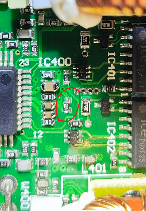

Hello All, Here's my 2 cents worth about the SE to BTL conversion (as I also posted on Nisbeth's slowdiyer):
Just a couple of FYIs: I just replaced a BTL version with a converted SE (just changed the W40x jumper) in my Gallien Krueger MB115 bass amp and it seems to work. Double the voltage across P104 vs. each side to Ground, but I haven’t listened to it yet or made any measurements. The W40x jumper is what reconfigures the outputs so that they both appear on P104. I don’t think it has anything to do with the sync.The only other difference I could see between the two types is that the BTL has a 560 ohm sm resistor in the middle of the group of sm components between IC400 and IC401-402 whereas the SE has a resistor which is marked with what seems like a 0 (it’s a tiny square). It also looks like the 560 ohm was hand soldered, as was the jumper .Maybe a clue about the difference.

A couple of further things: I measured the two resistors in question and they are, in fact, 0 and 560 Ohms. Also, I looked at the magnified photos of both types on eBay,etc. and they all correspond to what I saw with my two amps. At least on the top side. I couldn’t find any clear enough photos to check the back side and I already installed the converted SE amp in my bass amp and don’t feel like taking it out again (right now anyway). 🙂

Zombie thread I know but I have three SE modules. I have modified one using the 400/401 link and it worked well in a small bass combo. I have now built an extension cab and will install the other in there. I will investigate the changing the 560 ohm resistors If I can find them. I suspect they may have something to do with the sync functions.
On the transformed SE-->BTL(w40x jumper) I studied THD+N 1kHz with the resistor 0 soldered out (SE version), connected the variable resistor 0-5KOhm. By smoothly changing resistance from 0, I saw that at a value close to 560 Ohms and above, the sharpness of THD+N 1kHz(load 4 Ohm, balance input) improve from 0.01(2)% to 0.004(5)%. Further increase in resistance does not change THD+N.
I don't understand why in the photo of the factory BTL version SMD with the inscription "560" - it is 56 Ohm, but in fact it is apparently 560 Ohm (BluesAholic measured it). I install SMВ "561" = 560 Ohm in foto Attach

Just re-read this thread after all these years because I'm having a bit of trouble with my SE to BTL converted module (to be investigated).
But Rawamps comments made sense and caused me to wonder about my measurements. So I re-measured the questionable resistor and it is 56 Ohms. I used a 4 1/2 digit DMM both times and realized that my mistake was not noticing the leading zero, Bah!!
Judging from Rawamps clever trick with the pot, it doesn't seem to matter much. But I just wanted to correct my mistake for the record.
