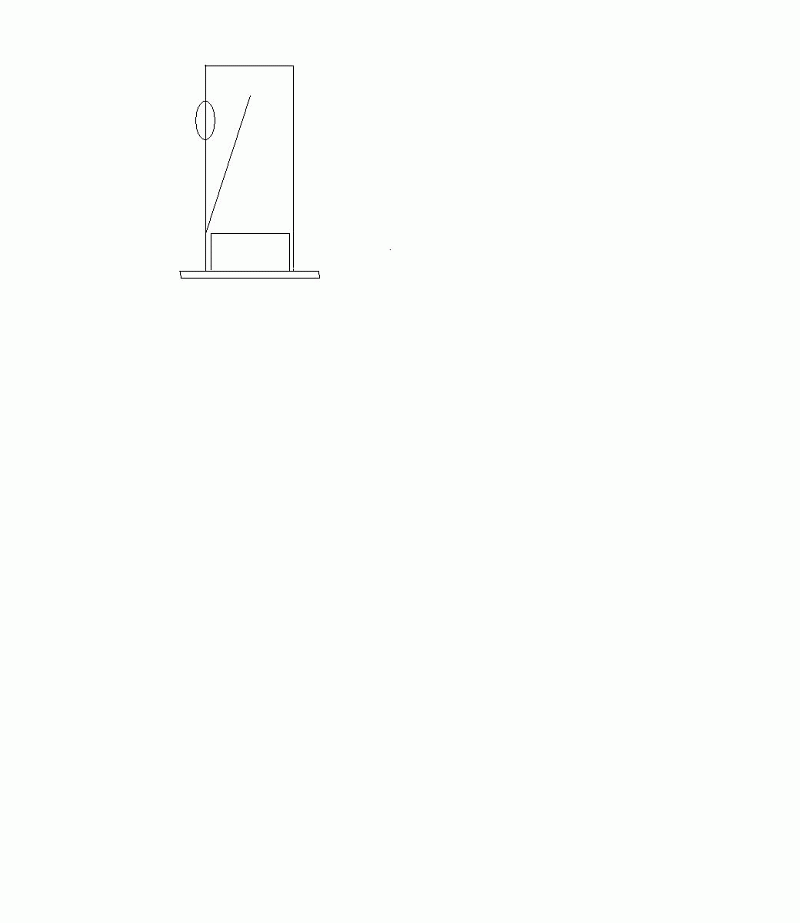

Isn't the Voight Pipe a 1/4 wave and the BIB a 1/2 wave enclosure? Is there an advantage of one over the other? I would like to use a enclosure like this for the 4.5" hemp acoustics that will be available one day or for a pair of FE127Es. Just looking for an opinion. I am limited in available space in my listening room but I would like to try a BIB with a small driver like the 127E. I will post a diagram of my other idea. Maybe one of them has merit.
Here is another idea. It is not to scale and obviously my skills in Paint could use some help🙂. The front and rear baffle would be extended to mount to a base plate with cutouts on the side for venting. Maybe it should just vent torwards the nearest corner? I know that this is similar to the version using the Karlson slot but I get the impression that the slot tuning fro a Karlson is more luck than solid formula.
That's what Supravox do. Someone suggested a similar layout on the main BIB thread if memory serves. Classic corner-horn layout.
Karlsons aren't entirely luck -but mostly are at present. 😉
G said:Here is another idea. It is not to scale and obviously my skills in Paint could use some help🙂. The front and rear baffle would be extended to mount to a base plate with cutouts on the side for venting. Maybe it should just vent torwards the nearest corner? I know that this is similar to the version using the Karlson slot but I get the impression that the slot tuning fro a Karlson is more luck than solid formula.

Looks like a vofo to me, that is if you really mean the driver to be in that position. Check out my website if you want some dims.
Hi Scott
In the supra design the driver rear fires off into the void which to my mind creates too many I/f waves to be predictable. just a thought!.
Regards
Ed
Someone commented a while back that they thought the terminus on the design was a little small. My experience with the original BIB design is that they are prodigious bass producers and the terminus has to be heavily restricted to keep things in proportion.
Restricting the terminus also helps smooth things out.
Shoog
Shoog
vitalstates said:Hi Scott
In the supra design the driver rear fires off into the void which to my mind creates too many I/f waves to be predictable. just a thought!.Ed
Hi Ed
It was the vent layout I was primarily referring to. No argument from me though -the driver positioned like that is a bad idea IMO. Yet another reason why so many of the old folded TQWTs were rubbish. Too much HF leakage down the rear of the line, right where you don't want it. Not good. Worse, those Supravox cabinets (which I suspect were based on the old Weems calculations, which were never much cop) don't have anything like enough volume for the driver.
