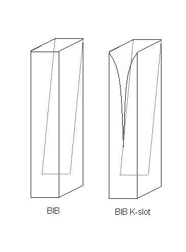

planet10, can you elaborate more on the suprabaffle in your iBIBk PDF?
I am not sure how to make it. A circle seems a bit more obvious but an oval might need a little approximating with a jigsaw and a bit of sanding. I'm not sure how great this approach is, however.
I also don't fully know why a suprabaffle works. I was looking at some of your other posts from a year or two ago with the Olson graphs of various shapes and baffle diffraction. I didn't see anything about an oval as used here. I also was looking at http://t-linespeakers.org/tech/bafflestep/index.html and determined that from these two sources, a sphere, or at least a circle is a really good shape for a baffle.
Finally, I'm confused as to why the fill-in suprabaffle pieces are used behind the suprabaffle. Perhaps they complete the rounded area of the suprabaffle to more closely mimic a sphere shape.

A circle would be fine. A square would be fine. Etc. An ellipse just spreads out the distance from the driver to the edge. A supraBaffle pushes the frequency at which baffle step happens down in frequency... if it gets low enuff it can then hand off to a rear or front horn with more than unity gain, or with room gain, so as to acoustically battle bafflestep.
In the iBIBk the size of the supraBaffle is a SWAG.
If you look at the Olson graphs you will see that one of the worst shapes is the driver mounted on the end of a cylinder. This is what a flat circular baffle is. By rounding off the edges and by adding a trainling edge we push the circlular baffle closer to a sphere.
Olsen never made an elipsoid (in those days they actually had to build it and measure it), it is as good a shape as a sphere, maybe better. Look to the research B&W did to come up with the shape of the midrange pod in the Nautilus.
dave
By making the baffle "not" perfectly circular you distribute the frequency which is effected by the edge effect over a wider range. A perfect circle will produce a definite dip at the frequency at which the baffle effect disappears.
I use a circular baffle but mount the driver off centre in the baffle.

Just so I am doubly sure before I waste any wood...
If splitting the Karlson slot in half to put on each side of the enclosure instead of just the back, what does the shape look like? Would the cut just not be as tall? I assume the shape has to be the same, as that's the whole reasoning behind the slot and how it's calculated.

For half a Karlson slot, drop a line vertically from the point to divide the slot in 2... same height, the side facing the wall is the straight line you used as a bi-secter, and the curved part is one side of the whole slot.

Hello all !
it's been a while since I visited full-range !
Good to see y'all thinking of implementing a K-slot in a Voigt or BIB
last year I build a pair of Voigt pipes using a K-slot at the bottom.
It seems to me the extra gain in the bass region comes in more
gradual using an exponential slot as opposed to just a square hole.
The normal hole is more like an "on/off" device; as bass goes deeper,
the extra gain comes in at a certain point.
K-slot seems to blend that point
But as I understand the theory of K-slots, thats not the intention of
an exponential slot in a pipe. It's about killing the odd harmonics of the
frequency at wich the pipe resonates.
Wouldn't the proper use for the benefits of an exponetial slot be like in
an organ pipe ? e.g. at the back, to 2/3 length of the pipe ?

The only graph I have of a K-slotted lioe is for Roger Sander's Speaker Builder 3 meter t-line loaded with Eclipse W1038R. There wasn't much polyfill in the line.
The K-slot had double the area of the rectangular vent. I didn't have any wood scrap so cut the curve down to the existing vent so it probabaly came out with too much area. I wish iI had thought of turning the cabinet on its side to see how that affected the plot versus standing upright.
Modified line
http://img214.imageshack.us/img214/256/ktlle9.jpg
Response outdoors with W1038* (~20Hz fs) polycone 10" woofer
http://img176.imageshack.us/img176/7710/kslottline1038rhf2.gif
subjectively this T-line loaded with Eminence Beta 10CX sounded better, smoother with the K-slot although comparison might be difficult unless input Z was adjusted to be about the same for both conditions.
it might be a good idea to make removable panels to adjust the slot to taste

Greets!
No, you don't want to 'kill' its harmonics, but instead make them all equal amplitude with the fundamental without resorting to using any stuffing, i.e. a broad band (low Q) resonator. With a BIB you have both even and odd harmonics, so the K-slot should in theory make an even smoother response if done properly, with 'properly' meaning it must be a lot longer/bigger for a given Fc (Fp). Also, due to the lower pipe loading, in theory a higher effective Qts will be desirable.

I built the iBIBk as drawn by Planet10 using Fostex 127e.
I can't believe the bass coming out of the 4.5" Fostex driver on this enclosures.
As for the Karlson slot, I used 11-1/4" high half slot on the side and raise the speakers by 1.75" off the floor.
I will experiment with the height of the opening at the bottom of the speakers and post my findings.
