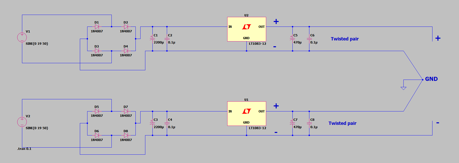

I recently purchased the OPA861 Balance I/V
I have a few LinearPI Mk2's and am trying to configure them for +5 -5 V for the output stage
So both Linear PI's are setup and output 5.06V normally ( they are fed from a bench regulated 12V DC supply)
When I connect the V- of one Linear Pi to the V+ of the other, I see +2.5V on the positive side and - 1.33V on the negative side from the outputs?
Will this configuration not work with a DC Source?

Why would you connect V- of one supply to V+ of the other supply? If they are both driven from the same bench supply, why wouldn't that cause a problem?
The manual says:
"A 7V-9V DC power can also be used as input. The connection will be non-polarity. DC power must be totally isolated. Never share ground with other power supplies."
It sounds like you are doing more or less what the manual warns you not to do. If you only have one bench supply, then you should only power one Linear_Pi with it, otherwise the two supplies will not be isolated from each other in terms of DC input power (and the DC supply should have a floating output, otherwise it will be connected to the AC line ground).
Also, 12v DC input is too high a voltage according to the manual. It shouldn't be more than 9v DC.

Because the iv board needs (+5) 0 (-5)Why would you connect V- of one supply to V+ of the other supply? If they are both driven from the same bench supply, why wouldn't that cause a problem?
Then you should power the Linear_Pi regulators each from its own separate transformer winding (don't use a center-tapped winding or you won't have isolation), or power them from two totally isolated floating DC supplies. Otherwise it won't work.

You shouldn't need Ian to tell you the supplies aren't isolated if they share the same DC input power. There will be conduction path through the rectifier diodes if you connect the outputs together from + to -, which means you might damage something.

If I use a Hammond 1182 Series ( or similar) can I use the two 6 Volt secondaries independently for this? and then presumably can't also use those same secondaries to supply another 2 linear pi's doing 3VDC for DAC & Clock and 5VDC for Station Pi. I will need another similar transformer for the Linear pi's doing 3V and regular 5V?
Could I take a +5VDC and GND from the +/- Supply for the Station PI input or would that create imbalance issues?
last question - what's the recommendation then for grounding the staton Pi and FiFo Pi etc?

Its pretty simple. Each Linear_Pi needs to have its own transformer winding. If a transformer has two secondary windings, then that's enough windings to power two Linear_Pi power supplies. If you have more than two Linear Pi, then you may need more transformers so that each Linear_Pi has its own secondary winding. Never break that rule, and it should work (unless you already damaged your existing Linear_Pi supplies by connecting them up wrong).
Also, each Linear_Pi DC output should to use a pair of twisted wires that go the the load board. Only connect the grounds together at the load board, not at the power supplies. This will avoid "common impedance distortion" on your power rails which could be caused by using a shared ground wire from the power supplies. Understand?
It would be kind of like this:
Except you are using Linear_Pi so you don't need the power supply internal circuitry shown above. Each generator on the left side of the diagram, V1 and V2, represent separate transformer windings. The wires marked "twisted pair" go from Linear_Pi DC outputs to the circuit you want to power.

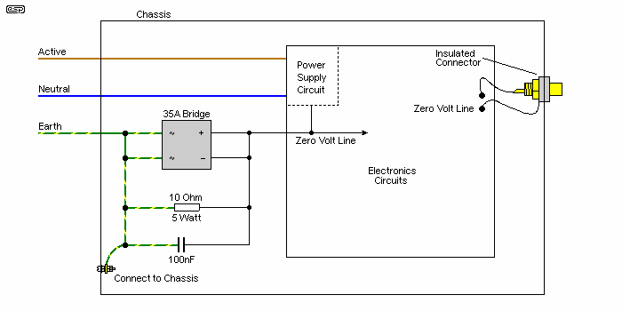

Now, to connect your whole system to earth ground, you should use a "hum breaker" circuit, something like this:
