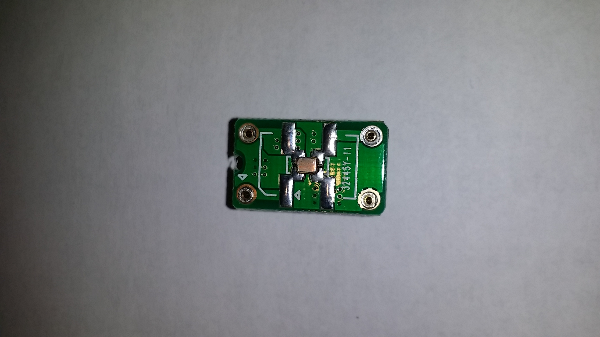

clock decoupling
agreed, diyiggy
I will take the next step to install the .68uF FCA cap I have on hand. Just moving a little slowly. As many will point out, its easy to think you hear something and then later wonder if you imagined it.
But what I believe I heard clearly over a couple of sessions was:
1. a clear improvement after removing the ceramic caps on the 45mHz clock which is the clock used predominately. But after a fair bit of listening and clearly letting the system warm up it still felt like there was a little edge that should not be there.
2. so I followed your advice and removed the caps on the 49mhz clock. I believe the sound cleared up at both speeds. But now we are in the range of easily imagined improvement so I look forward to hearing it again and then trying the FCA cap.
agreed, diyiggy

NDK SDA clock caps
continuing to follow diyiggy recommendation to remove 3 ceramic caps from bottom of clock adapter PCB, I took the next step and added a 0.68uF FCA cap on the bottom of the board. I now have the .68 FCA on the solder pads on the bottom and a BG HiQ NX .68uf on the top. No question it brings out the full potential of the NDK SDA clock. I'll say more once I have listened for a few days, but initial impression is this is well worth the effort.

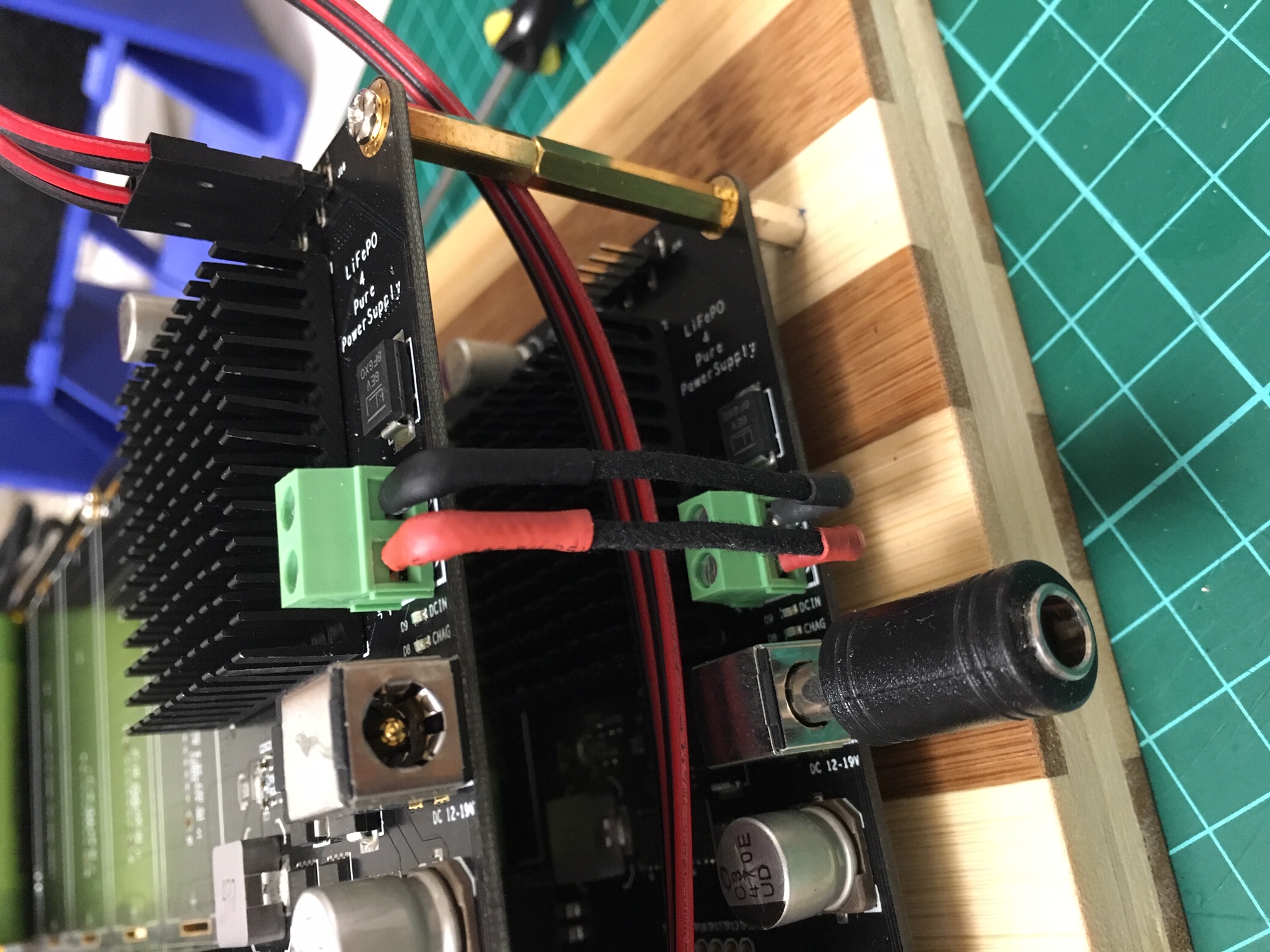

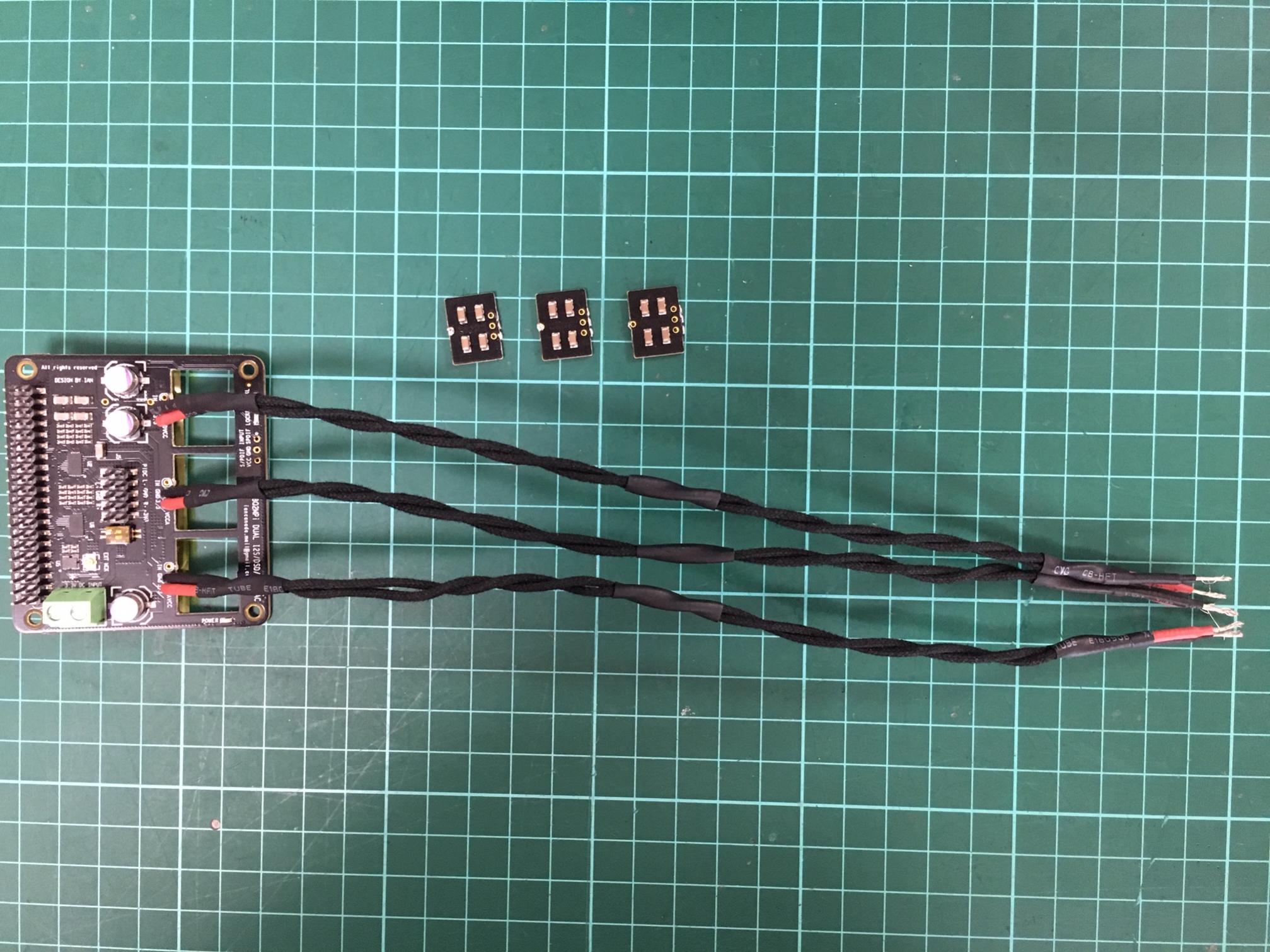

Taking it to the next "level"
Okay, time to go to the next "level". Pretty straightforward. Just need to triple-check all connections for shorts and polarity.
Wires are Duelund 20awg tinned-copper. Solid-core wire is probably easier to handle but I have the Duelund on-hand.
Need run-in before any observations can be made. Too many options too little time.
