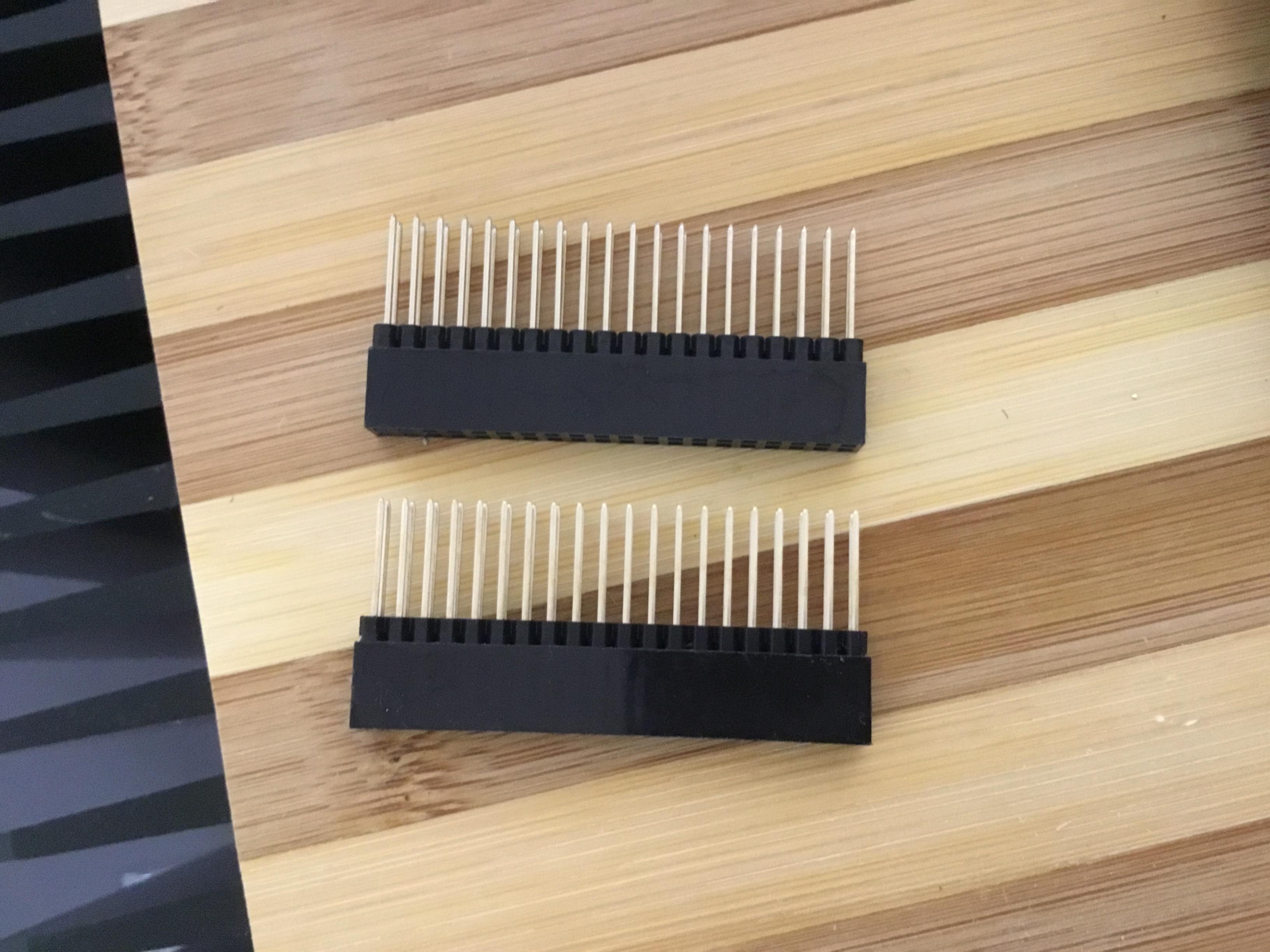

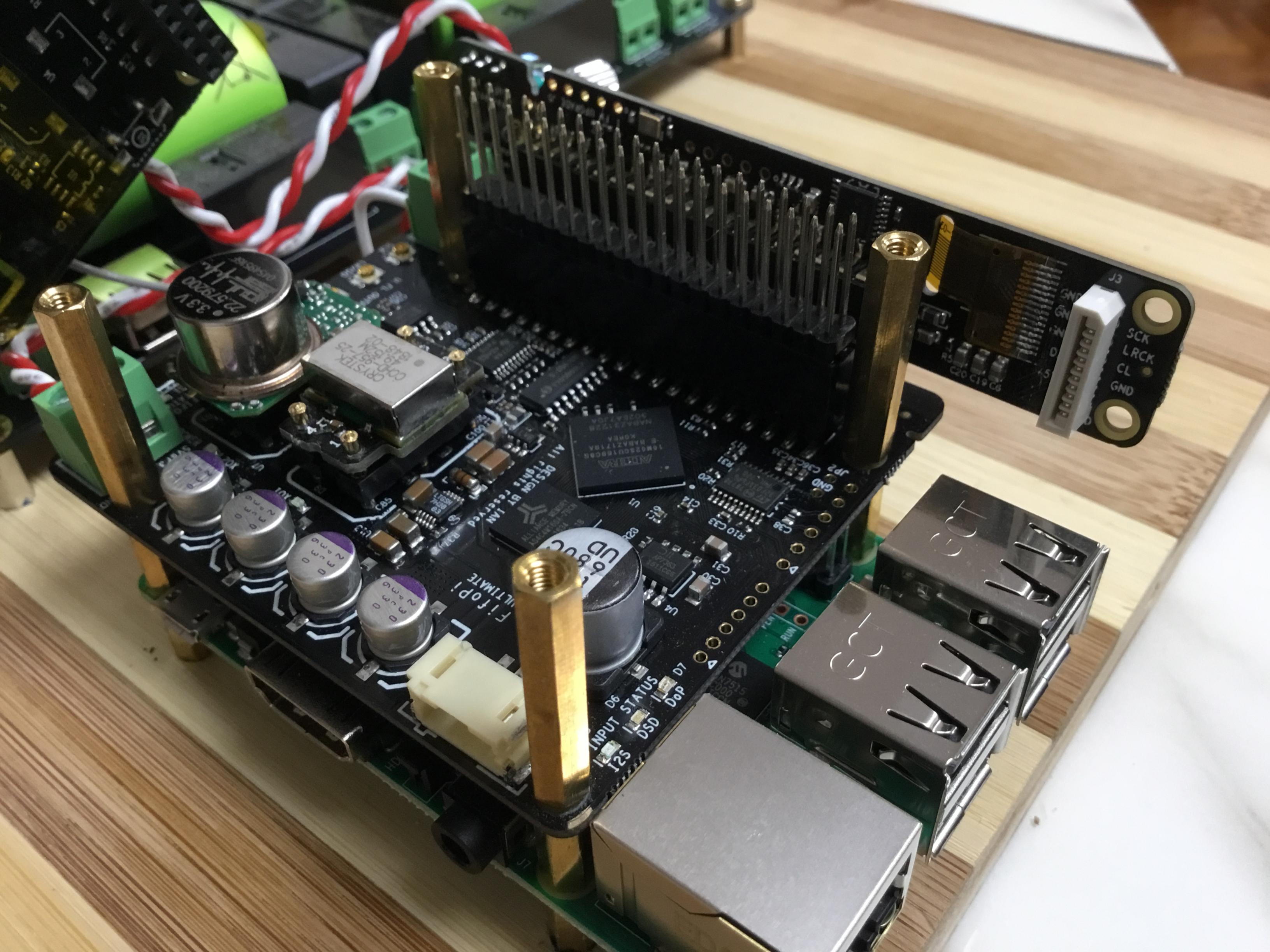

Experiment with Clocks
The fifopi can use different clocks which is a great way to tune the sound. I did some quick experiments recently and would like to share some observations here. Please understand that the system is currently running-in so things could change, thus please take my observations with a grain of salt.
First off, I have both versions of Ian's clock adapter boards. The old one that can mount both NDK and Crystek, and the new Crystek-specific version. I have Crystek mounted on both versions of the adapters and they sound different!
Generally speaking I found the old one to sound a bit more spacious with more high freq components while the new one is smoother and fuller. This could be caused by the different number of caps in the adapters (3 in old, 7 in new).
Next I tried to use Pulsar Clocks but they don't fit as they are too tall. I ended up buying a GPIO stacking extender (see photo) to increase the height between the fifopi and the dac hat. With that there is sufficient space to install the Pulsar. Note that the Pulsar does not support enable/disable which the fifopi requires so only one clock can be used (mine's the 22Mhz one).
Comparing to the Crystek on new adapter the Pulsar has stronger mid-bass and perhaps more extended highs. The whole presentation sounds more tidy and controlled. The Crystek has more treble presence and thus sounds more spacious. One is not necessary better than the others and it will be up to system matching and preferences. In my system for my taste I prefer the Crystek over the Pulsar.
And then I thought perhaps the extra stacking extender may affect the sound so I put back the Crystek and indeed it does not sound as good as before. Well, off the extender it goes and then the Crystek clearly sounds better w/o it, with better resolution and micro-details.
This means the Pulsar could have been handicapped by the stacking adapter but alas it cannot be used w/o it.
