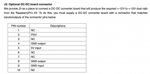

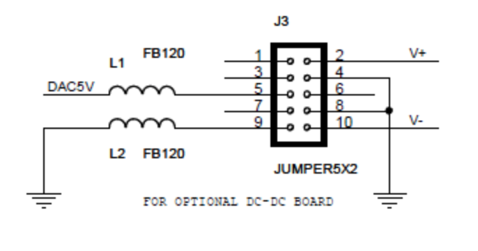

Optional DC/DC converter on Standard I/V board
If somebody plans to use the DC/DC converter socket on the Standard I/V board, follow the pin designations in the schematics. I believe those indicated in the manual are wrong.
Note that current is taken from the FIFO rail (not the RPi rail) so beware that you might only have 3.3V available if you are using batteries direct to supply the FIFO.
