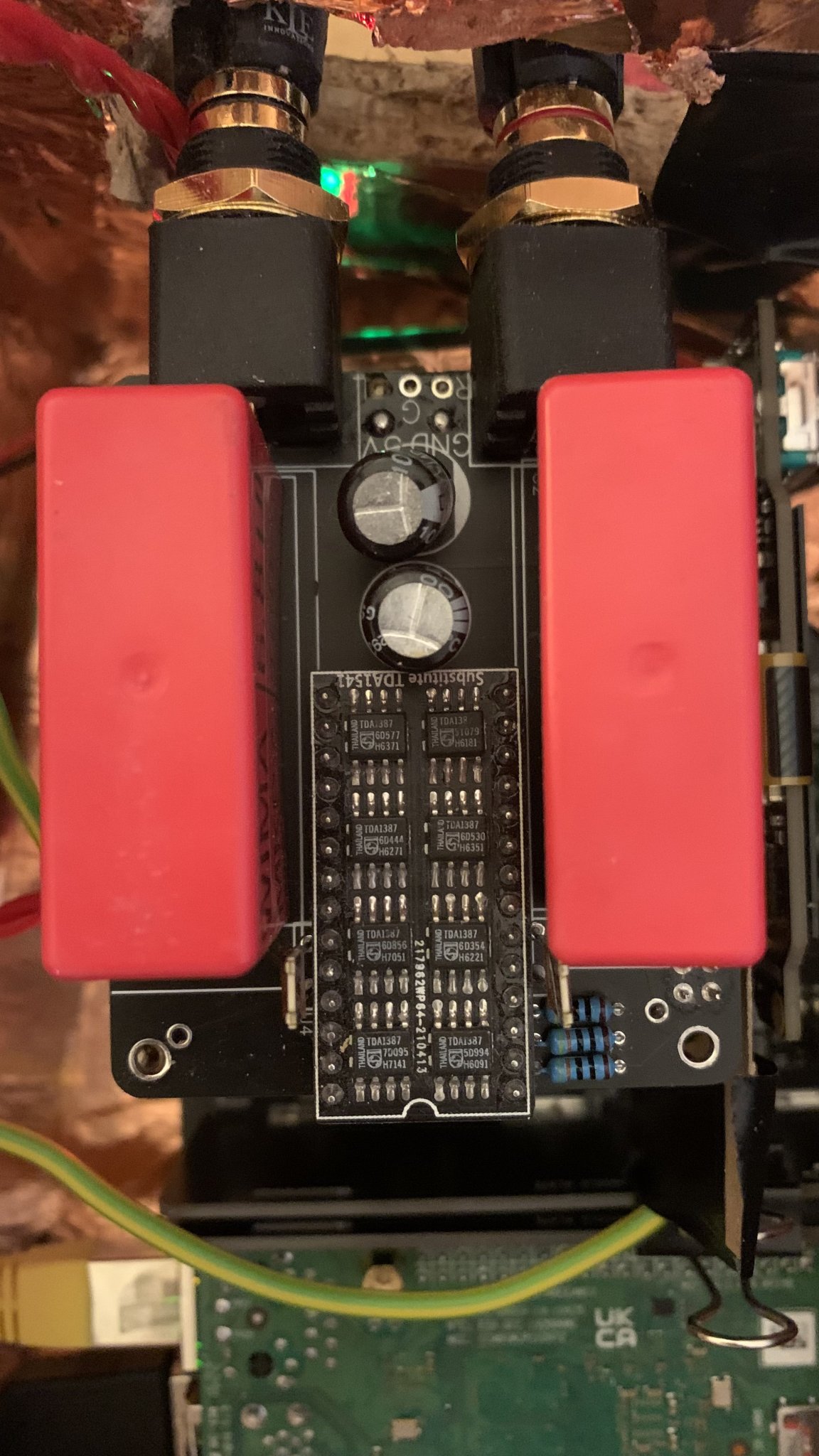

"you have simply placed the ProtoDAC on top of the FifoPi Q7 and the connection is via the GPIO? " Yes GPIO pins 2and 4 cut (no power from Q7 to ProtoDAC).
" I see a couple of wires soldered at the bottom of the ProtoDAC. What are those?"
As Mark @hifiamps advised, I have connected 5V ultra capacitors from PurePI directly by soldering wires on ProtoDAC between RCA because Q7 only provides 3.3V from GPIO pins 2 and 4. ProtoDAC works under 5V. Great improvement. Thanks again Mark.

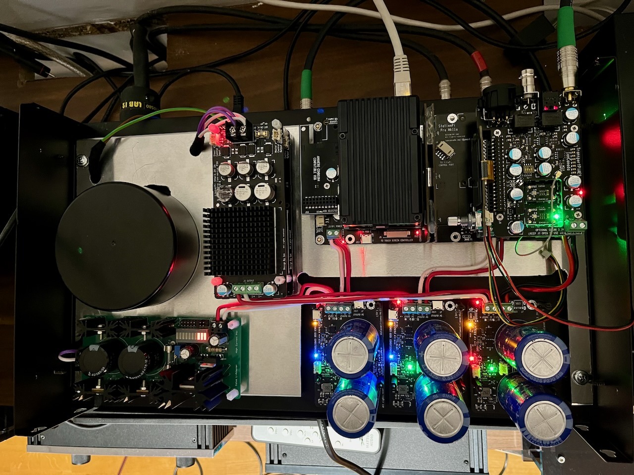

If it is not recommended to power the ProtoDAC via the GPIO of the FifoPi Q7, which will be placed underneath the ProtoDAC, I am wondering whether I can use the same 5V UCconditioner, which I am currently using to power the clean side of the StationPiPro, to also power the ProtoDAC. I hope it works and I won't short-circuit anything (the middle UCconditioner of the three in the photo).
I guess I must be careful with the polarity of the power supply to the ProtoDAC.
Any thoughts about my approach, please? @MaxB_70 @iancanada @hifiamps

Electronics newbie questions : is the module under the toroidal transformer a voltage regulator ? In this case, is it better to use it to power UcCconditionner than to plug directly the transformer to the UcConditioner ? That the reason you use it ?

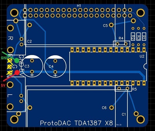

@hifiamps @MaxB_70 Thanks very much for your quick replies. So, I guess I will have to solder two wires under the ProtoDAC board, to provide the 5V power. Would you be kind to upload a photo or a sketch of where to solder the + and - wires? Or is there an easier way to do it perhaps instead of soldering?
Just double check polarity. You can solder directly to the PCB, or you can use a 5mm lead spacing screw terminal. Be sure the screw terminal has polarity clearly labeled.
Reactions: pkonstantinidis
The blue board image is an early version and was generated by the EasyEDA design software. The latest PCB version has two ground holes for the C3/C4 caps, with 3.5mm and 5mm lead spacing. The PCBs in my kits are black. I don't think sound quality is affected by the different versions. The versions give more lead spacing options for the C3/C4 and output caps (27.5mm and 37.5mm lead spacing for radial caps).
It is a Salas L-adapter, a quite powerful linear supply that can provide up to 20V (if required). https://www.diyaudio.com/community/threads/gb-for-salas-l-adapter-board.338109/
I had it lying around and that's why I've used it. If it were not available, I would have used a LinearPi (a third one in my streamer).

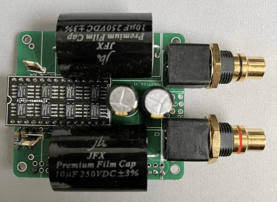

I'd rather find a prebuilt ProtoDAC available in Europe, so that I avoid any import duties. But I do not know whether this green ProtoDAC is at the highest possible spec. Any thoughts about it?
You can download the Gerber files from Moode Audio and then send them to any PCB manufacturer you like, made to your own specs. Your build uses naked metal foil audio resistors, not sure if they are S or Z-foil. The JB caps are fairly generic, low cost. Some potential upgrade possibilities in the output caps.
