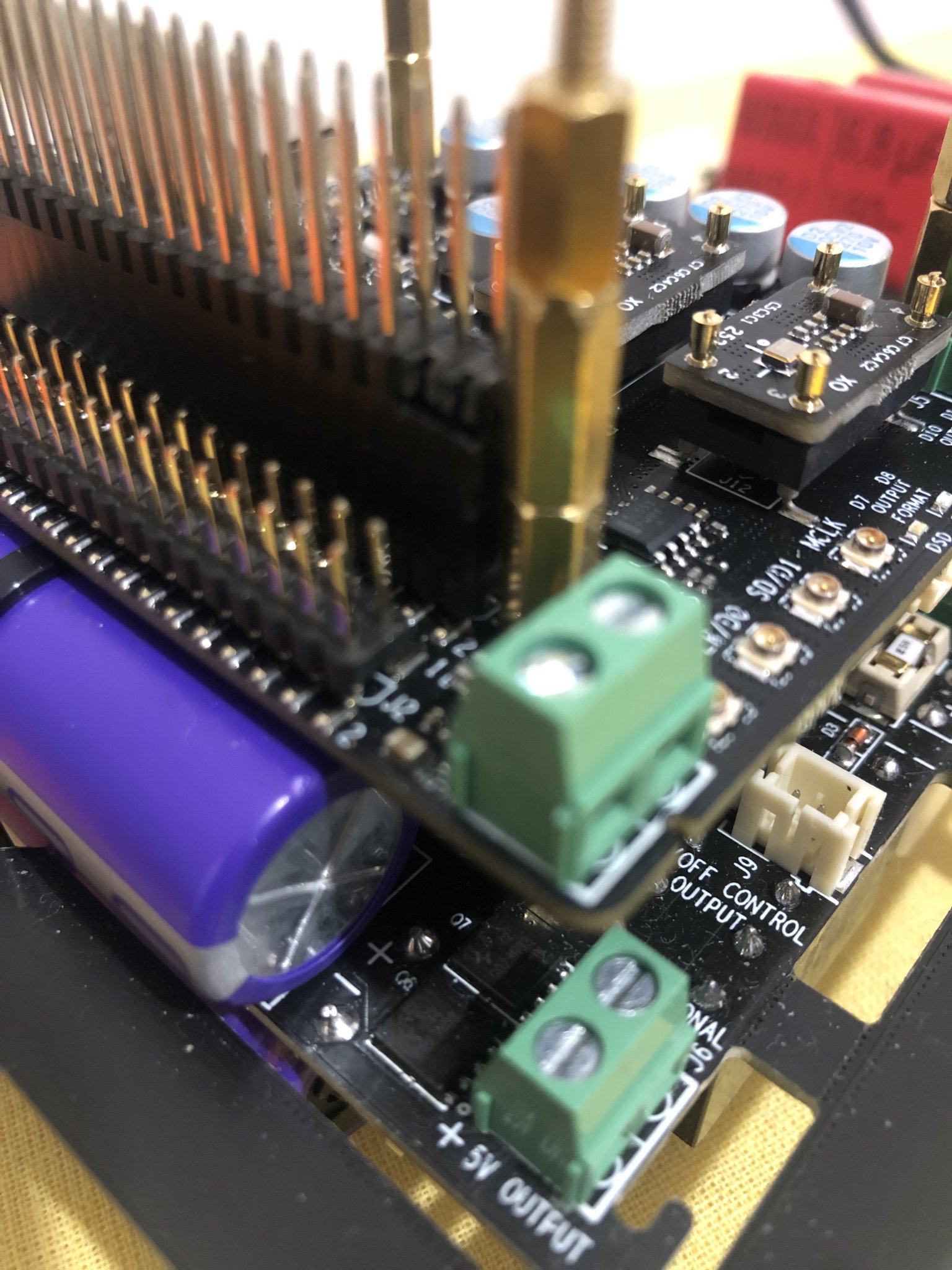

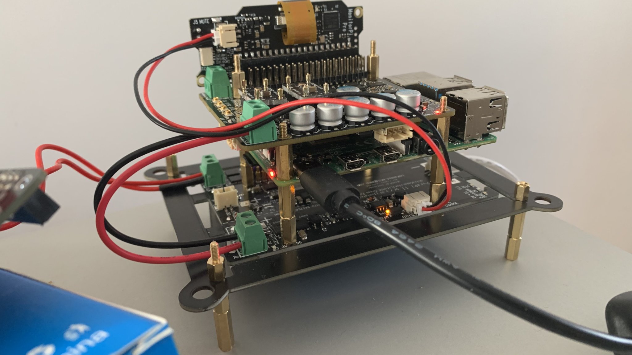

1. homework done. PurePi, RPI (powered from PurePi springs), Q7 (powered by PurePI J2), ProtoDAC (powered by J6 PurePi to 5V and GND pads, GPIO pins 2 and 4 removed). Nothing. PurePi can't power the stack.
2. RPI+ProtoDAC powered by RPI GPIO (first setup when I received ProtoDAC) => great, as usual (ProtoDAC is fine)
3. PurePi, RPI (powered separately, with higher standoffs), Q7 (powered by PurePI J2), ProtoDAC (powered by J6 PurePi to 5V and GND pads, stacking header GPIO pins 2 and 4 removed) => 30sec with great sound, then PurePI stops to supply.
Any clue ?
Let's charge all night long. I will check tomorrow and post the result.
The charging power supply needs to be plugged in.
3. The ultracapacitors have completely discharged, and PurePi stops. Plug in the charging supply to keep the ultracapacitors charged.

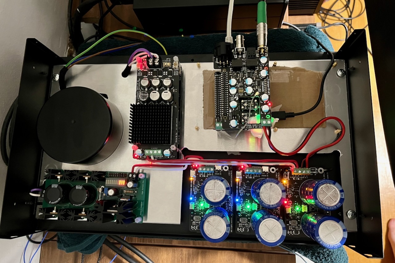

Hello,
I have recently built a streamer, based on Ian Canada components, incl. FifoPi Q7, TransportPi AES, and lots of power conditioning with linear power supplies and ultracapacitors (see photo). I am now waiting for the StationPi Pro to finish the streamer, by separating the RPi from the FifoPi Q7 and the TransportPi AES. Having watched Gabster’s review of the ProtoDac, and being a fan of NOS-R2R DACs, I am interested in adding a ProtoDac on my streamer stack.
I assume that I can remove the TransportPi AES and replace it with the Protodac (on top of the FifoPi Q7, which has a 5V power from the GPIO and 3.3V from the UCconditioners). Can someone please confirm that's a correct way to connect the ProtoDac?

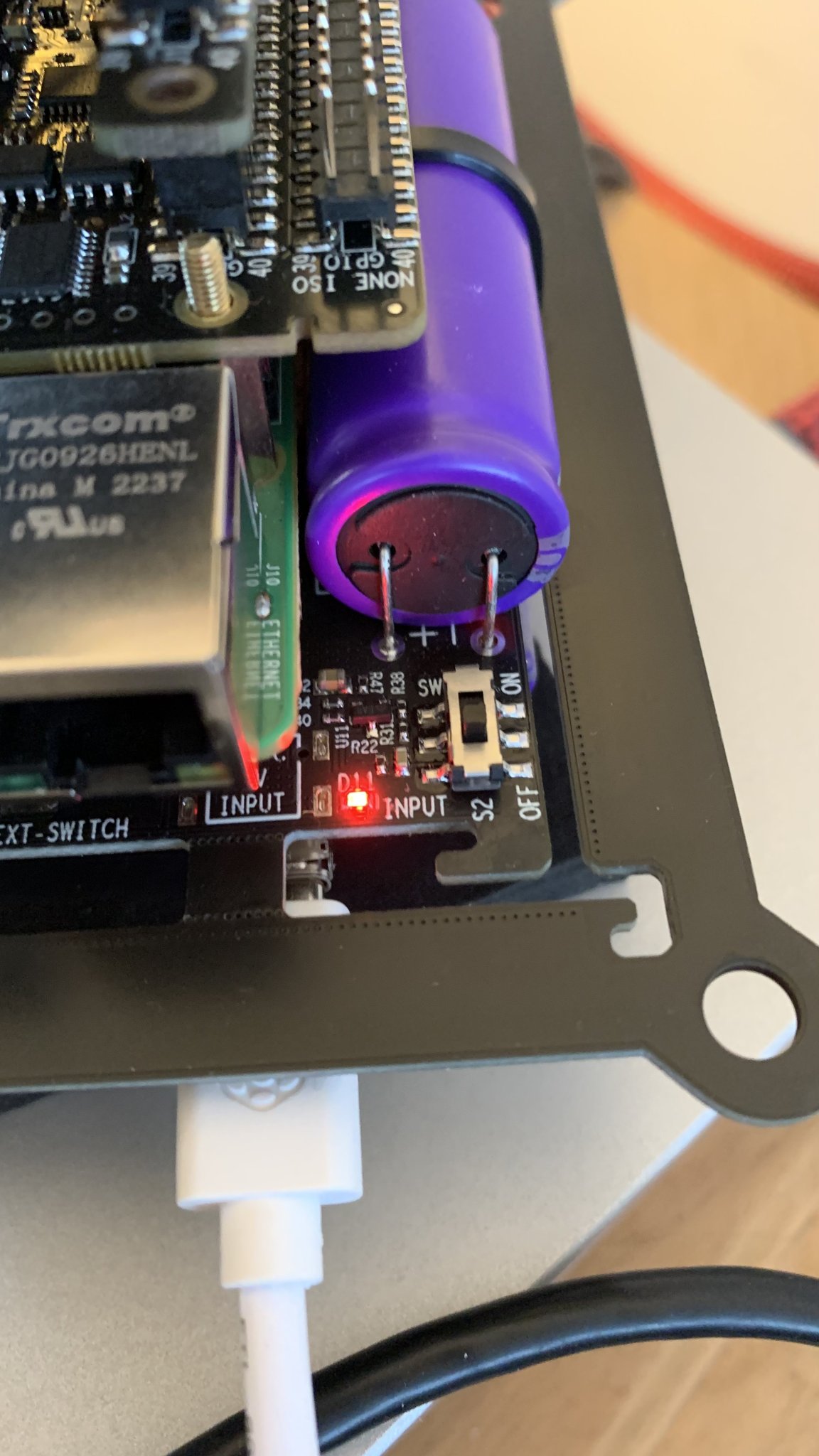

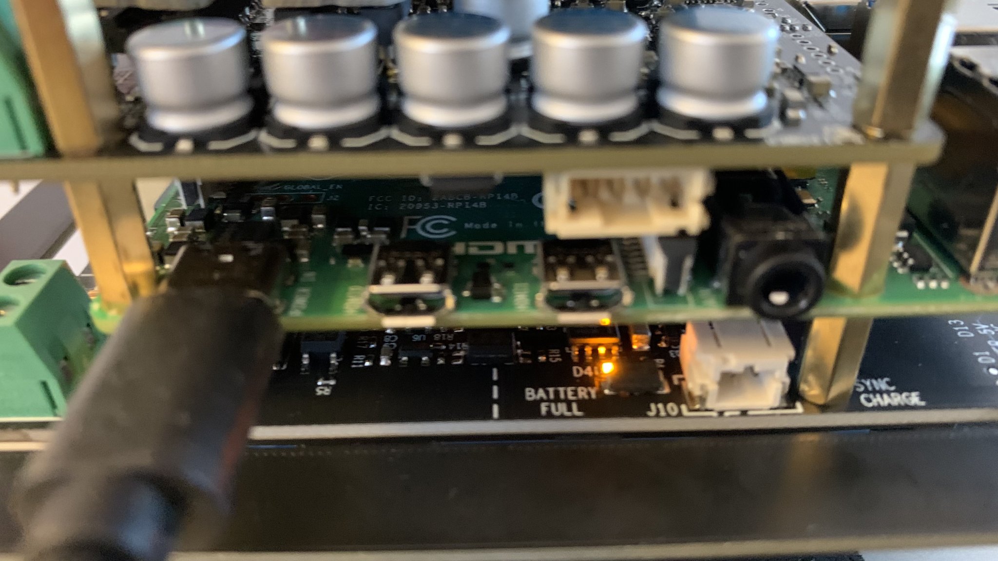

2 chargers are plugged in : 3A@5V to RPI, 5A@5V to PurePI.
when S2 PurePi is off, Q7 D2 LED is brighting. I don't know why.
Music during 30s then PurePI stops. I will post videos.

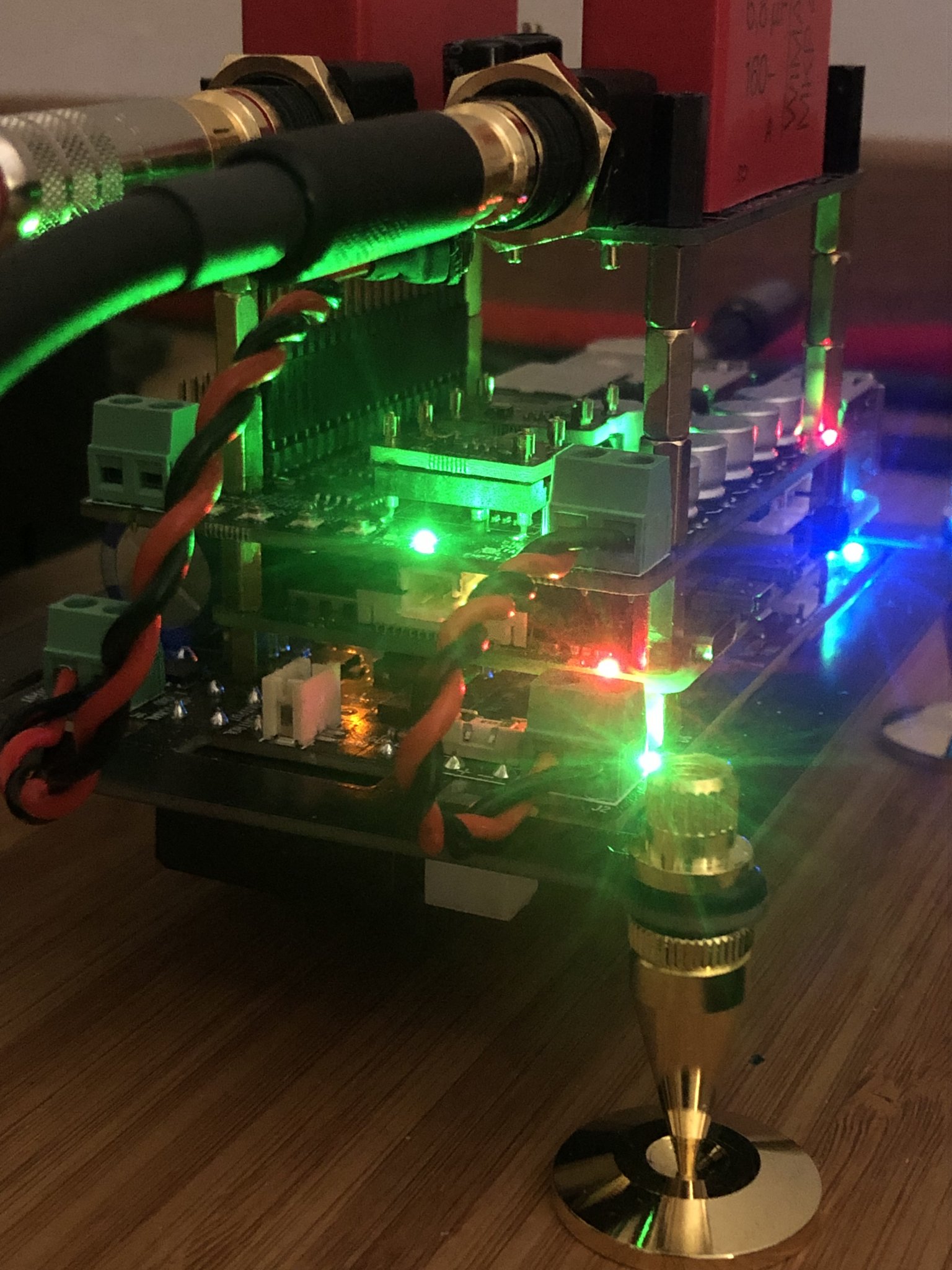

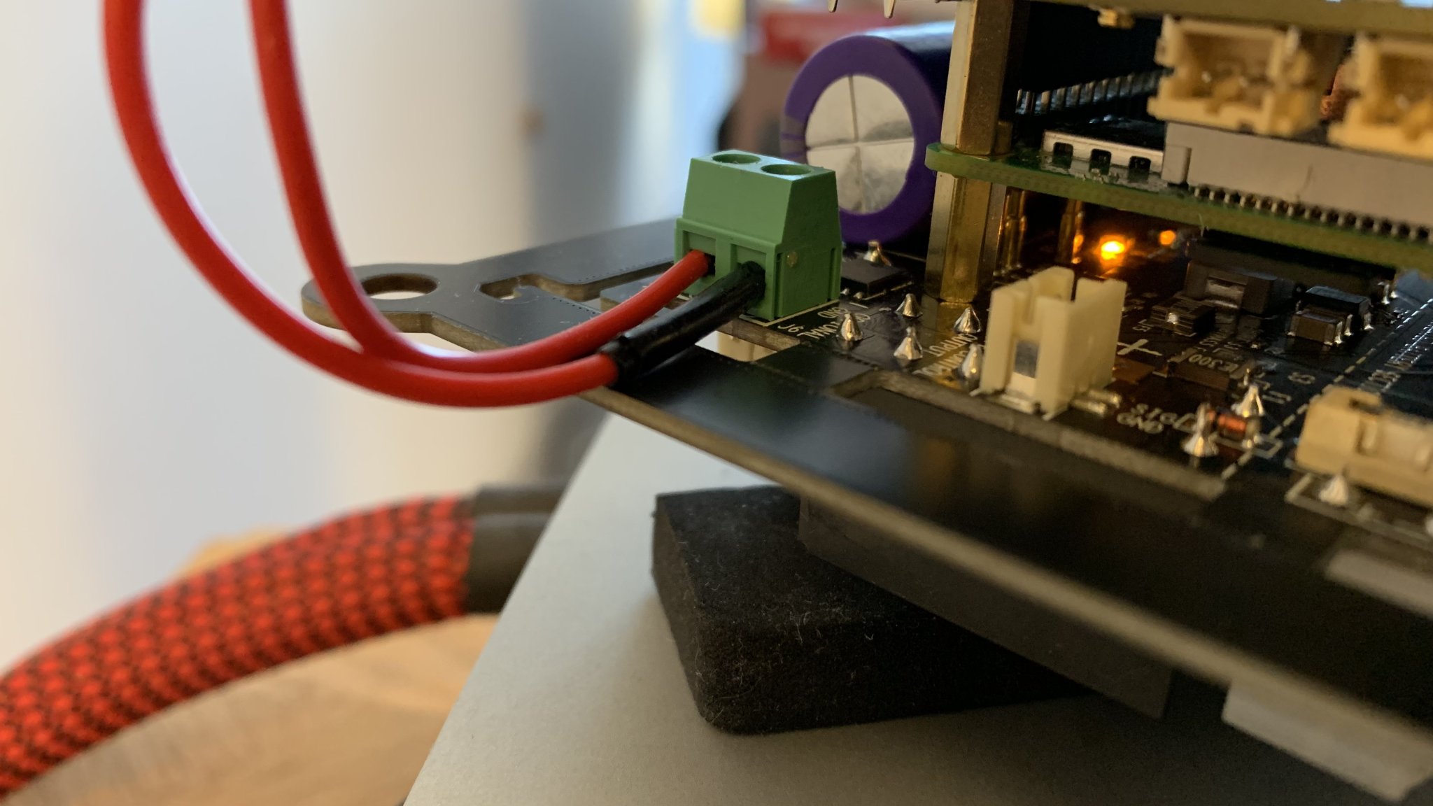

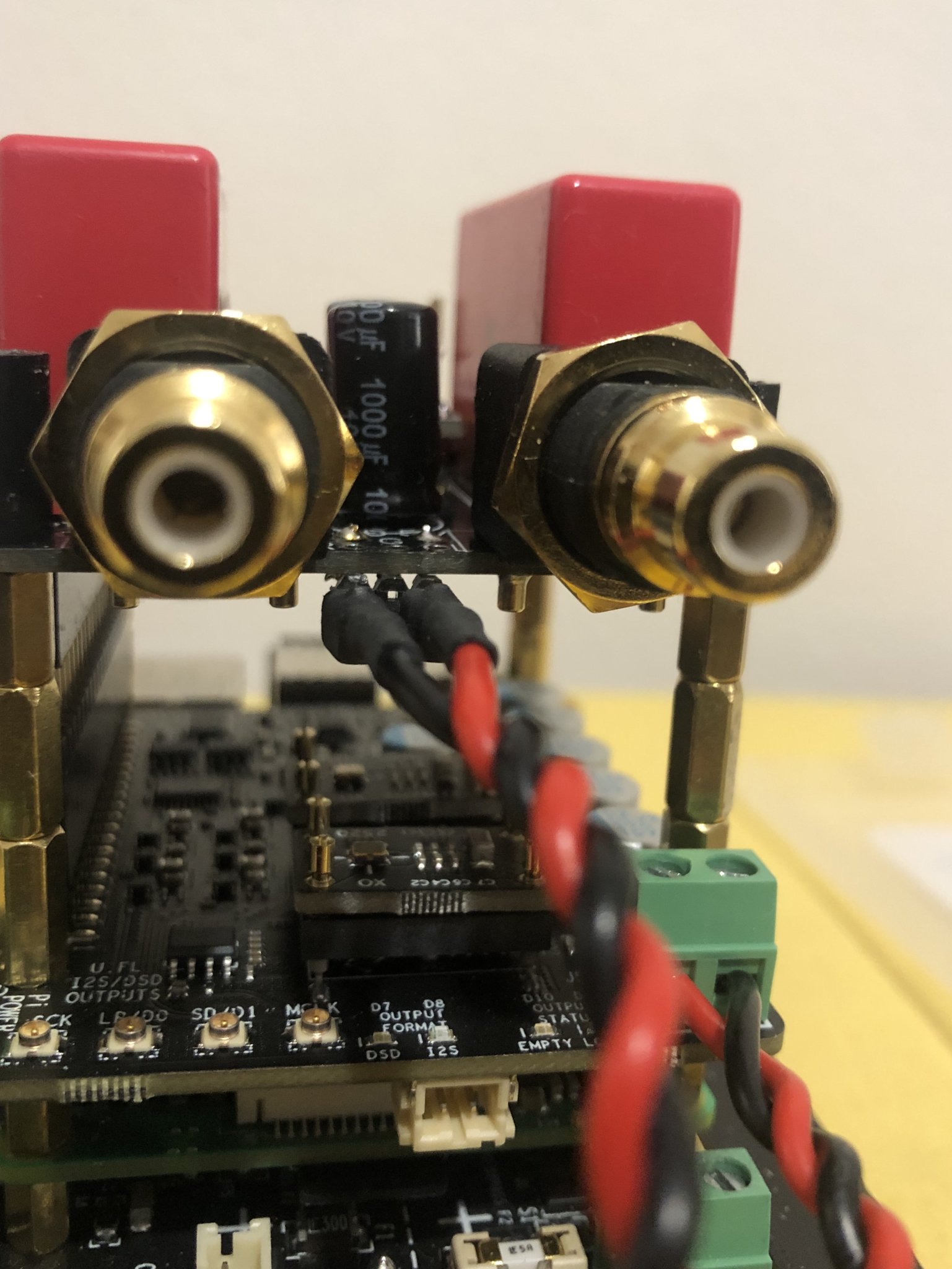

Same configuration and with the indications of “hifiamp”,
and with the battery charged, everything works….
for the entire time I was listening…. generally even over two hours😉

New 2 tests :
1) ProtoDac powered by PurePi but not stacked on Q7
2) ProtoDac out of the setup.
In both setups, when I boot RPI, D8 led (on PurePi ) lights off. This after awhile , PurePi stops.
