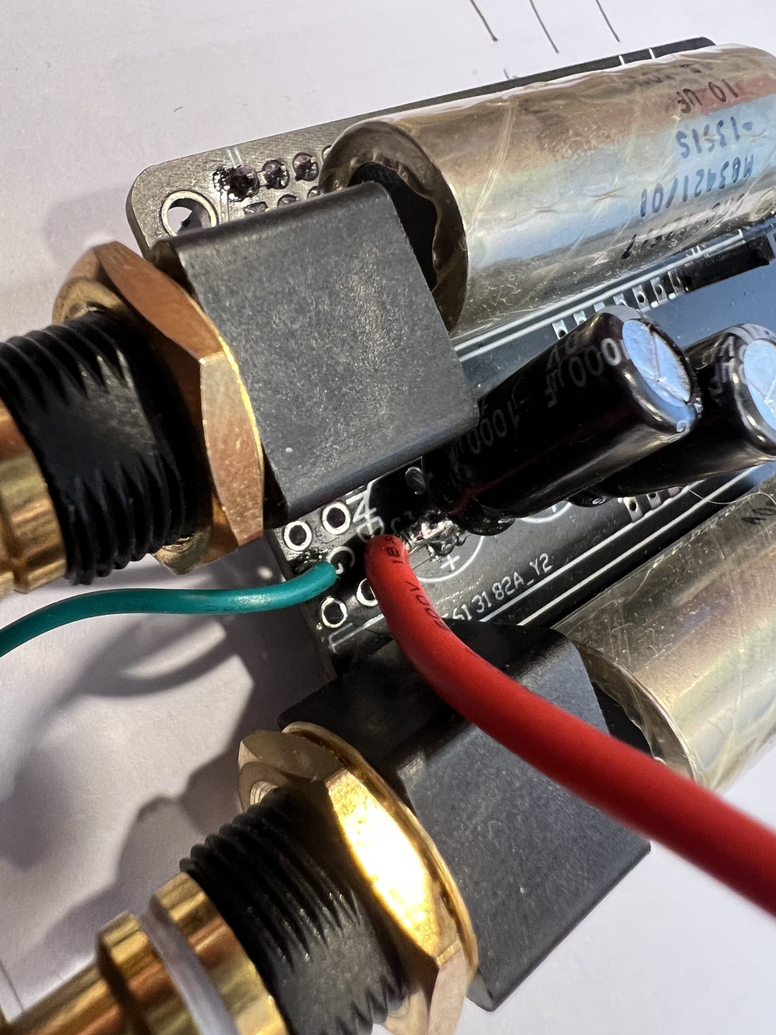

To get around this problem, ProtoDAC needs to be powered with 5VDC using the 5V and GND solder pads between the RCA jacks. You can solder a green screw terminal with 5mm pin spacing, if you prefer. Then use the stacking header with pins 2 and 4 removed to prevent 5V from feeding back to the Q7 GPIO, while retaining the required ground and I2S connections.

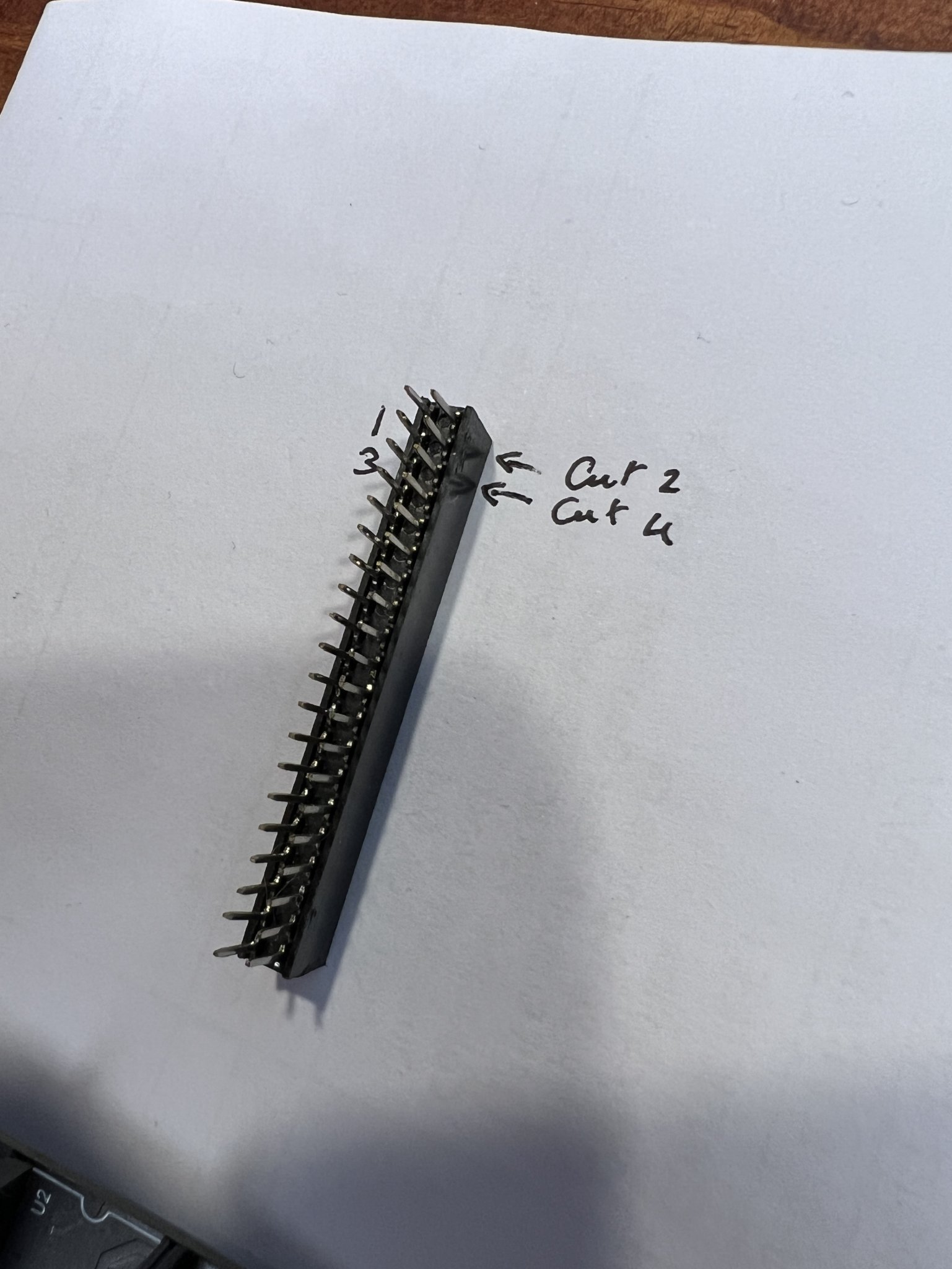

My recommendation is to build ProtoDAC (or have it built for you) with GPIO header pins 2 and 4 removed, and a screw terminal soldered to the 5V/GND pads. 😉

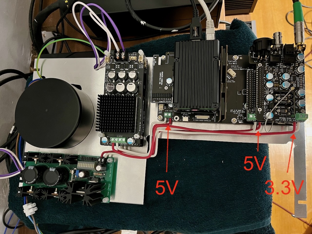

I am a complete novice with the Ian Canada products. Currently, I am only using the ultracap 5V supply of PurePi to power my stack (RPi ZeroW/Allo Kali/ProtoDAC) and it works fine.
The batteries are installed, but I am not using the 3.3V supply. Charging power supply is plugged in all the time. If I unplug the charging supply, my stack is powered until the ultracaps are discharged (about 1 minute).
I have never actually measured 3.3V at the J2 terminal. The batteries measure fine. I think it shuts off the 3.3V supply without a load? Just a guess.
Status LEDs while my stack is being powered with 5V: D8 OFF, D1 ON, Pretty blue D13 ON, D4 OFF, D10 ON, D11 ON, D6 ON.

Added a small load (420R resistor) to the 3.3V terminal J2, and 3.3V now appears. There is no change in status LEDs. Remove the load, and 3.3V switches off.
Both the 5V and 3.3V have switching MOSFETs near the output terminals.

When I posted the ProtoDac video I did not realize that pin 2 and 4 of the Clean side of the Q7 is 3.3v and not 5v.
So it is better to use a Gpio extension and cut pin 2 and 4 and feed the ProtoDac from a separate 5v or from pure pi
I got the ProtoDac ground from the pcb an +5v from the positive base of the capacitor.
