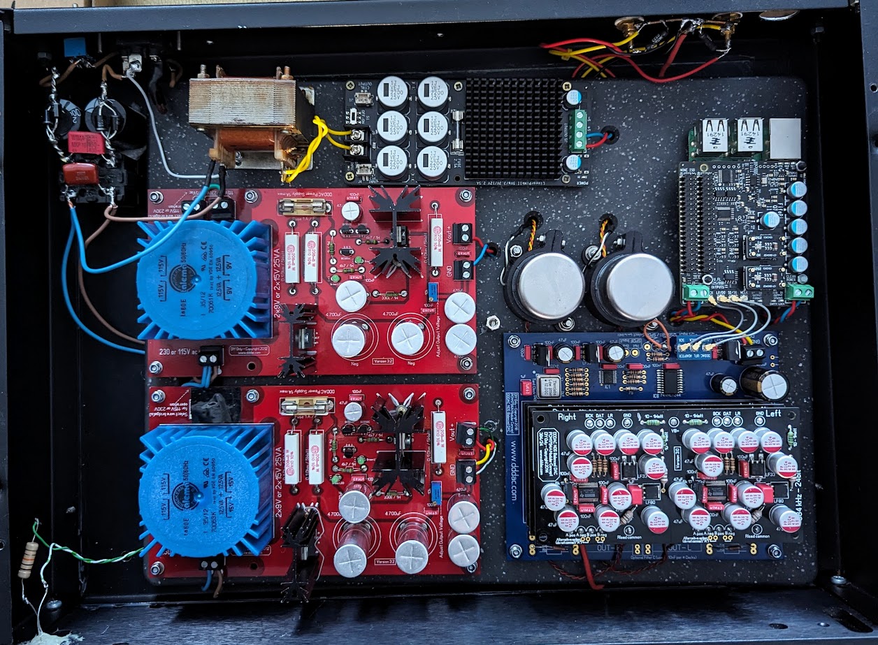

I am very very happy with the FifoPiQ7II by the way. For the first time it showed me what my dddac can do. Best 200 bucks I ever spent!👍View attachment 1261314
@Bas Horneman
Your project look very nice. Very well finished and organized. Congratulations!
Ian
