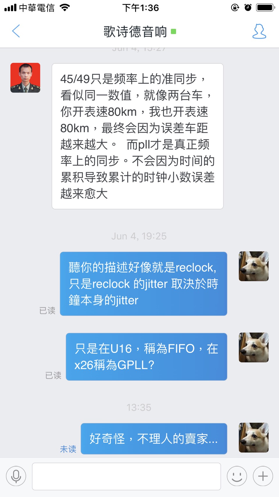

Since I was very curious about Gustard's GPLL technology, I asked Gustard directly about it, as shown in the picture below.
According to Gustard's reply, I understand that the so-called GPLL technology is actually reclock, but it is called FIFO in GUSTARD DDC-U16, and GPLL in GUSTARD DAC-X26. In other words, the DAC-X26 is really just a DAC with a built-in reclock.
In short, my advice is correct, with Ian's reclock and TP's DAC is a better but cheaper combination, but the overall jitter level depends on the jitter of the clock itself. In digital systems, using better clocks, such as pulsar clock, makes more sense than using strange new technologies. The reason is that in digital systems, the only factor you have to consider is the jitter. Many new technologies are easy to generate more extra jitter.
