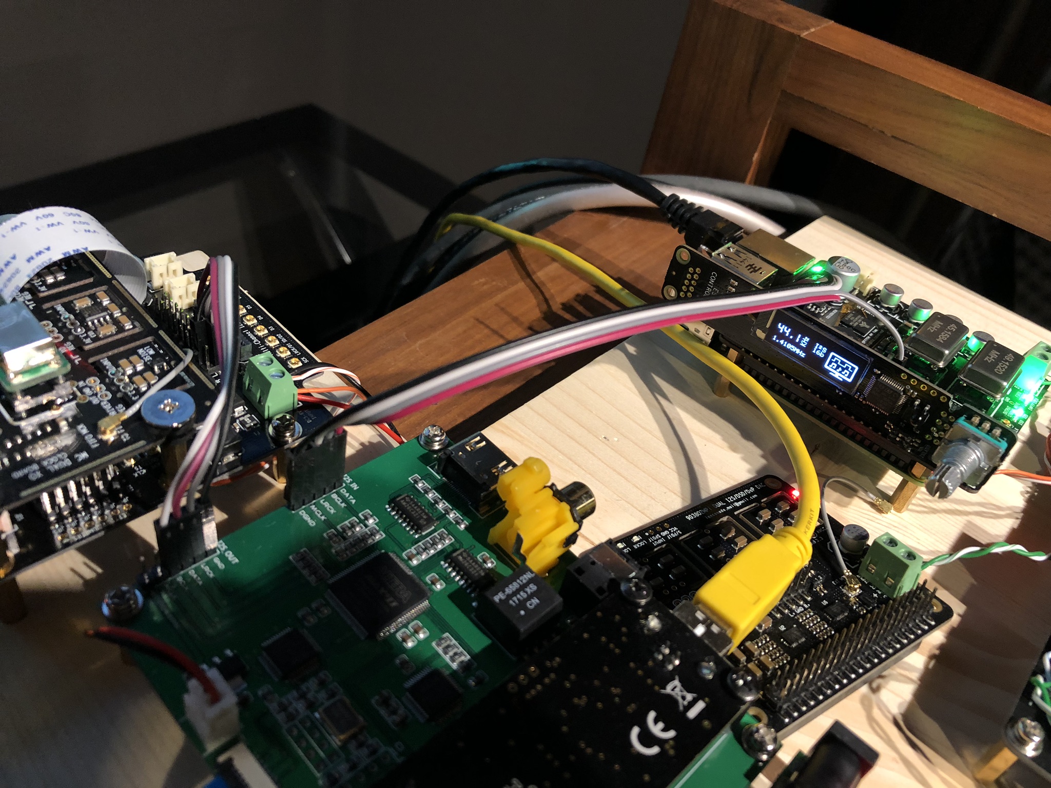

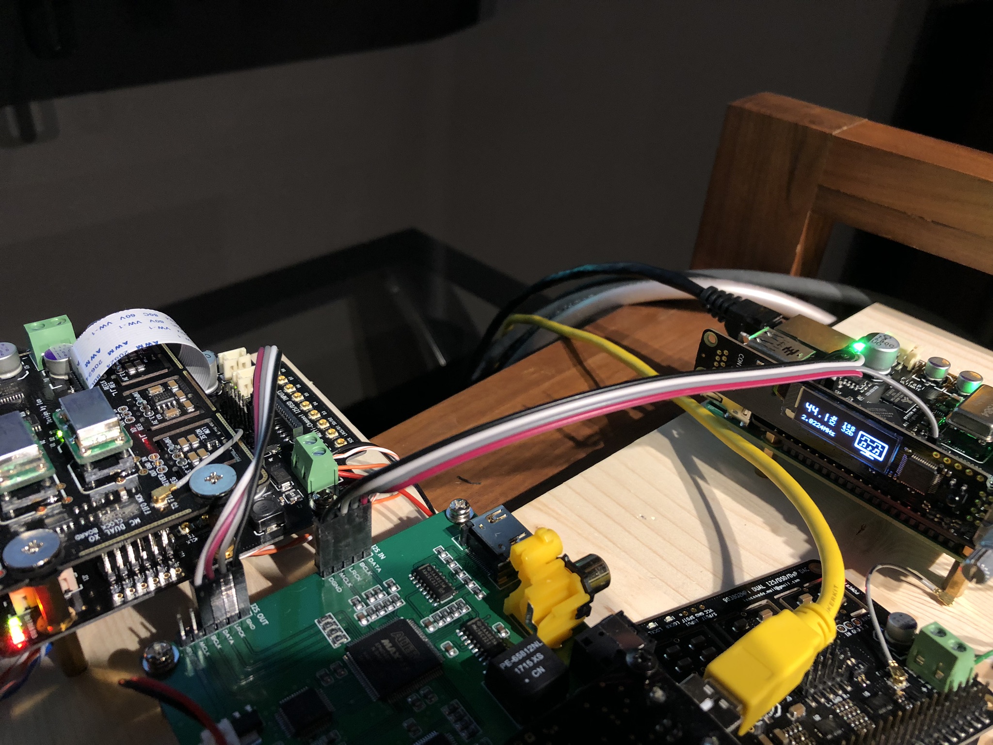

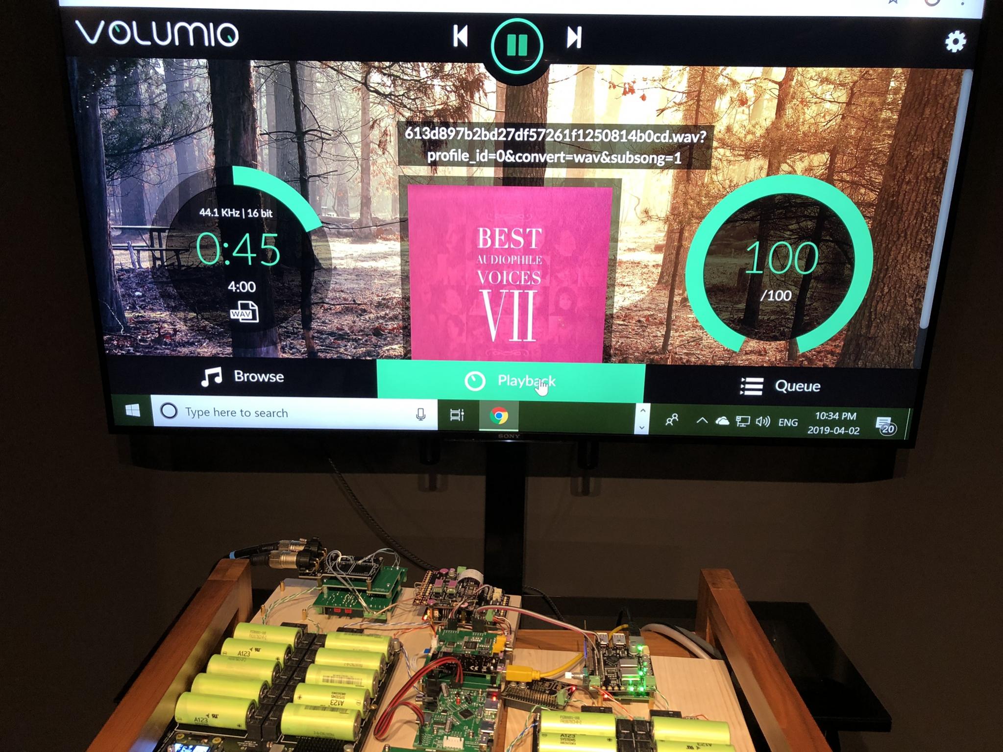

I did some test this evening. I duplicated your system and double confirmed that the 16 to 32 function is working correctly.
The configuration was:
RPi + FifoPi + McFifo/McDualXO +BIIISE/Legato
I also use an ESS controller plugged into the no-isolated GPIO of FifoPi with enabling the signal analyzer mode.
I was playing 44.1KHz 16bit music by Volumio.
The first picture shows the real monitored music format is 44.1KHz 16bit. Only noise out of BIIISE.
Then I turned the jumper switch pin2 to on position to enable the 16 to 32 lossless converting function. The second picture shows the real monitored music format changed to 44.1KHz 32bit. BIIISE outputs music correctly and wonderful.
Pictures three shows both hardware and software configuration.
Debugging your system would be not very difficult, we only need to know what's the real format out of FifoPi, then we can locate the issue.
Just hope you can figure it out.
