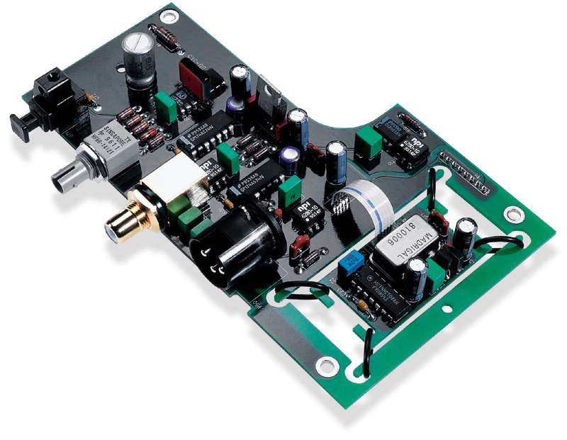

Ian, I wold suggest including a slightly larger size rubber o-ring in the kits, I havent seen anyone else using them, but not only did I snap a couple installing them, but i've had 3 of them snap now, 2 happened fairly soon after installing them, but i've just had a 3rd happen after being fine overnight. its potentially dangerous, as I only noticed after close inspection that the band had snapped and the inertia from this moved the assembly so that one of the metal standoffs was placed in the middle of one of my ackodac's voltage regulators, had it been on, this would have caused a catastrophic failure.
the fifo/clock assembly was placed straddling this regulator on 20mm standoffs but with plenty of clearance, so it didnt move it just a little bit. the problem is that now ive taken it out of the frame I dont have any other way to mount it, so any suggestions are welcome, perhaps I will use string temporarily, dental rubber bands might do the trick.
i'm posting here just so that people are aware of this potential issue, as I said I havent seen anyone else using them yet
Levinson did in ML31.5: http://www.diyaudio.com/forums/attachments/audio-sector/156220d1264979256-cd-transport-22.jpg
I believe qusp meant he hasn't seen anyone else with Ian's kit use them. Most pictures I've seen show the board still attached to the main pcb.
correct thats what I meant, I havent seen anyone else from the GB use them with the fifo, i've only seen it still in the frame, but I thought I should post the warning, because it has the potential to be a real bummer if the dac is on at the time.
of course there has been all sorts of mad attempts to isolate from vibrations, this one probably does make a difference, its sometimes used for isolating clocks in instrumentation too.
I snapped 3 O-rings just trying to gently stretch them to fit over the pegs. I gave up after that. The dental band idea seems good, or something more deformable...I was hoping to find silicone bands somewhere but haven't yet had the chance to look.

I noticed the O-ring problem. Just let me figure it out. I'll give some solution tomorrow.
