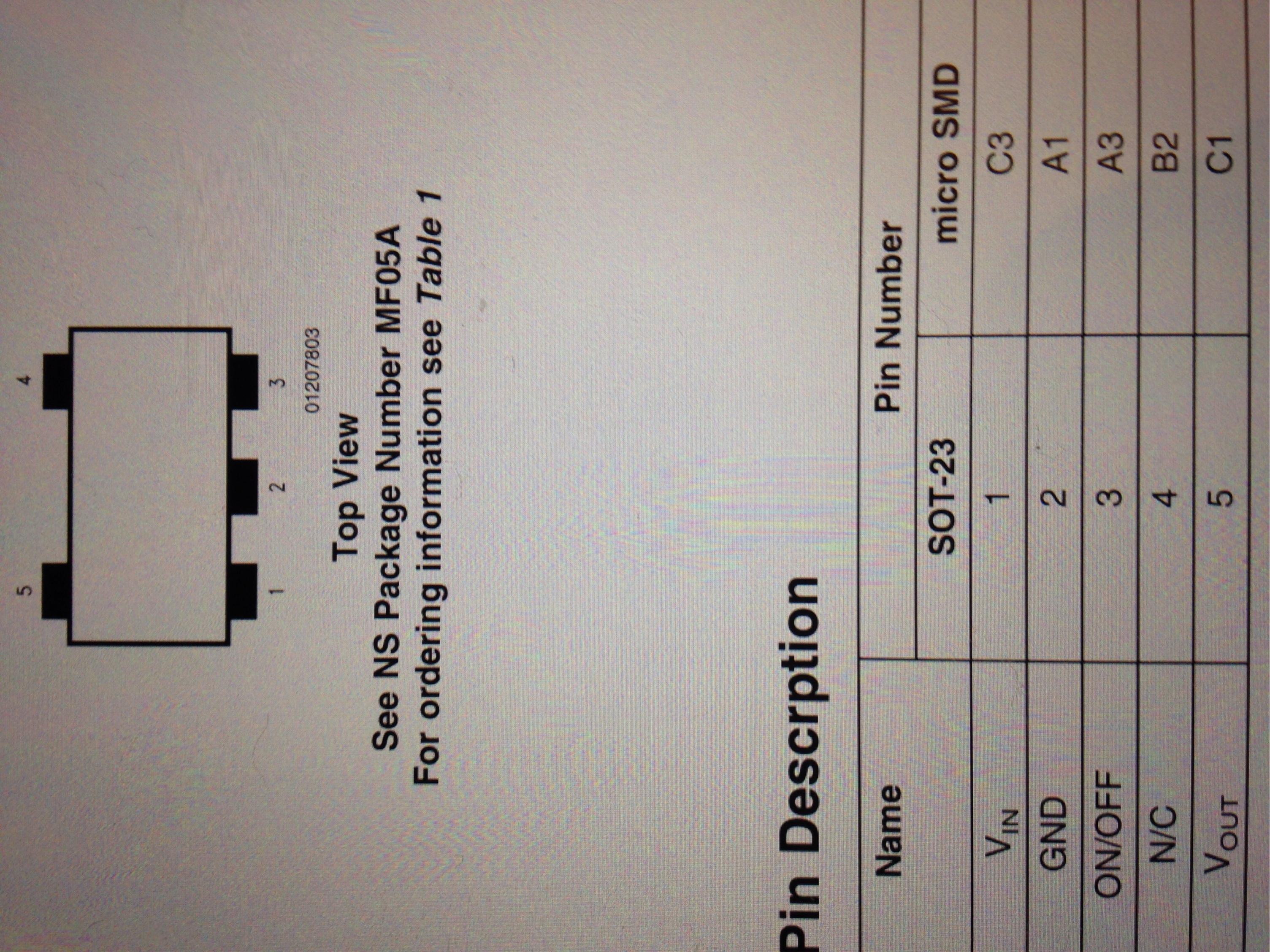

Hi, i connect the TeraDak an use the two pin connector like the Color, but the Color is nötig Right in my case, Black is +5V and red is GND.
Do you know that the TeraDak has a polarity Protection?
Or is the dac defect if you connect this with wrong polarity?
Regards
A friend of mine came over a few days back with one such DAC that wasn't working. I noticed that when I was powering it up, it was shorting my power supply.
I took a closer look and saw that it had the red and black wires put in the wrong way. The power cable that came with the DAC was faulty.
The end result was 2 blown LDOs on the board.
I suggest that you fix the cable before you power the thing up.
If you've already given it power, chances are that your LDOs are gone. Hook it up the proper way (according to the marking on the PCB) and check for 3.3V on the LDO's outputs (just probe all pins, one of them should be at 3.3V). If you measure just ~1V then the LDO is gone. Ask for a refund.

Hi again, so you mean this one?
https://www.reichelt.de/?ARTICLE=16...Mp5t6dTZetLQGHJVbBg6W4iQXL100t8G80aAoM08P8HAQ
How can i Test this?
Regards
Measurement of LDO
I found on the net a data sheet and have between measured pin 5 and pin 2 3.2V and between pin 5 and pin 1 5V, if I have understood correctly then the LDO is still working.
Please See the picture.
I there anything else which can be damaged?
Thanks in advance!
Regards
Have you checked the Rest of parts on the dac pcb, or only both LDOs?
I have measured both f the LDOs, on both sides i find 3,2V, i think my power suply was not strong enough to damaged the LDOs only 1A.
Just the LDOs for now - I'll resume testing once the replacement parts are in.
Normally I wouldn't have bothered fixing this board (it is after all dirt cheap), but since the LDOs were ~0.20€ I thought I would spend the 5 minutes swapping them in.
Plus it's a pretty cute little board - I couldn't just throw it away.
