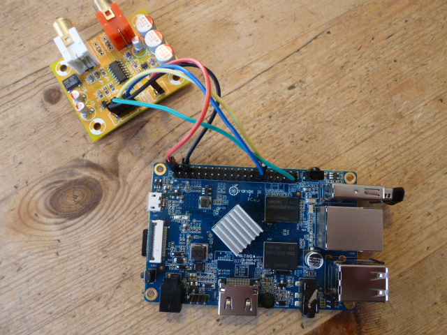

Could someone take a look at the picture, did i locate the pins correctly. Take the red wire as reference that should be +5v...
Is ok, you located the pins like my pic (one GND is not connected, but probabiliy the 2 GND are the same ground..).
Can you try switch pin27-blue with pin28-yellow?
In H3 manual is not clair what pin is LRCK and what is BCK...
It is only necessary to connect one Gnd, ( i have connected the card to my raspberrys) i will change both of the wires in the evening.

How I read it is that the one with 'SYNC' in the name is LRCK (WS). So I agree with your diagram in post5. PA18 looks to be WS/LRCK.
Yes, i tought too SYNC mean the Left\right clock.
maybe the problem is software
looking here i saw
i2s configuration
[i2s_para]
i2s_used: 0 to disable; 1 to enable
i2s_channel: channel control; 1 for one, 2 for two channels
i2s_mclk: master clock signal GPIO configuration
i2s_bclk: bit clock signal GPIO configuration
i2s_lrclk: word clock (left/right) signal GPIO configuration
i2s_dout0: digital out 0 GPIO configuration
i2s_dout1: (optional) digital out 1 GPIO configuration
i2s_dout2: (optional) digital out 2 GPIO configuration
i2s_dout3: (optional) digital out 3 GPIO configuration
i2s_din: multiplexed in signal GPIO configuration
Configuration example:
then I think in script.bin should be

I took a look at the /lib/modules. There are no i2s modules, so even the pins are connected it would not work with this kernel. There are only spdif modules.
Regards
Regards
@skyunlimited, i didn't see the other setups, but i looking only [pcm0]:
i changed
daudio_used = 1 (before was 0)
i2s_lrclk = port😛A18<2><1><default><default> (before was i2s_mclk = port😛A18<2><1><default><default>)

i changed
Hi. I'm also trying to run a Orange Pi PC and PCM5102 DAC.
At the moment I tried to edit the file script.bin.
But not works, pins i2s not change state at any time.
Unless there are no I2S Modules, it is not possible to use the Pins even if they are connected. I found this thread concerning to Sunxi i2s modules, for the H3 it must be quite the same https://groups.google.com/forum/#!topic/linux-sunxi/t44VY2-cOMo[1-25]
Regards
Regards
Regards
Only linux distrbutions with i2s enabled kernels and with the DAC chipset driver loaded can work for any i2s board and I think at the moment only this kind of linux distributions should be tested on OPI for test i2s boards.
Some Volumio or maybe latest Raspbian well adapted for OPI can be good targets for try, but no any other kind of linux distributions.
Regards
Do you know if there are any distributions with Kernelmodules?
My Internet Connection is volume-based so i can not download all...
