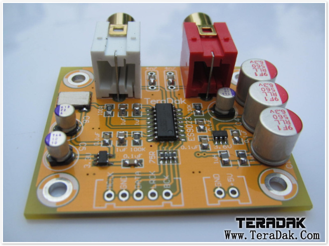

Hello,
i have a Orange PI PC board with Allwinner H3 chip and i'd like to connect a i2s DAC (Teradac with Sabre ES9023).
At page 62 of H3 datasheet is writen:
Compliant with standard Inter-IC sound(I2S) bus specification
Compliant with left-justified, right-justified, PCM mode, and TDM(Time Division Multiplexing) format
Full-duplex synchronous work mode
Mater and slave mode configured
Adjustable audio sample resolution from 8-bit to 32-bit
Sample rate from 8KHz to 192KHz
and page 79 shows i2s connection:
PCM0_BCLK = I2S/PCM Sample Rate Clock/Sync - I/O
PCM0_BCLK = I2S/PCM Sample Rate Clock - I/O
PCM0_DOUT =I2S/PCM Serial Data Output - O
PCM0_DIN = I2S/PCM Serial Data Input - I
but i don't understand if PCM0_BCLK is LRCLK (WS) signal or no.
Someone can help me?

I hope this is not too off topic for this thread...
I'd like to know how you communicate with the DAC once you have made the proper connections to the I2S lines? Do you need custom code for this?
The reason I am asking is that I have an Orange Pi PC. I have gone as far as downloading a couple of versions of their OS ports and finally got one to work but then put it down and have been working mainly with the Raspberry Pi 2. I use USB DACs and find these to work well and they are NOT expensive. I stick to 48kHz 16 bit playback (which I find totally fine) and higher rates and bit depths may demand too much from the R-Pi USB bus...
Please post more details about this effort if and when you get it going. I would like to learn from your example.

For me is not off topic
What versions of OS works good? It works with your USB DAC? What mode of Dac you have?
I chose ES Sabre 9023 I2s because is cheap (10 euro) and a lot of people told it sound very good (they tell with i2s interface, for example, there is less jitter, but i haven't much experience...).
If i use USB dac I occupy one USB port too.
I want do a compact mediacenter: 500GB HD + Orange PI PC (with infrared remote control + ES9023 DAC + TPA3116 + 19VDC power supply + 5VDC power supply.
I'd like use a OS like: Openelec or Volumio.
