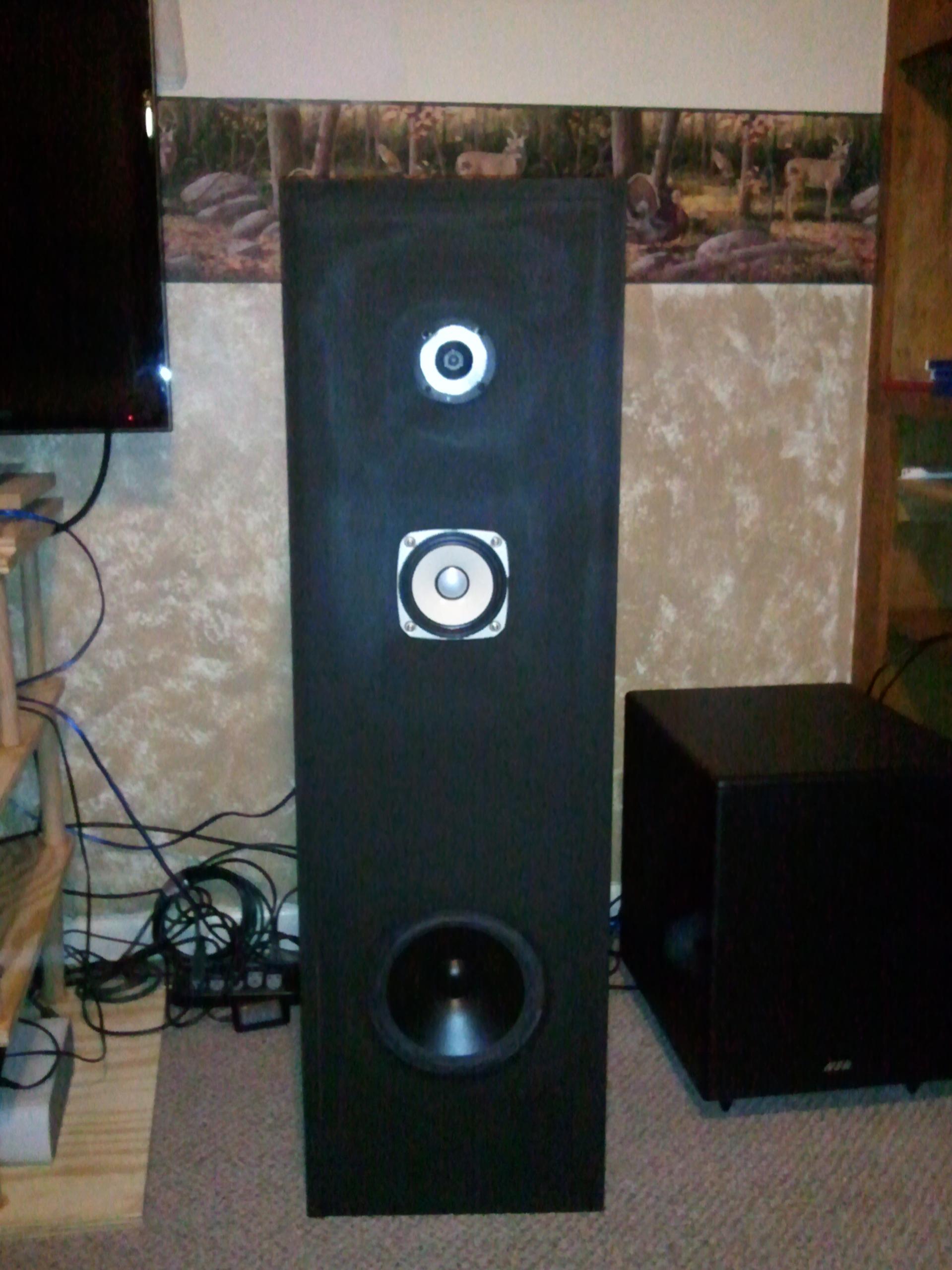

Included is a shot of the speakers are they are now.

Maybe the two Fostexes are too efficient ,thus the need to cut some over-sparkling brilliance by eliminating the 125 ,but keeping of course the FT 17 . Try to google 'Ballerina'
speaker ,6Moons has a review ,to get an example of a simple but effective solution.🙂

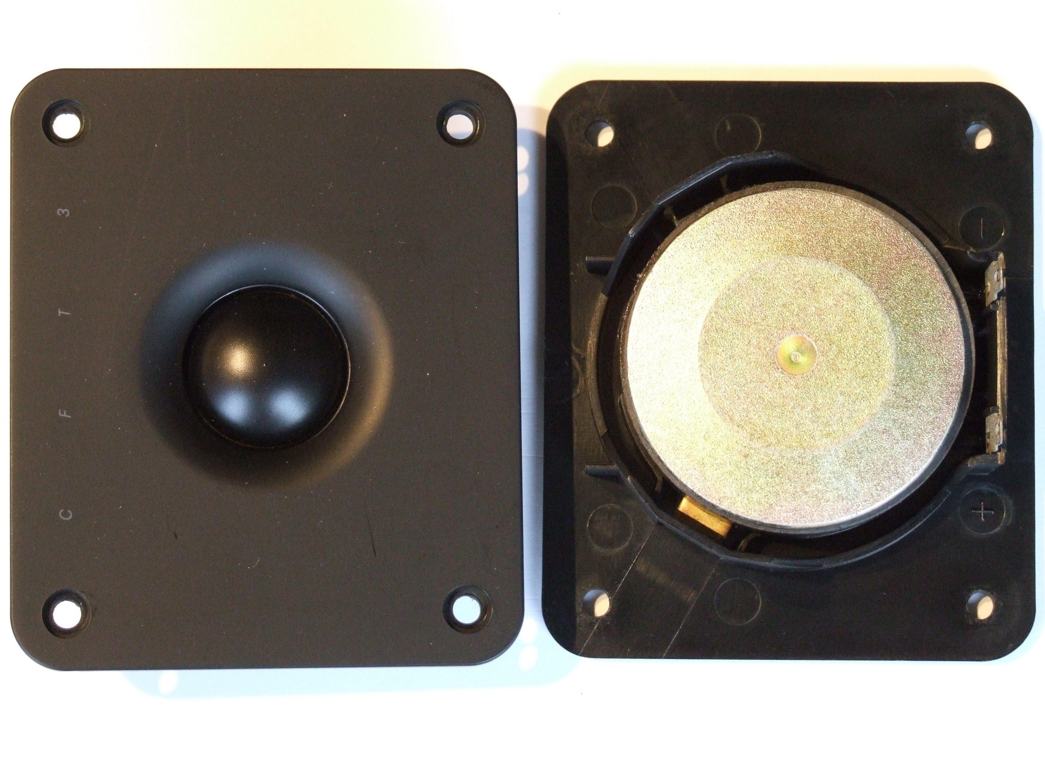

I actually do have some used authentic Boston Acoustics midranges and tweeters on hand. Not sure which model numbers they are, but you just gave me a great idea, I'll put them up for sale in the swap meet area. I do have a pic of the tweeters.

is the tweeter in a waveguide, or is just shades I see ?
tweeter and midrange are very far apart from each other
but a waveguide would explain it
woofer is also mounted very low, unless its a sub, crossed very low
if its supposed to work as a 3way, the drivers should be closer together
many ways to improve this speaker
No all three speakers are Free-Air. With the lowest cone being a sealed enclosure of its own. I did want to use the Low woofer as a sub. I only want it handling lower freq's. But I also understand that it may be best to set all three close together to get speaker cohesion. I'm slowly learning from my mistakes, I've always learned through practice and this taught me what not to do.
In a different perspective ,those speaker cabinets are very good indeed 😉
Major work has to be in the Xover . The woofer mounted very near to the floor has a bonus of +3dB from the floor (+ 3dB each surface ,so when positioned in angle you would expect +9dB) ,so it may gain in efficiency to reach the other two units . As usual ,when working with low Xover frequencies ,it may be advisable to run the mid-hi and the woofer (sub) sections with different amplifiers ,actively crossed .
But I'm not encouraging a journey through an unknown path ...As Tinitus said ,the best way is to start from basic configurations then evolve . For example ,if you see your mid-bass having too excursion and you fear it breaking ...then it's time to examine 2nd order...and above.🙂
The tweeter and midrange need to be as close together as possible. The woofer can be farther though, because at bass frequencies the wavelengths are much longer. Plus it's better to have the woofer closer to the floor, you avoid floor bounce cancellation and gain boundary reinforcement.

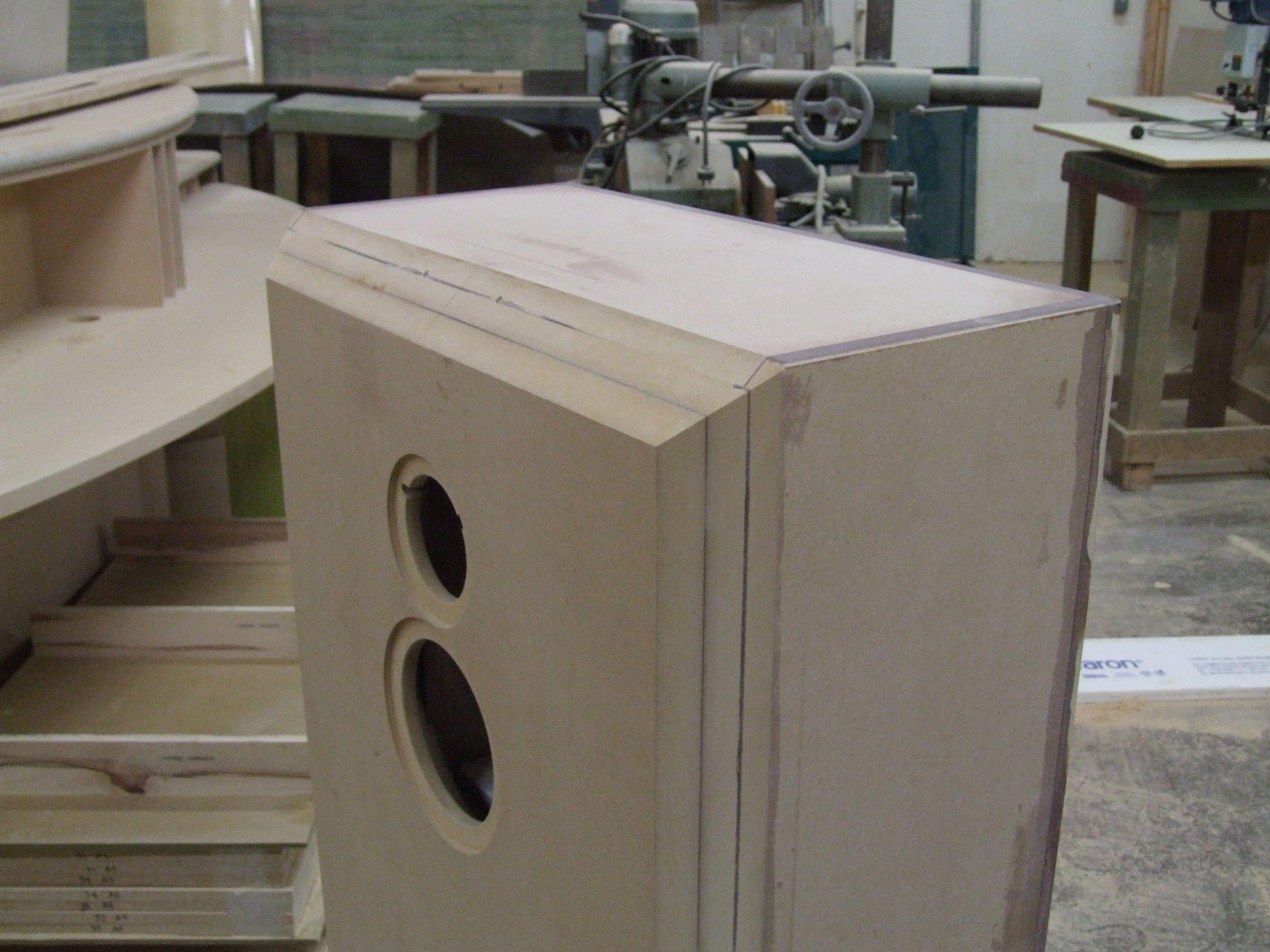

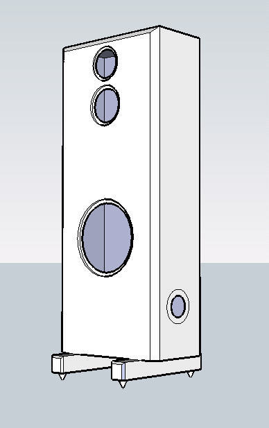

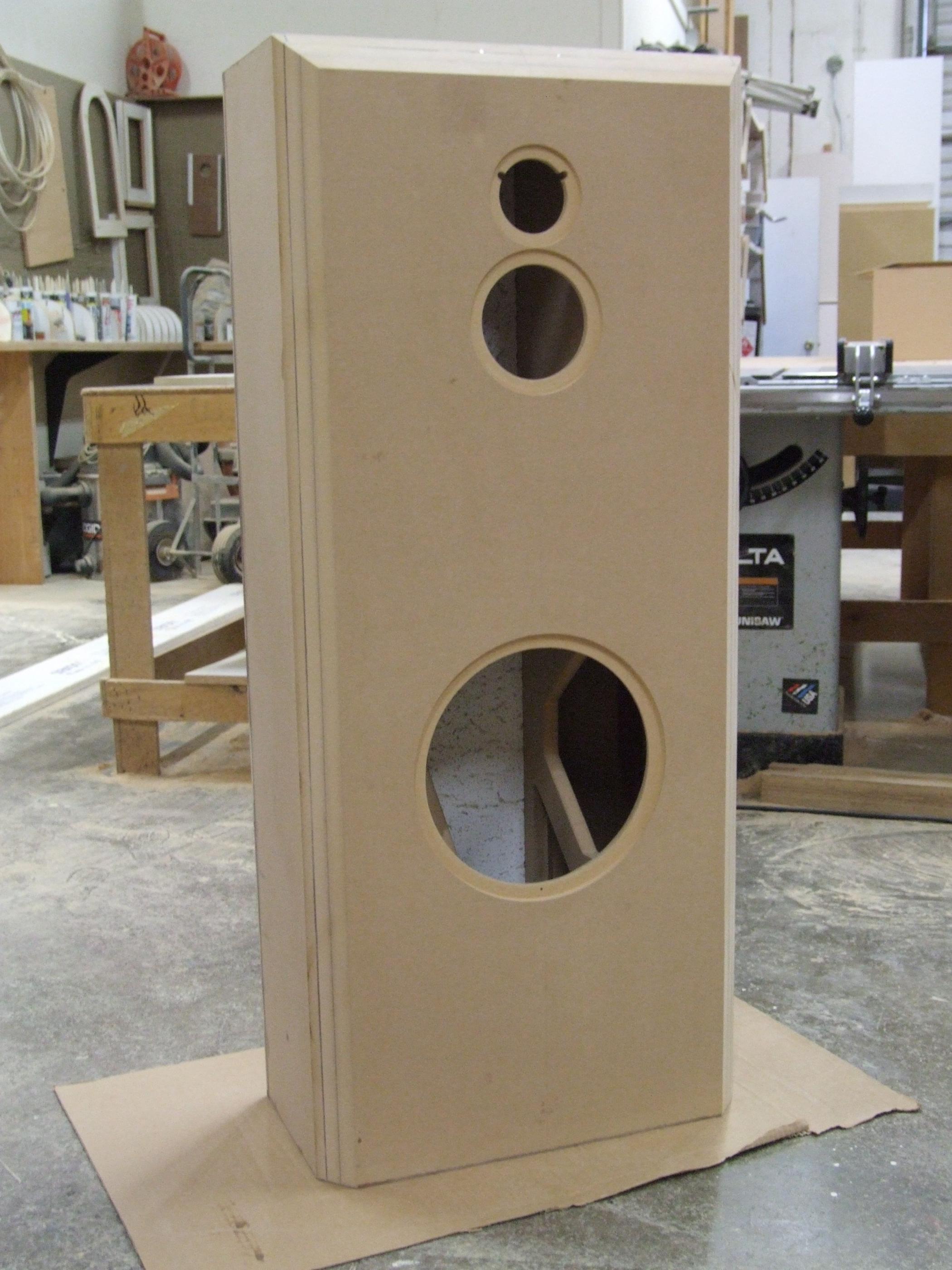

Not sure if it would matter but I was hoping to crossover all three using Passive only, specifically lowest woofer handling 375-400hz and down then FF125 From that up to 10k then FT17 beyond that. Non Outlet dependent.
I realize running the woofer off a plate amp would be the best solution for simplicity and efficiency. However, I would prefer to not have ANOTHER 2 outlets used and limit speaker placement based on those. I realize the two upper speakers are separated rather largely but I have yet to notice any pronounced issues between them separating the sound stage oddly.
