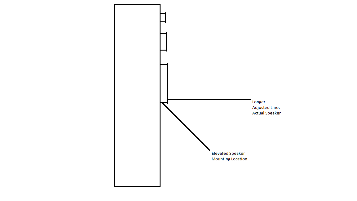

The concept for those curious to what I was thinking was to Move the mounting of the speakers themselves an inch off the face of the speaker, Say like stacking material the size of the mounting plate sealing it and using it to remove them from the overly wide area of the speaker(The main front of it.) I'll design a quick concept in Paint, Yes Paint, to show what I mean.

one problem with your design
drivers should not be mounted in a tube
at least not the relatively smaller drivers
you will hear the ressonance through diaphragm

I'm replying using the quick reply Box ...🙂
Generally ,speakers should be mounted flush . In your design ,you could have the drivers
and their 'emission centers' vertically aligned ,on the same axis . Otherwise (generally ,because it can be reworked by the Xover ) the arrival time to your ears will be delayed by those drivers(reproducing those frequencies) who are receded .
The acoustical wave should see no obstacle ,so even a screw pin is a diffractional element . You can use felt around ...
